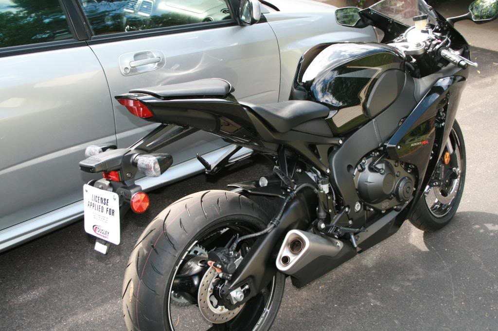

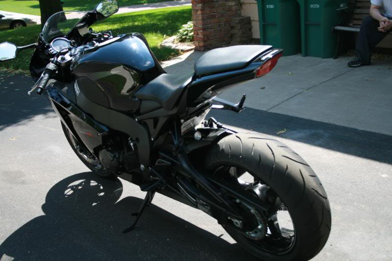

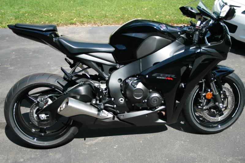

AFTER:

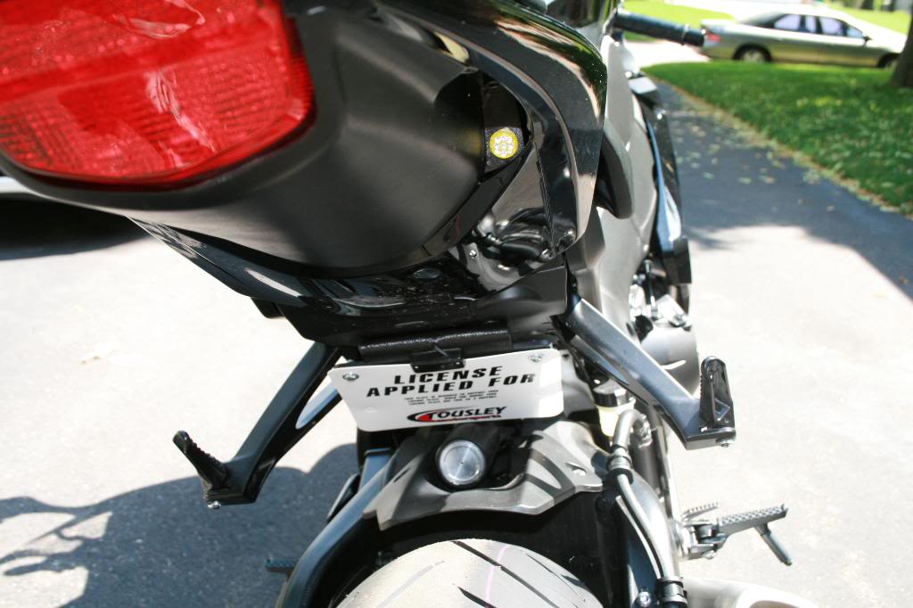

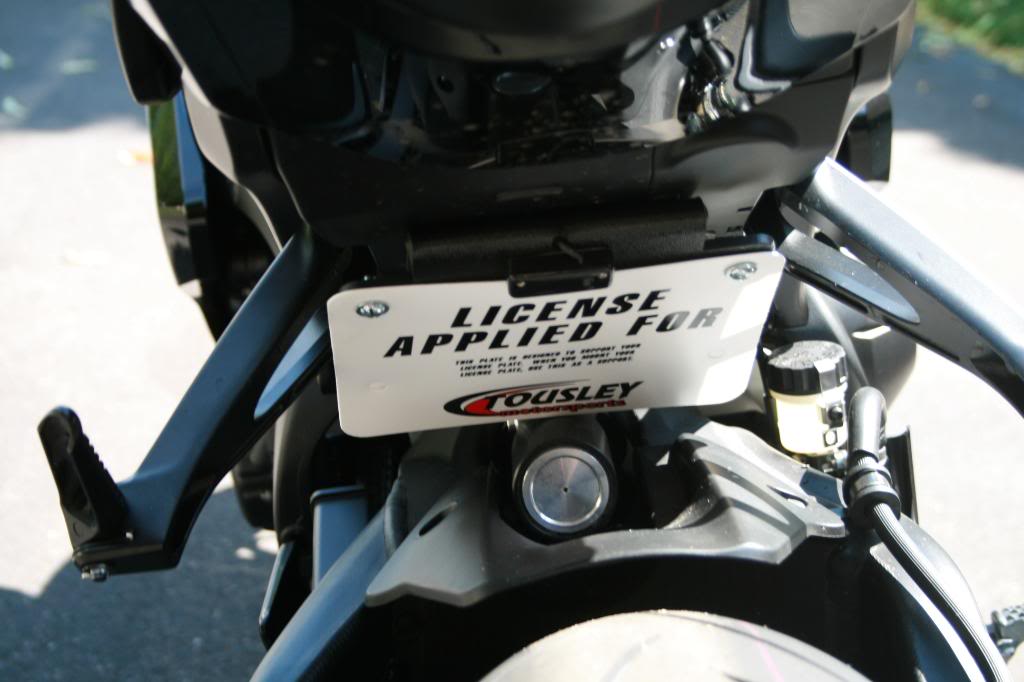

INSIDE THE STORAGE AREA. I sealed everything up with black epoxy to keep it clean and keep water out. I used plastic hollow hose covering to keep all the wires inside and neat looking. I think use electric tape to wrap it all up.
Here's some pics I tried to take in my garage of the lights and license plate light that came with the kit. It's really hard to tell in the pics but the license plate light is much brighter than it looks.
