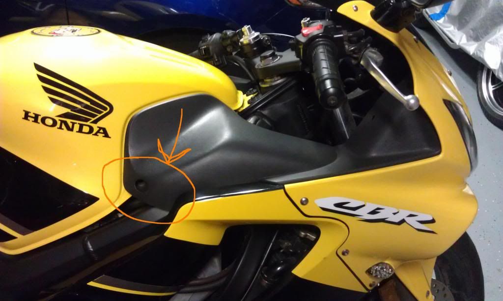

The only thing that I had a quick question about, though, was I appear to be missing a few fasteners on the front fairings... I've circled them in the pictures below. I saw the link to the specialty metric motorcycle fasteners, but that didn't seem to have this bike listed. Does anyone know where to find out what the fasteners are supposed to be, and if you know, where I could find some? (My apologies if this isn't the right place to ask, I can start a new thread in a different forum if needed).

Welcome to the Forum man... Those are lil black push pins... Im trying to find em online now... As far as the one on the right side of the tank is a normal screw... I left my F4i at home today as I put over 600 miles in last 2 days on her otherwise ide take a picture for you...
Black push pins you can snag from home depot or lows for about 50 cents... maybe a lil more

Welcome to the forum.
You could always go pick them up from a dealer. They probably have lots of them and they shouldn't cost too much.
SCREW, PAN (5X15) 90113-MCJ-000 $1.65
They are the same bolts.
If the rubber nuts are missing, you will need:
NUT (5MM) 90111-KW3-003 $3.67

What you're missing are screws, at least that's what I have. Same size as those that attach the front and side fairings. IIRC the nuts are held in place by a rubber grommet and can be pushed out of the frame if to much force applied. If all you have are holes under the cover, the grommets/nuts are gone. Good looking ride!

Thanks for all of the comments guys, and thanks for the helpful part numbers/hardware ideas! I'll try and find a dealer around here and see if they have anything.
