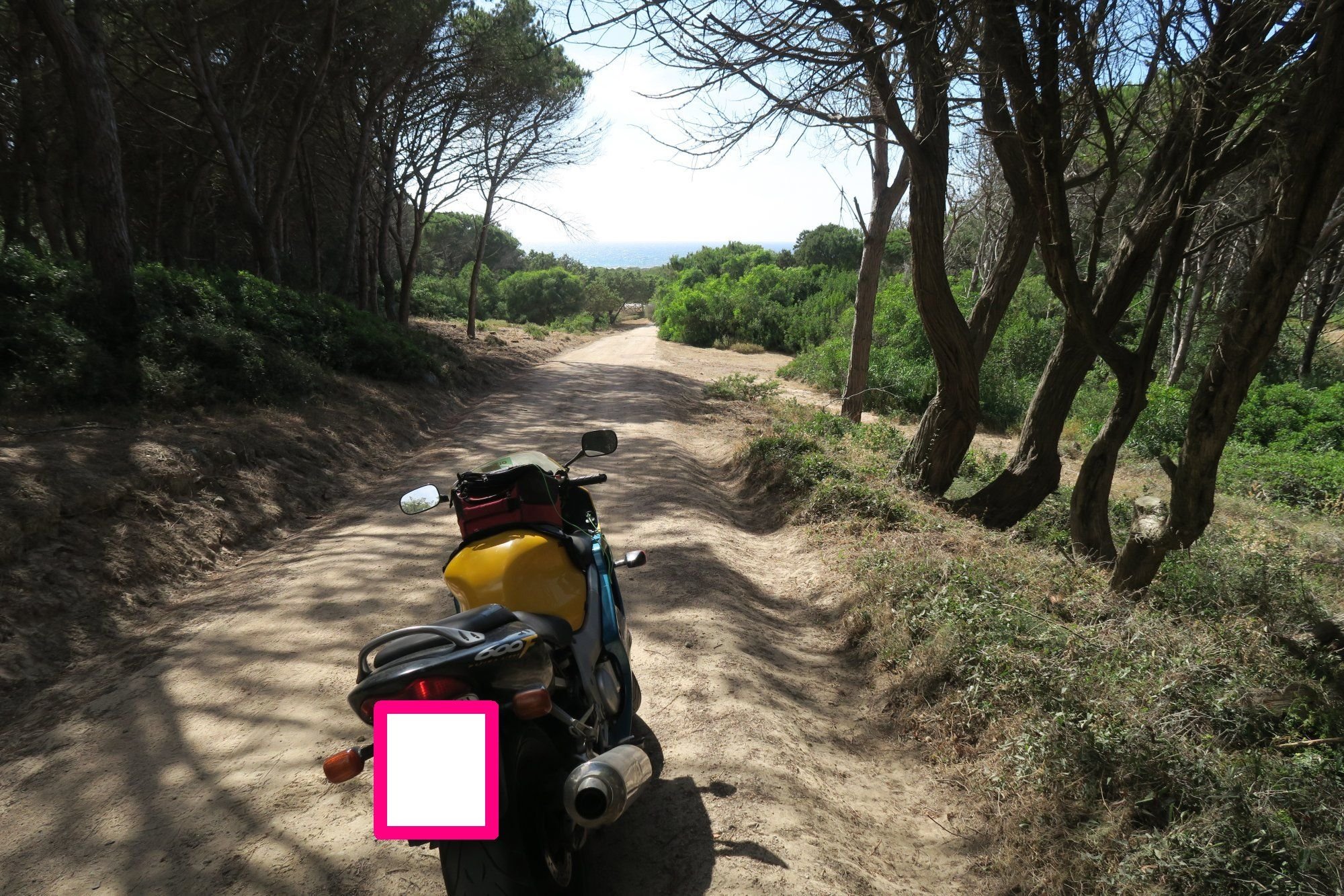

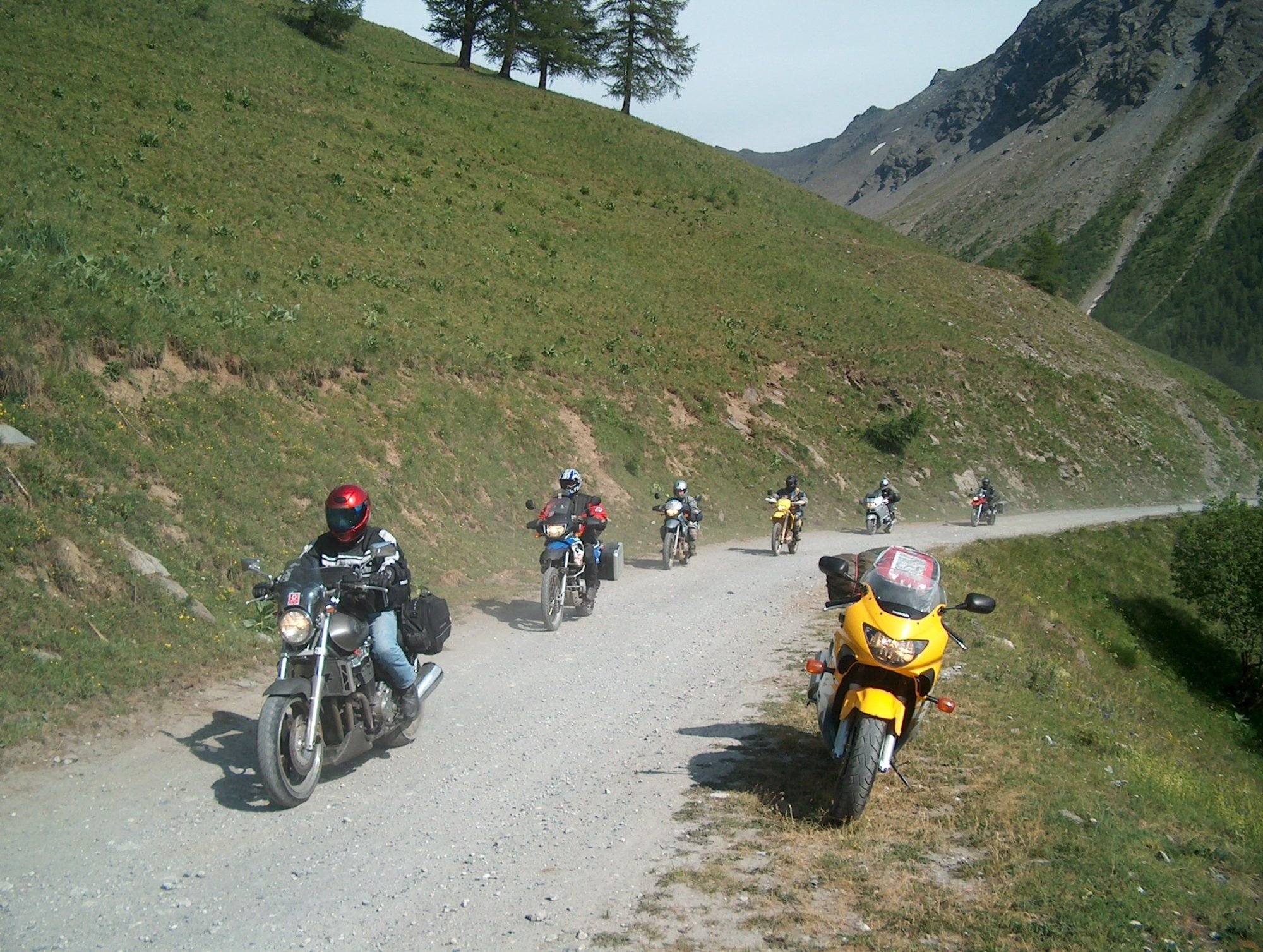

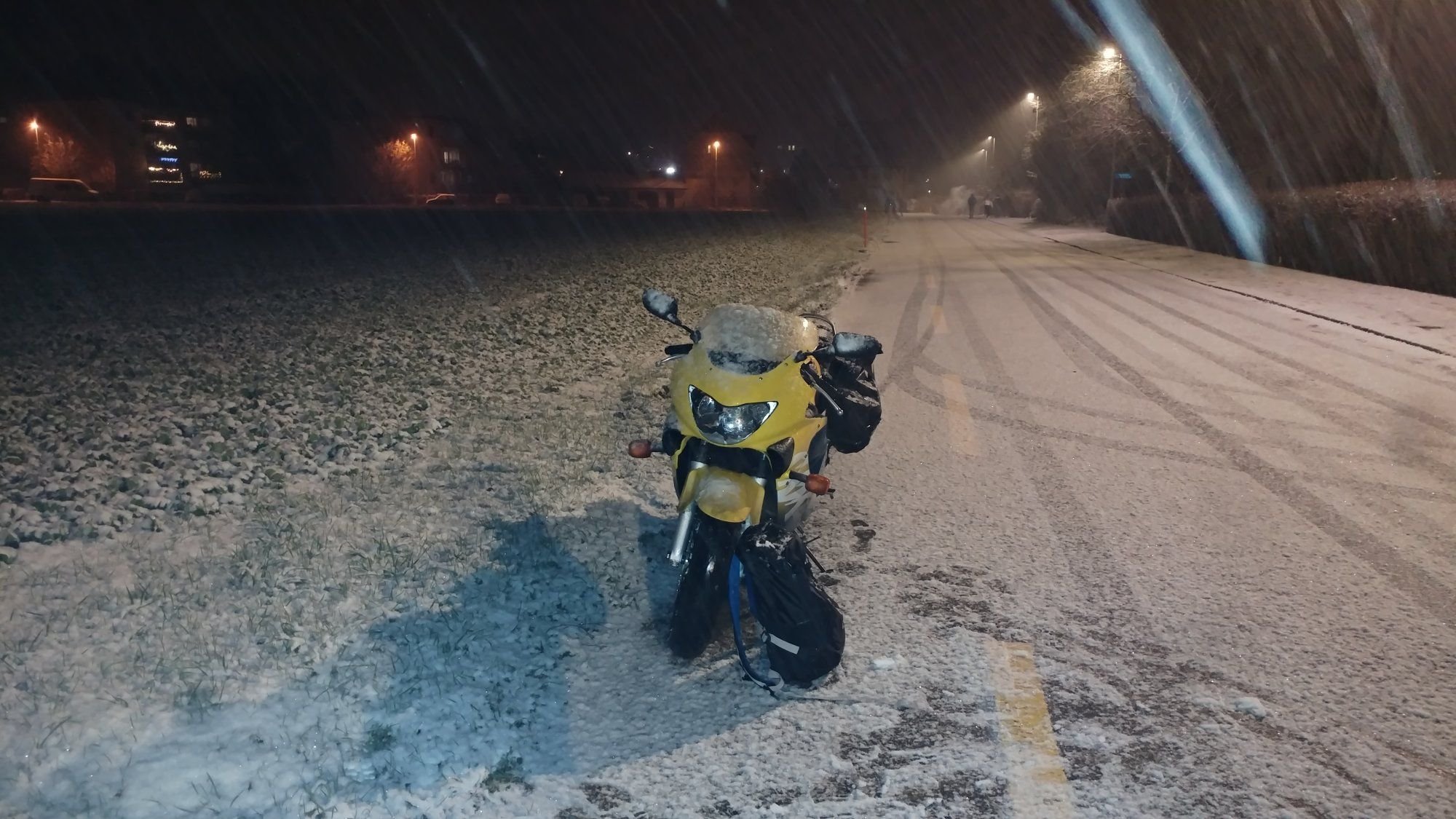

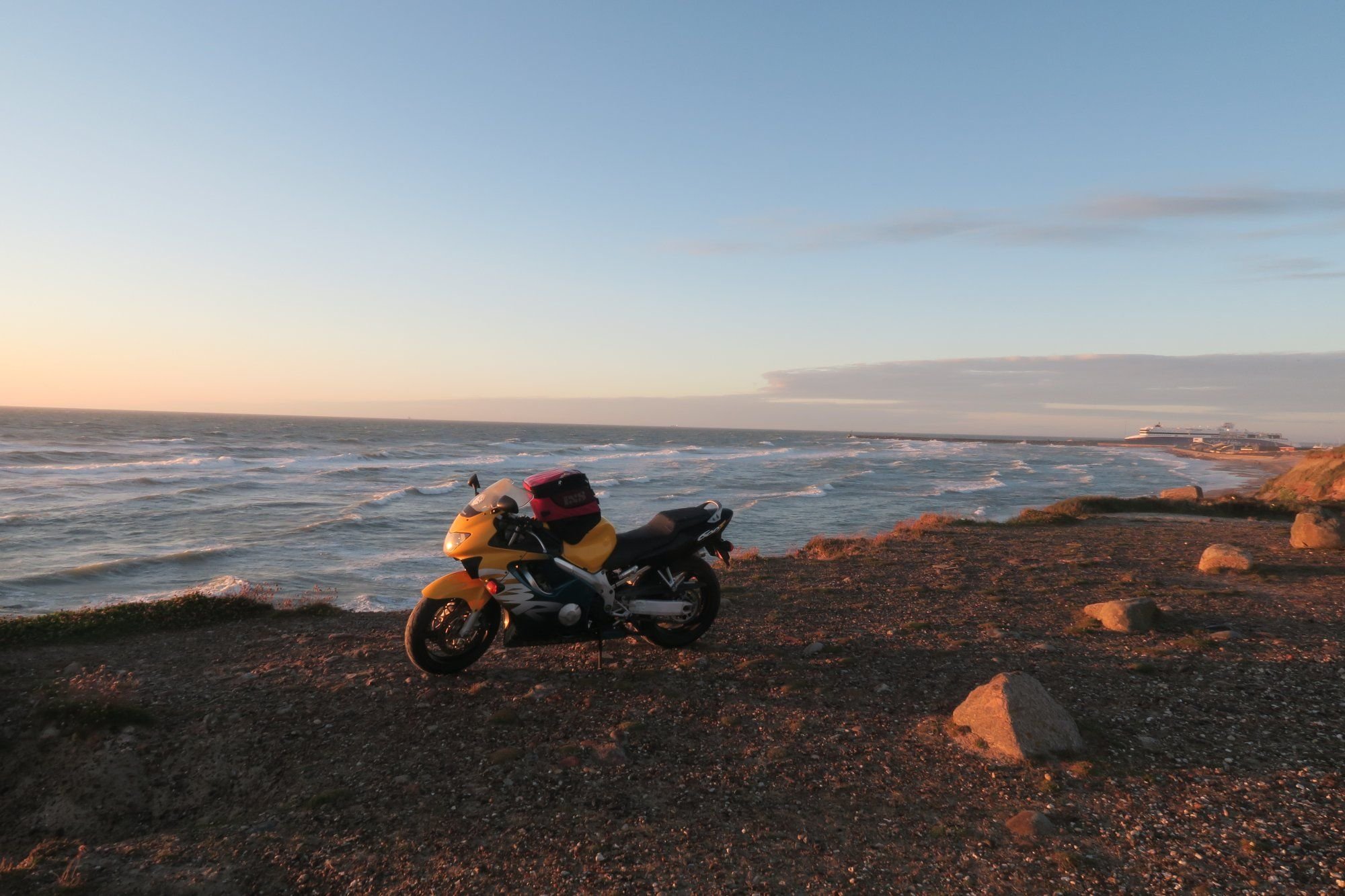

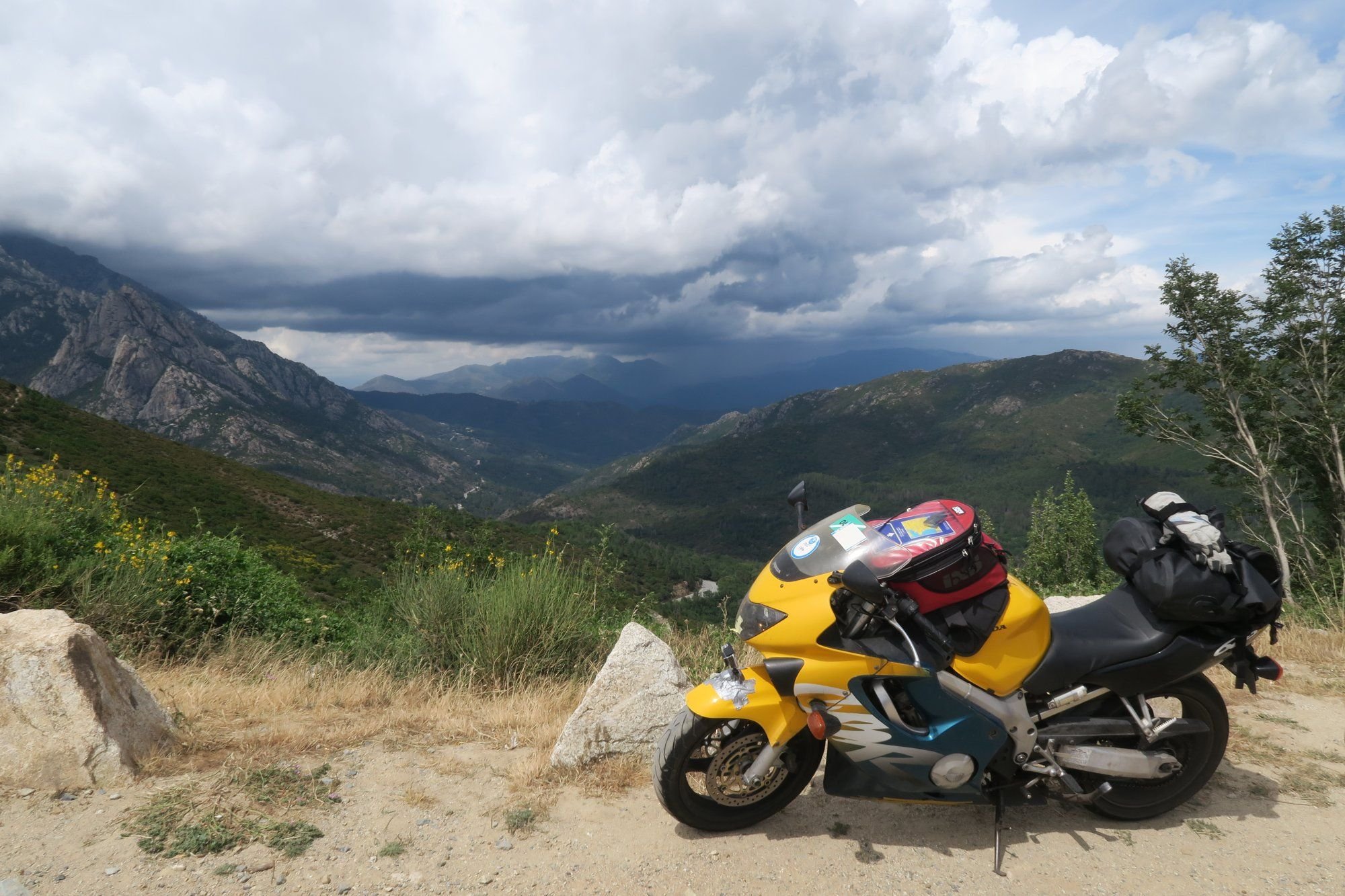

Hello!
following some photos of my bike! Is there no "insert preview" option? Sorry for inserting those huge photos!
@dannoxyz and @rockpool thank you guys for your input. I'll let you know if your suggestions solved my issue!
I ride 365/24/7 since 1999
who says the CBR is not suitable for enduro tracks?
who hasn't fixed the exhaust yet?

hahahah!!! That's awesome!
