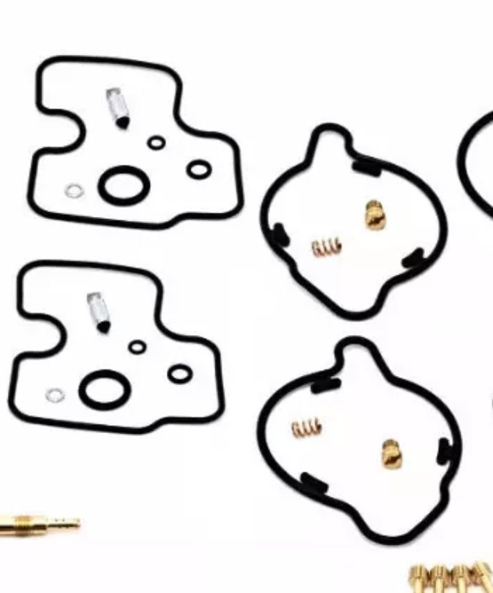

Removed carbs today. Two of the pilot jets were plugged and broke when removed from corrosion (and force) bought carb kits from parts unlimited.
anyone know where the heck the gasket on the right goes?
Old Mar 2, 2020 | 09:20 AM
Posts: 7,177
The kind of circular ones? They go on the inlet side of the carb. Check out call #2 on this link
http://www.cheapcycleparts.com/oempa...tor-components
Old Mar 3, 2020 | 11:25 AM
rc51fan's Avatar
Joined: Mar 2011
Posts: 67
Likes: 9
Oh, RIGHT! THanks!
Old Mar 3, 2020 | 12:11 PM
Posts: 7,177
You are very welcome.
