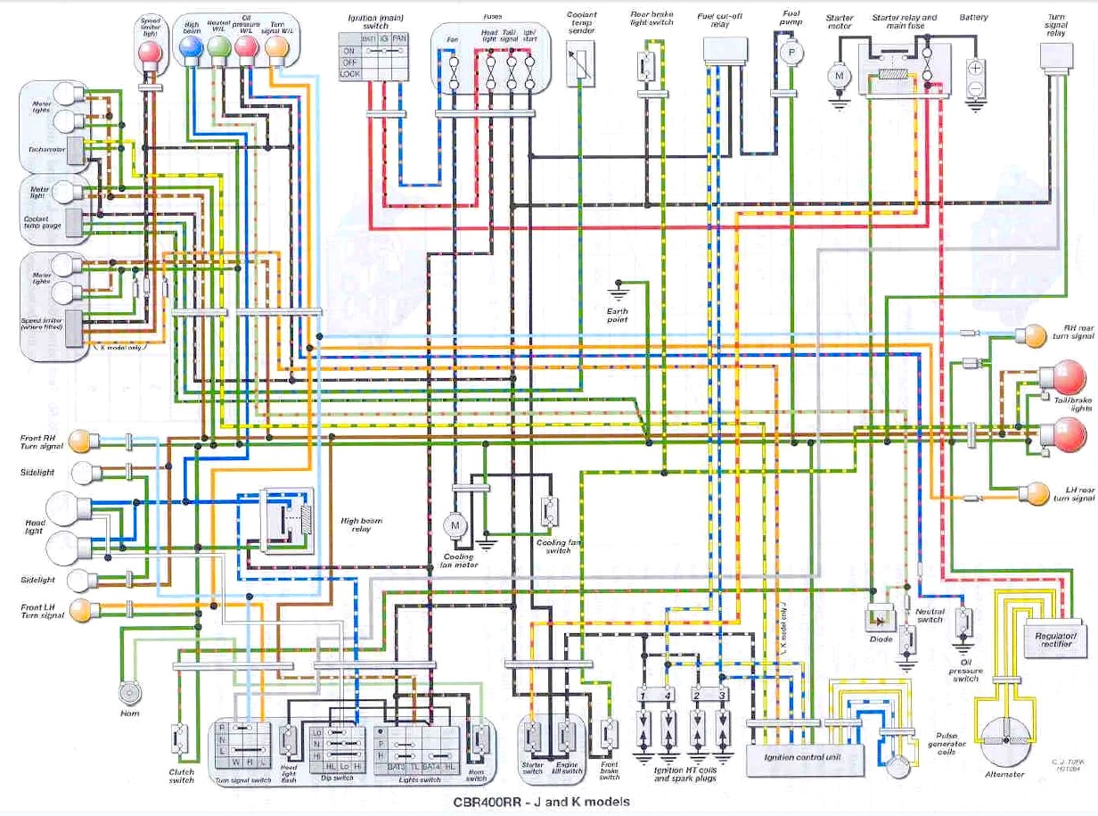

I am looking for a wiring diagram urgently please all?

will this work? good luck! nc23 has some of worst wiring harness runs I’ve ever seen. gets in way of everything!!!

Thanks so much but my harness ony has nine. Four for pickups and five on the other plug. Not 6? Any ideas?

Note org/our wire is for speed-limiter. It goes to optical pick-up on speedo. Only on K-models.
