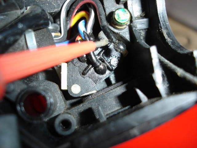

Without a wiring diagram it's hard to say. But I do know with experience that the Honda Start buttons are notorious for going bad. Their contacts get dirty inside, and often the solder joint holding the wire on will often break. I've never seen the model you're speaking about, but if it's like most, you can take it apart and either clean the contacts or re-solder the wire if it's broken. The wire broke right of it's pad. The probe is holding the wire up above the pad (silver round thing below it).
This is the inside of the start switch on a F3.
