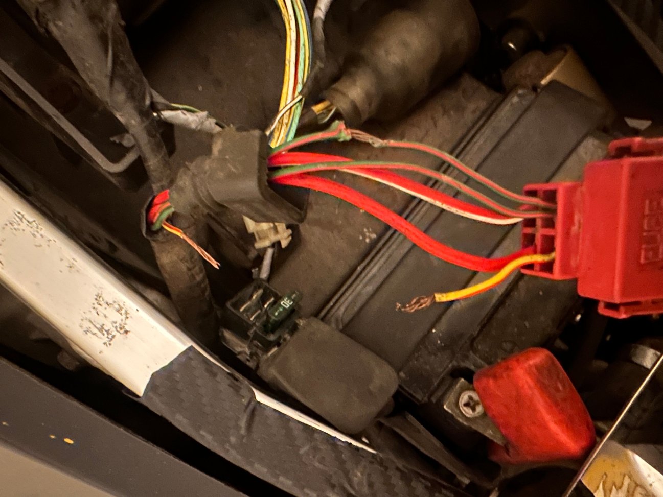

noticed red connector on starter relay looks chared so I’ve ordered one (the starter relay)
and the (is it a kill switch or break switch ) connection was bad on behind throttle/ front brake so I’ve order one of these also
Brake-lever switch isn't causing any of running problems you have. But it's safety item, so good to have new one to make sure your brake-lights always work.
Starter-solenoid is most likely fine, but the red starter-solenoid connector is common problem with Hondas. Somewhere penny-pinching bean-countre specified bare brass terminals inside that connector. Which corrodes over time, increases resistance and causes burning of entire connector.
The single red wire in that connector provides ALL power to entire bike: lights, winkers, clocks, EFI system. That's why you have no power to anything since that connector burned up. You can replace that connector with replacement pigtail:

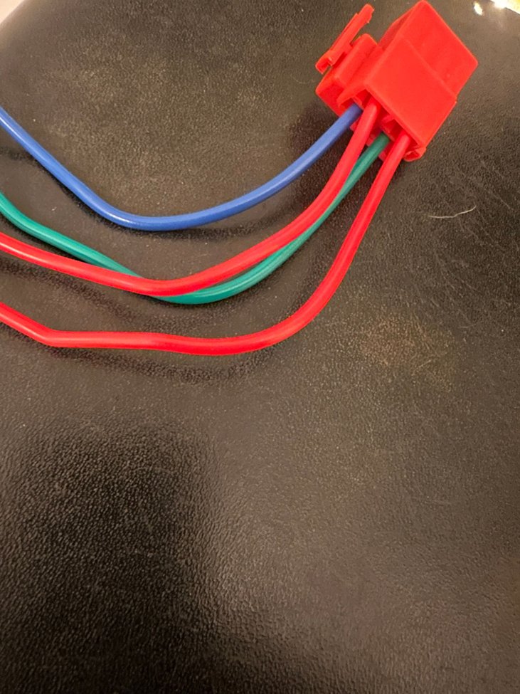

You chop off old connector and splice in new pigtail with proper western-union/linesman knot, solder and adhesive heatshrink tubing for mechanical strength, conductivity and corrosion resistance. It's done this way in pro-motorsports (F1/MotoGP), military and aerospace applications for performance, reliability and durability.
Don't need to pre-tin these bigger wires, too difficult to knot. Will end up looking like this when done; as good as continuous piece of wire. Like this stator to RR joint. That's another common area where factory bare-brass crimped terminals also corrodes and burns.
Now note how replacement pigtail has TWO red wires whereas factory connector only has one? That's handy feature because now you've TWO wires to transmit same amount of power as factory's one wire. Join those two red wires together and connect to single factory wire like this. This will lower heat through connector and ward off burning.

Sorry, I had posted wiring of VFR. Here's one for '96-97 CBR919RR.
First, make sure colours on replacement pig-tail matches what you have now.
Second, line up wires in same position of connector with wires on harness.
- one red on pigtail goes to red on harness - power-output
- other red on pigtail goes to red/wht on harness - power-output
- grn to 2x grn/red on harness - earth/ground
- blue to yel/red - start-button power
