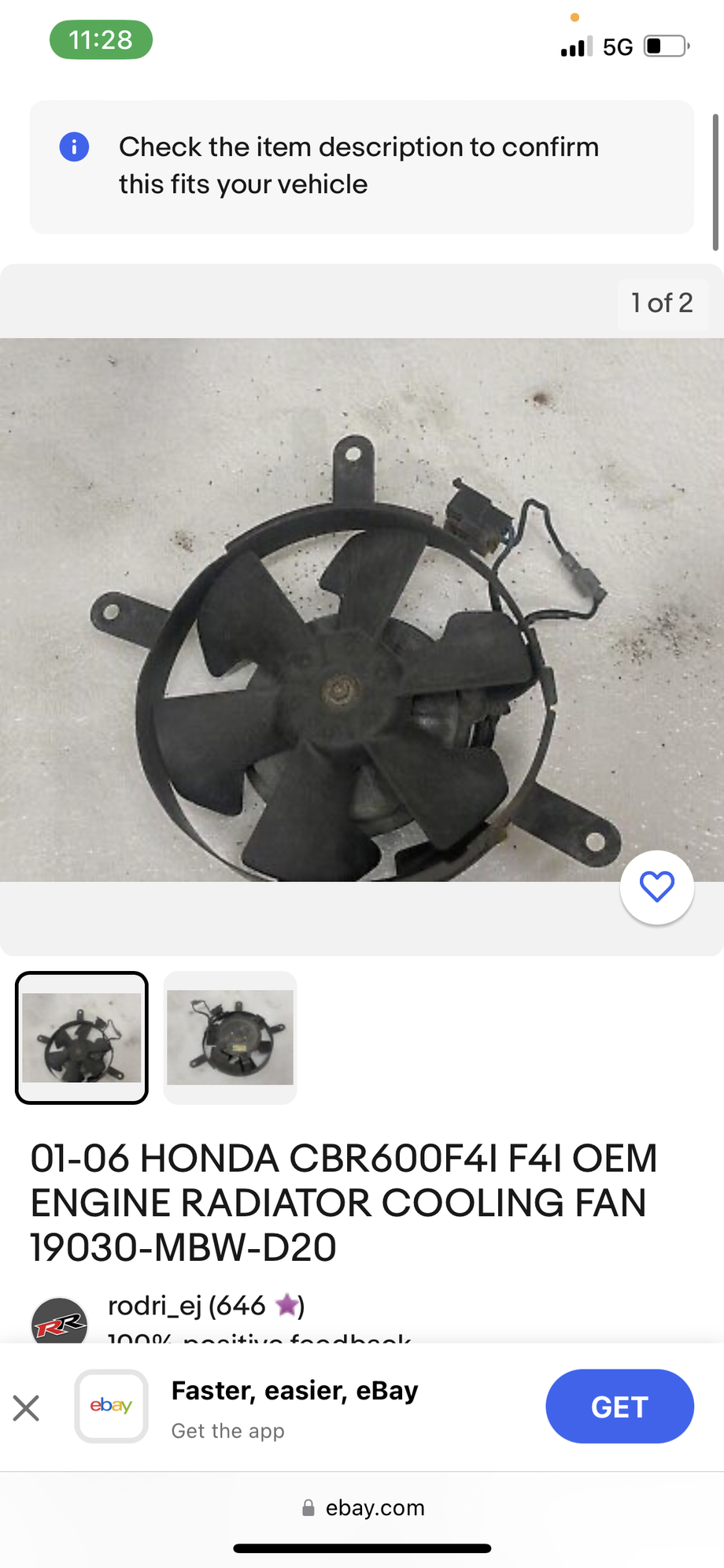

Not sure about shroud I can send pic looks like 5 blades with big circle around them all the faves I seen online were same didn’t see different version. Maybe to much hear from exhaust right by fan

Looks like this.

Is fan in front or behind radiator?

It’s sitting in between radiator and engine only one way to
bolt to it to appears

Hey it’s the stock fan I believe it’s 5 or 6 blade and seems to be blowing toward the radiator can feel it pretty good from other side through radiator. Coming out. And outside temp usually 90s. But 80s in morning when been using bike to gym quick trips.
it's blowing backwards, no wonder it's not cooling. When bike's moving, air-flow is though radiator towards back of bike. When fan turns on, it blows air forwards against air-flow and nothing moves through radiator! Have to figure out why fan's blowing in wrong direction and fix it....

check this out tommotow I may just be little off on what I may have thought is the problem but yes I’ll double check. So let’s say fan is blowing the right way and I miss called that one. What next ?

Not the first time I have heard about the fan being wired the wrong way
