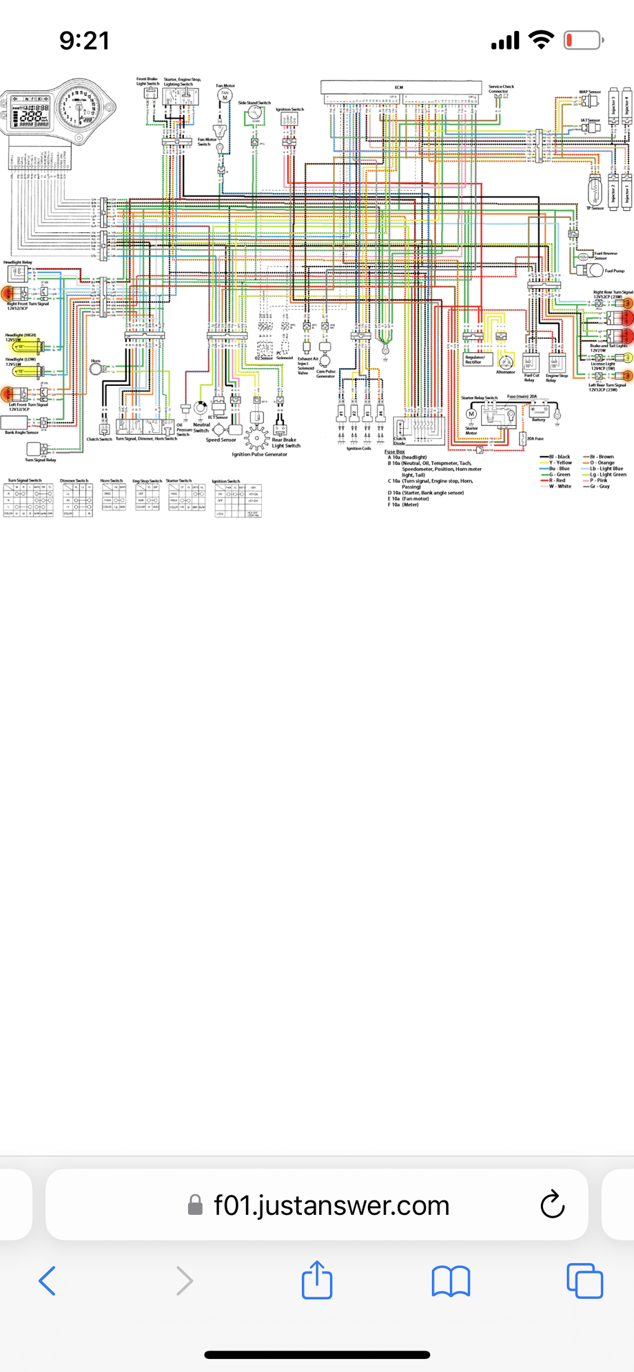

hey so I looked on my laptop. You have option to use a magnifying glass even printed it out. Is the 02 sensor staring at me in the face ? Is there anyways you can locate this for me on the diagram. I’ll trace the wires and everything but no where on there is it showing an 02

Think I found it. Says 02 now to make sense of the wiring from it to the ecm

Here the whole thing can you make sense of which wires go to ecm?

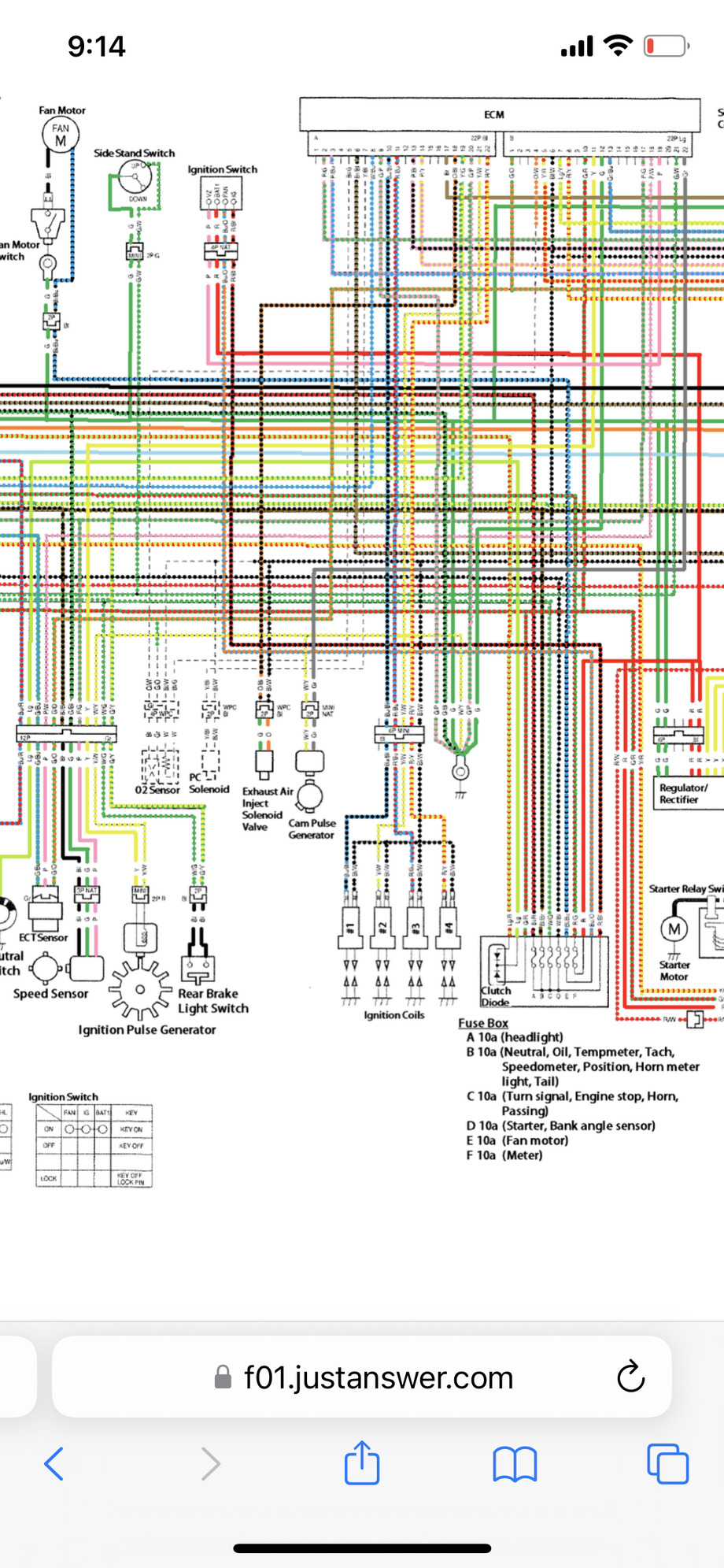

Diagram

Looks like only one wire goes to ecm pin 5 right hand side ecm. Other ones seems to go into solid dots all three. ?

Ok so I believe if im correct. And read this correct only two wires go to ecm and direct to it. Other two branch off into the fuel pump relay and something else. So pin 5 on the left side. Black connector and pin 4 right side gray connector. And looking at my ecm tonight both pins on each side is missing. They’re nothing there. So I believe my theory was correct this was swapped with a California ecm and my bike never came with 02
sensor. So if can back up my hunch on these pins I’ll pin it together with wire and a resistor

Not sure of those pins. That diagram is horrible! Download this manual here on your laptop and print out diagram on sheet of paper. There's absolutely zero way to trace wiring accurately on phone screen, unless you're able to draw on diagram, but that one is way, way too messy.
It's like what they say in maths class, "show your work". Let's see your "map", that is, the path you took from O2-sensor towards ECU connector. Let's be absolutely 100% positively sure about these pins, or else you're gonna fry ECU!!
