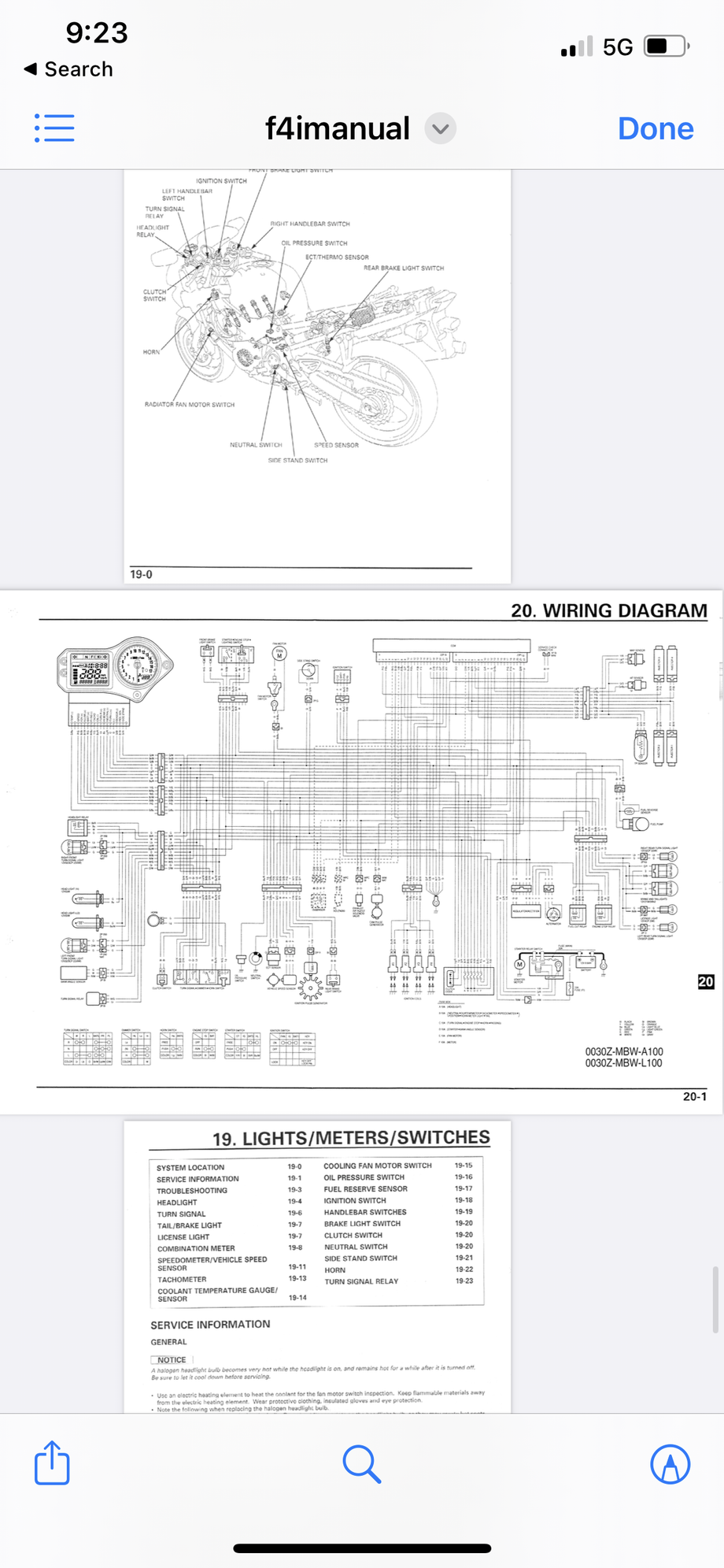

so no there is no 02 sensor on bike now. Someone had put a slip on after marker with no bung hole or 02 sensor. So I basically took bike apart looking for this connecter. And it’s no where to be found. The manual
i have is not the one that came with bike. I never got one but I found one on google And it’s not much help. So my idea is if anybody knows where the 02 sensor plugs into the ecu I can just ohm resistor trick there instead of the usual pigtail. My bike is throwing the f1 light for the 02
ssnsor and it’s the only code thrown. So
inassume in the bikes history someone may have swaped Ecu for a California model. So where is the pins on the ecu for this 02 sensor

Does manual you found through Google have wiring diagram? It's usually near the end
With diagram, we can trace wiring from O2-sensor plug and figure where it connects to ECU

It’s not clear enough to really make out
Old Apr 9, 2023 | 11:19 PM
Rays01cbrf4i's Avatar
Joined: Apr 2023
Posts: 39
From: Merced ca
I can send you what I found maybe can make more sense of it. Just googled my bike manual and it came up Like 456 page book give or take and it has the diagrams just way to small and can’t read the words etc.

Old Apr 10, 2023 | 06:01 PM

that looks like correct manual. viewing online sucks, you have to download entire PDF to local system and open downloaded file.
I did Google search for "CBR600F4i" "service manual" download and found this. Just click on Download button and save it. Might need PDF-viewer app.

. I am going to try to download it to my laptop but I’m still not the very best at making sense of these charts. By any chance did you have any luck seeing it ? Do you happen to have an idea of the pin out where they connect ? I’ll give it a shot on my end thoigh and update

Haven't looked at diagram, so can't say exactly. Don't try to figure out ENTIRE wiring diagram, just O2-sensor. Like looking at road-map, you don't need to digest every single road on map. Just look at where you are and trace path to where to want to go. So process goes something like this:
1. print out wiring-diagram full-size on sheet of paper
2. pull out highlighting markers
3. find O2-sensor
4. locate 4 wires coming out of sensor
5. identify 2 wires for sensor heater, it should have symbol similar to resistor
6. using highlighter (different colour for each wire), trace 2 heater wires back to ECU connector
7. connect proper value resistor to those pins on ECU connector to simulate O2-sensor
Here's one where I helped someone track down wiring for horn. Turned out wire was disconnected
