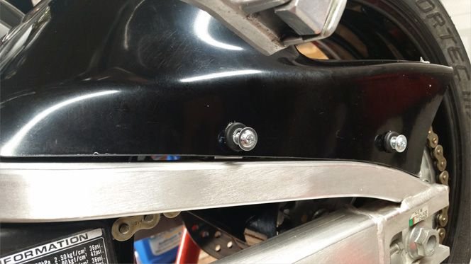

With the bolts loosely fastened on the left side, the bottom of the fender sits about 5/32" above the upper swing arm.
Left side
While the right side must be lifted so it is at least an inch above the upper swing arm to clear the tire.

Left side
