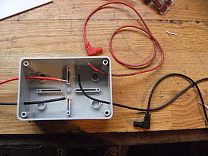

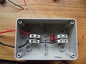

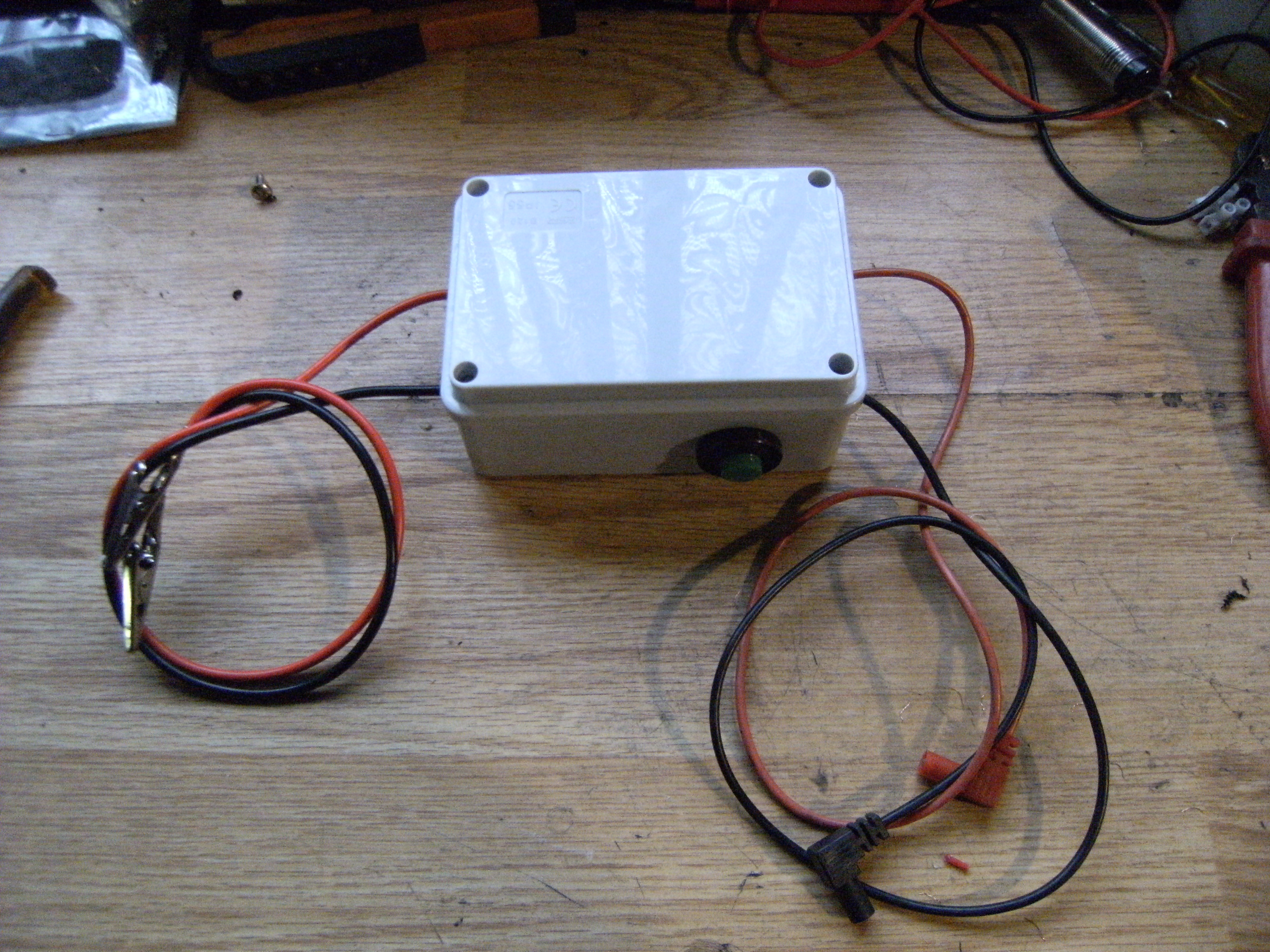

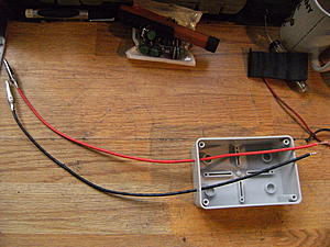

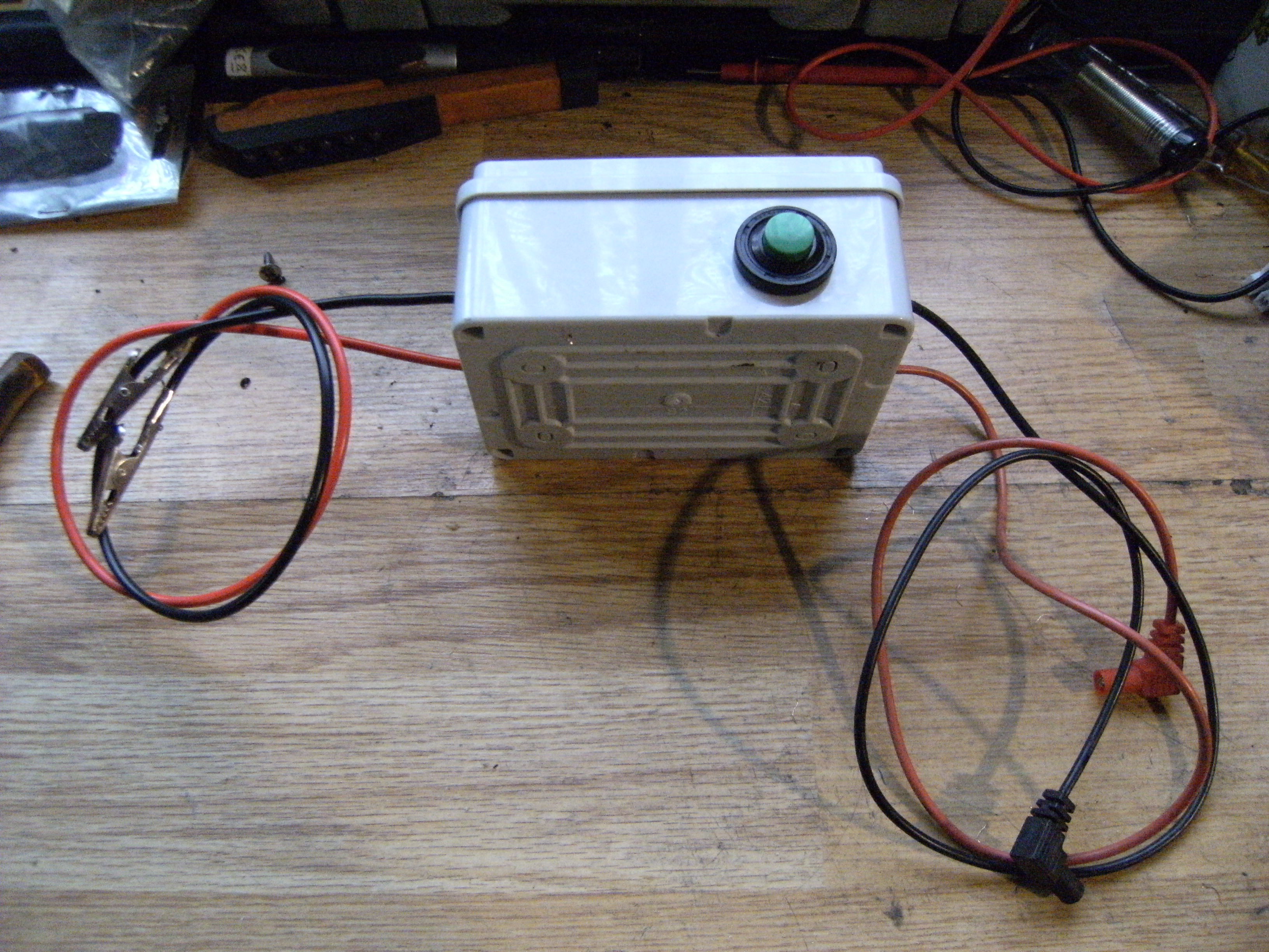

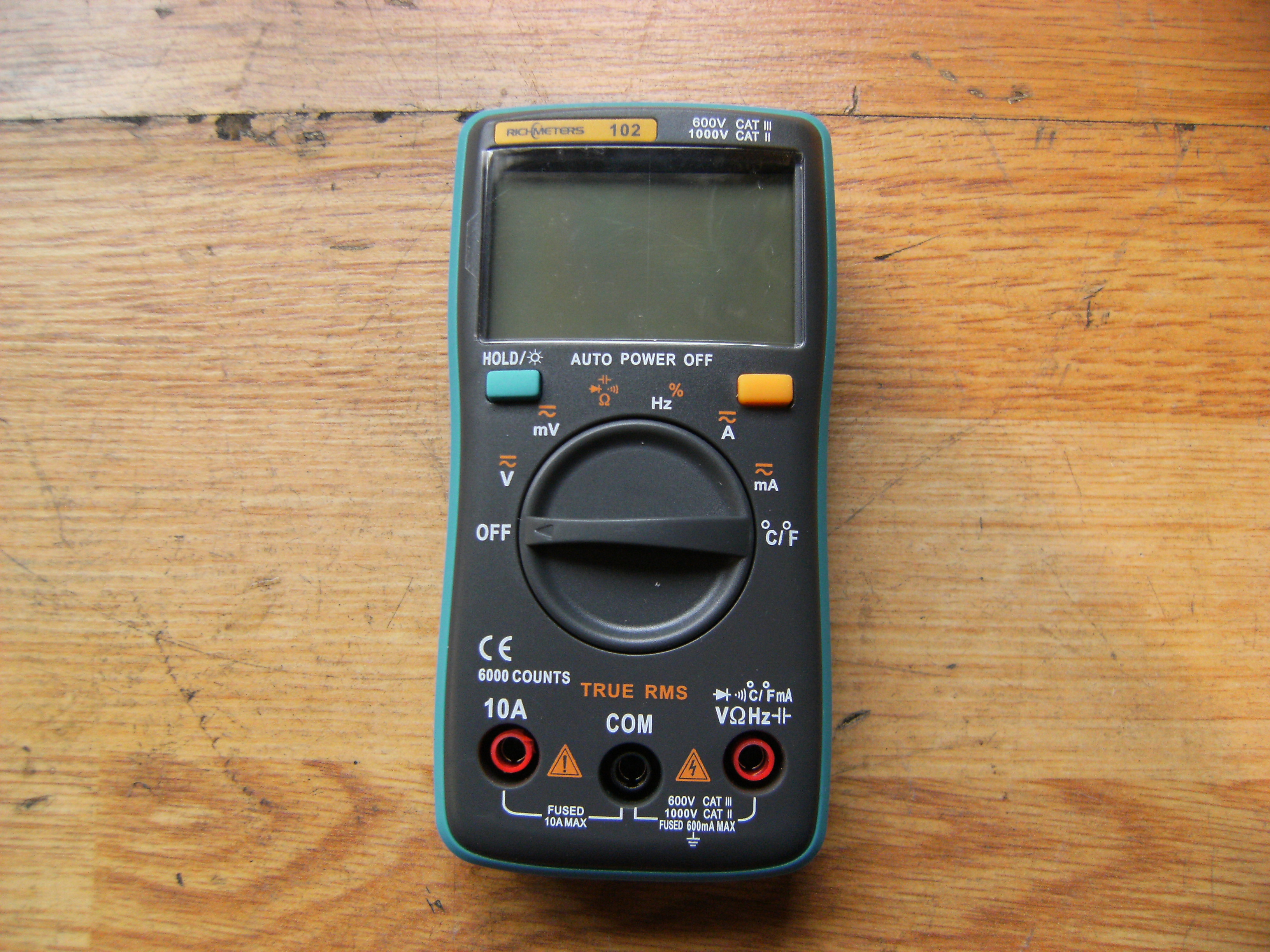

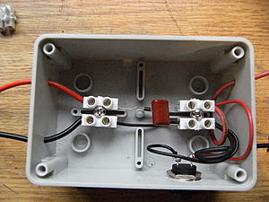

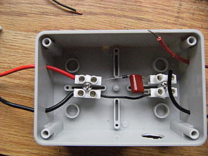

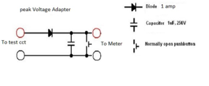

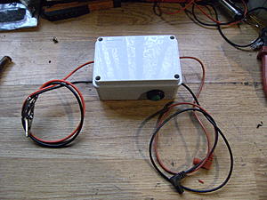

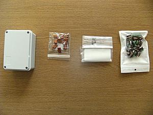

Keep seeing every now and then the need for a PVA, so putting this up of one I made, also on other sites , with thanks to Metalv from the Honda ATV Forum, parts were so cheap, but needed a Multi Meter with 60Mohms impedance, £11 for that but all the rest just cost £7 for 10 resistors ,10 capacitors and 10 switches (only need one of each for this)Button is there to discharge any power left in the capacitor (save you getting a shock)
Attached Thumbnails Peak Voltage Adaptor-pvm-1.png   Peak Voltage Adaptor-pvm-2.jpg   Peak Voltage Adaptor-pvm-3.jpg   Peak Voltage Adaptor-pvm-4.jpg   Peak Voltage Adaptor-pvm-5.jpg
Peak Voltage Adaptor-pvm-6.jpg   Peak Voltage Adaptor-pvm-7.jpg   Peak Voltage Adaptor-pvm-8.jpg   Peak Voltage Adaptor-pvm-9.jpg   Peak Voltage Adaptor-pvm-10.jpg
Old Dec 12, 2017 | 06:55 AM
Posts: 7,177
Verh nice, clean job. All you need is your CaBaRet logo on them and you can sell them.
I realy do like the discharge button.

Yeh , how many times will I miss that and give myself a shock
