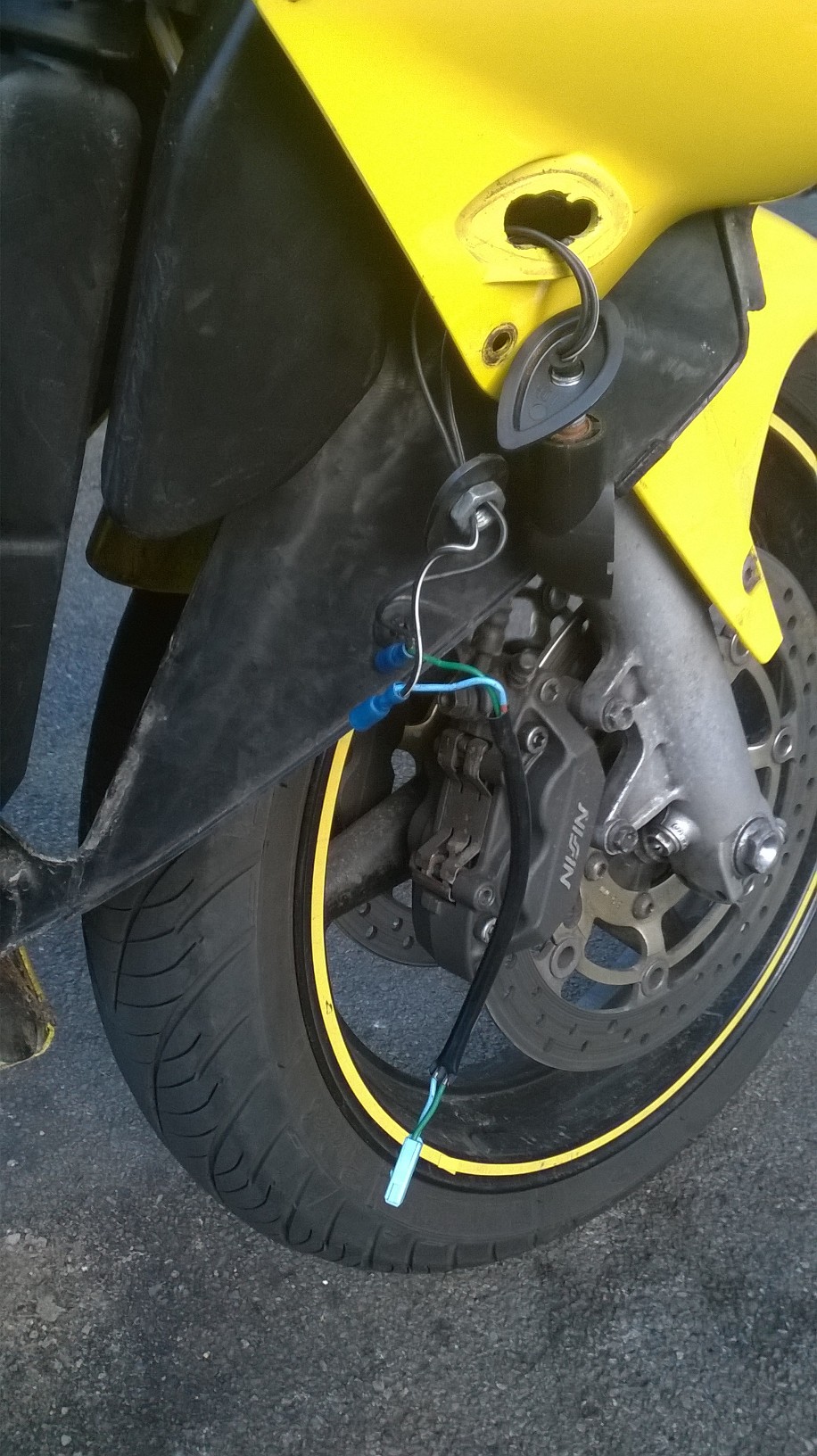

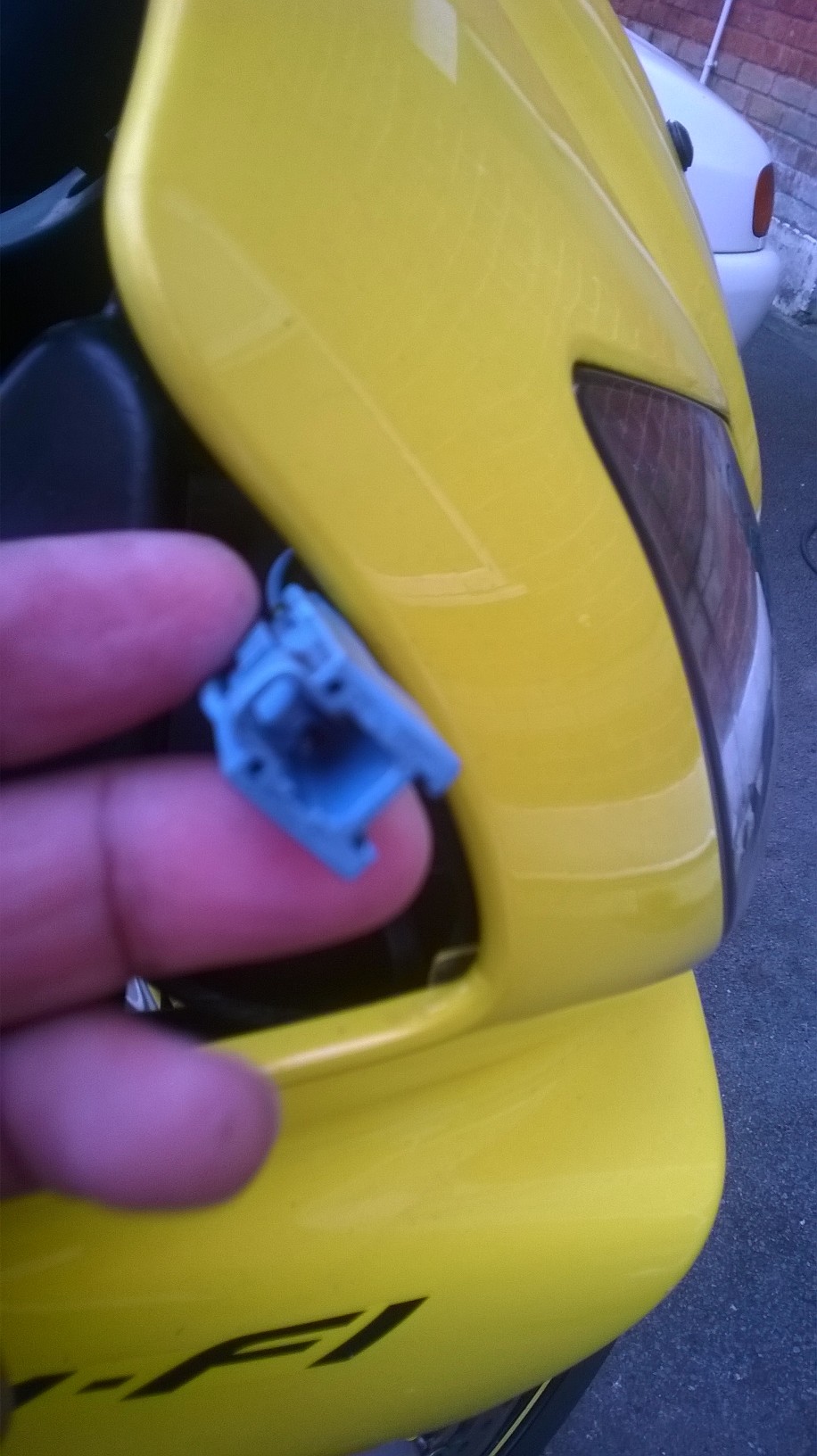

I checked the circuit dia in my Haynes manual and think the 2002 uk models come with a 2 pin signal flasher as only 2 connection go into it in the dia whereas older models have 3.
So ordered 2 pin flasher,4 el cheapo led indicators for I think £7, wiring adaptors etc but still confused as to how the original wiring worked. Can someone have a look and tell me if this can be reused?
The original wiring went into just one connector , the blue one
