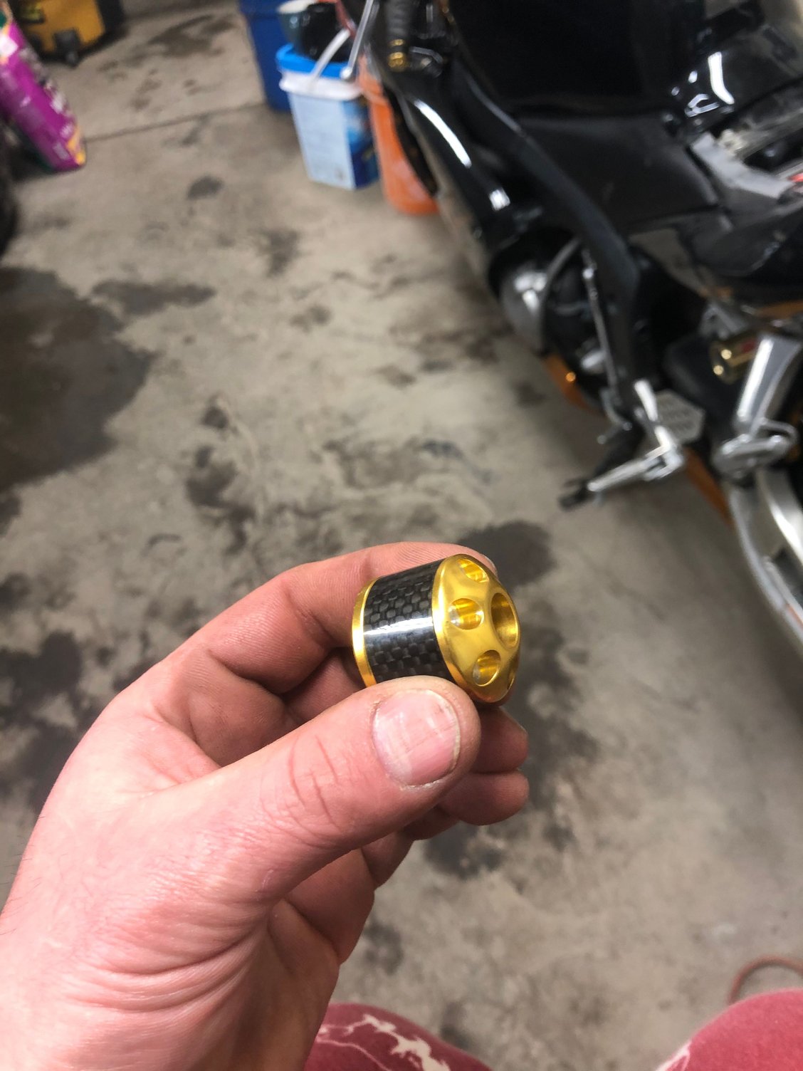

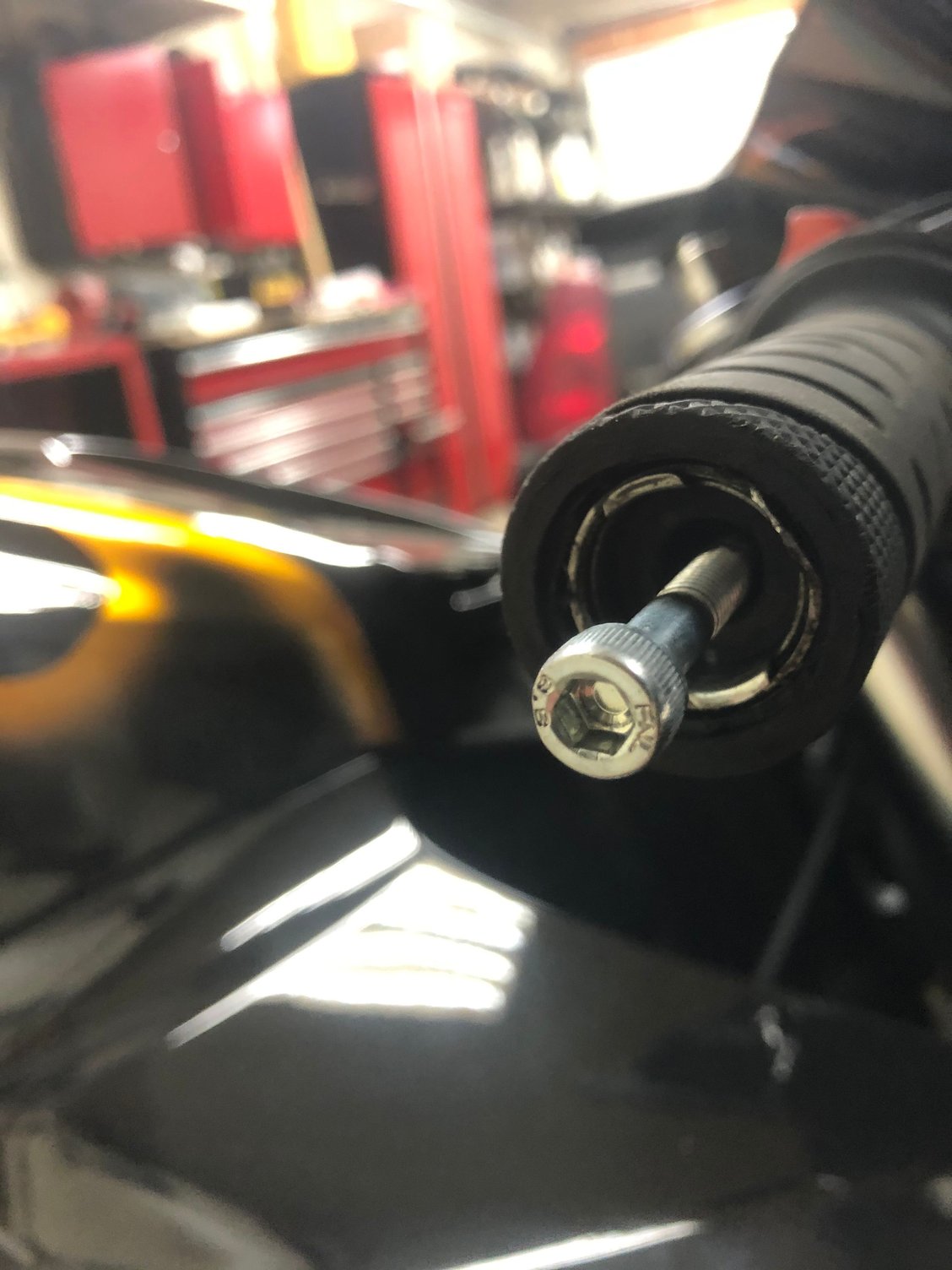

Paul Gozdawa-Boczkowski's Avatar
Joined: Feb 2021
Thank you for the compliment 😊
Here is the piece that was loose and the handle bar.. with the bolt stuck in it.
Old Feb 21, 2021 | 11:56 PM
It doesn't look like a Throttlemeister. I think this will help you. This is the same on most Honda's.
Old Feb 22, 2021 | 04:54 AM
Posts: 2,573
It could be that the retaining clip has been damaged as per the video which would cause the bar end to spin when trying to fully tighten it up.
Old Feb 22, 2021 | 10:14 AM
Joined: Feb 2021
this helps a lot. Thank you!
