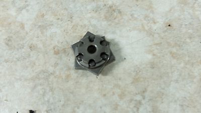

Hi, I'm currently reassembling a 96 cbr 600 f3 engine and I need help making sure I have the gear drum and forks installed correctly. Here is a pic in neutral.How can I tell if it right or not?

I have a Haynes manual. When I bolted the shift star to the drum bearing it has a dowl pin that's suppose to line up with a hole on the back of the star. I tried lining them up and bolted it on. I'm just not sure if the dowl pin is in the right hole because their is more then on hole on the back of the star. How do I know if it's right? Look at the pic. It will show the back of the star where all the holes are. The dowl pin is suppose to go in one of them. But with multiple holes the dowl pin could go in any one of them.

I don't know your particular bike, but in similar Honda engines the dowel should correspond to the point that is different from the others (ie the one that looks like it's been cut out)
Before sealing the cases make sure to test-fit and ensure that it shifts fine by hand. You might need to wiggle some parts with your fingers or rotate the engine slightly to get the various gears to line up, but it's the best way to make sure

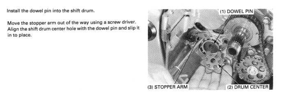

This is the excerpt from the service manual
Hope that helps.
