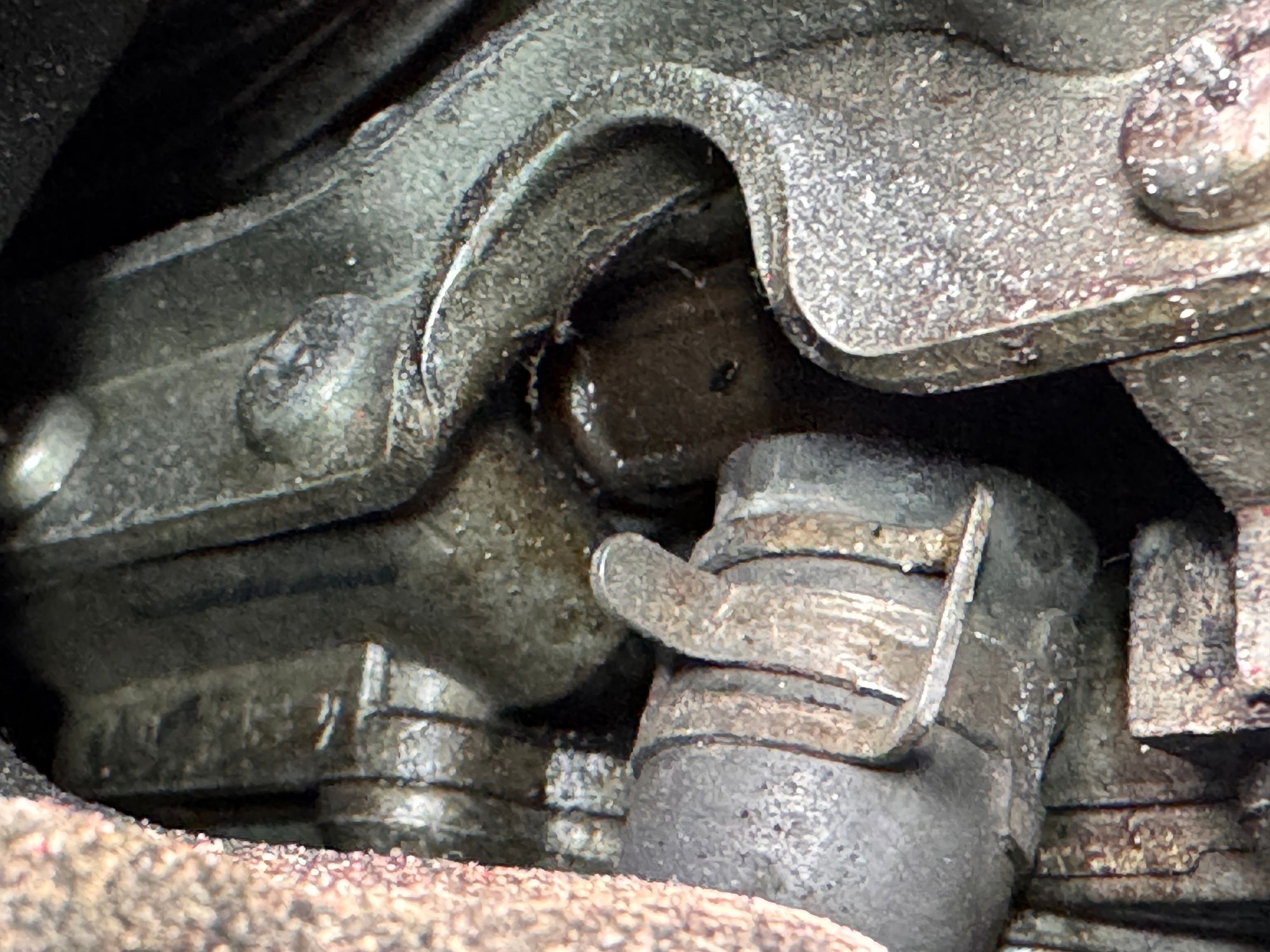

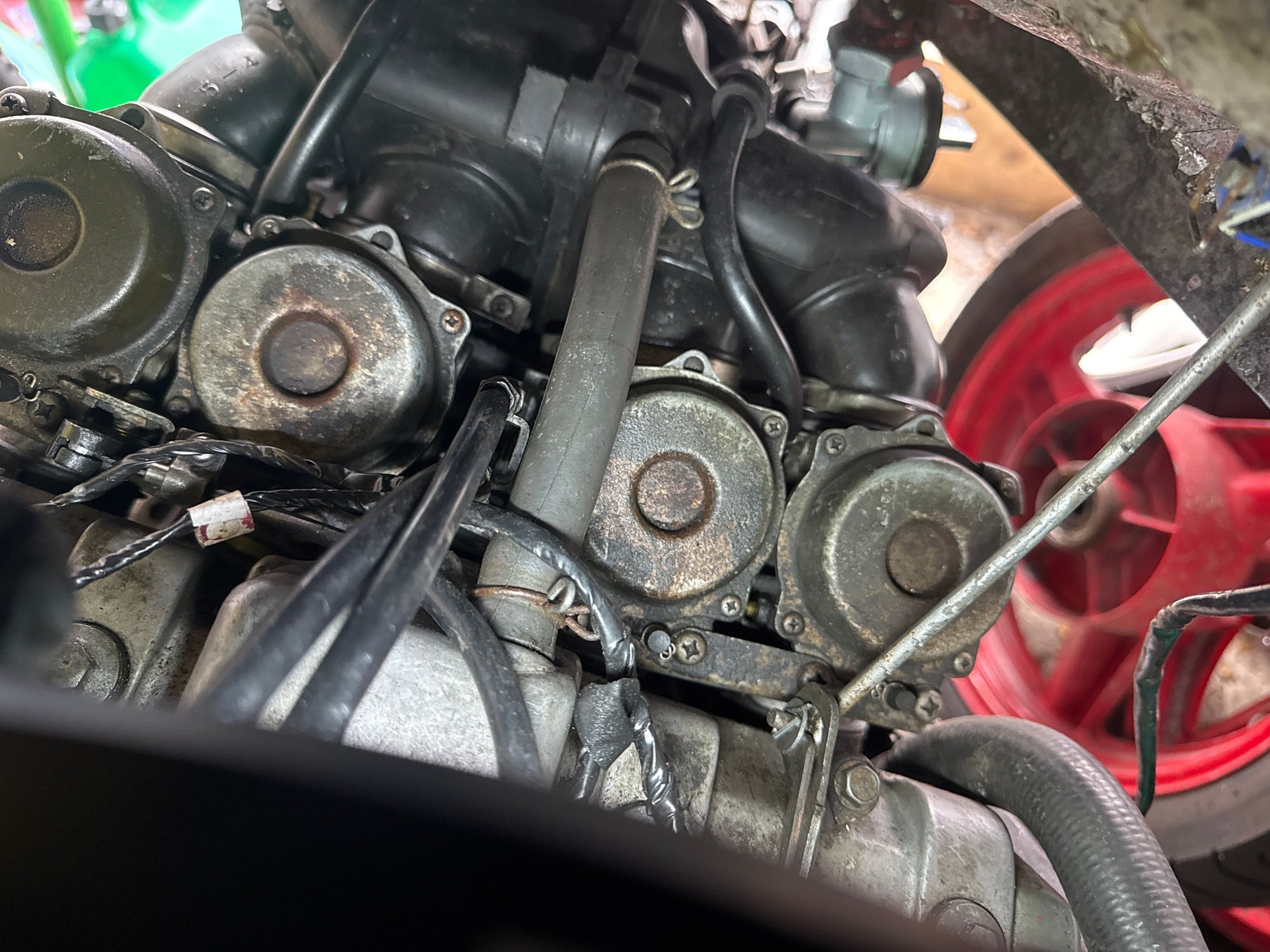

interestingly, just opened her up a bit, on top of the carbs is seemingly dry as anything I’m stumped

Old Feb 27, 2026 | 10:57 AM
CBR1000 New's Avatar
Joined: Feb 2026
Posts: 9
Also, now the tank is off and there isn’t a way to run the engine to see the leak, how can I know for certain where it’s from? Worth taking carbs out of is that overkill for this stage

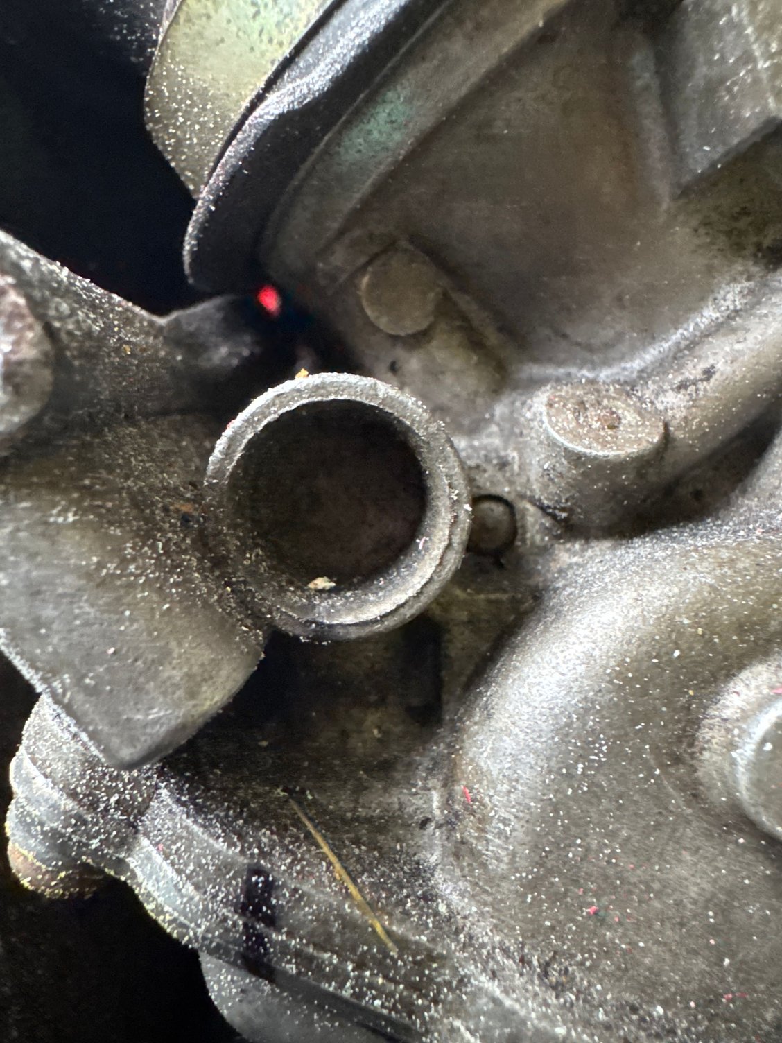

Old Feb 27, 2026 | 11:18 AM
Joined: Feb 2026
Posts: 9
This looks a little wet? What is it? Does anyone know
