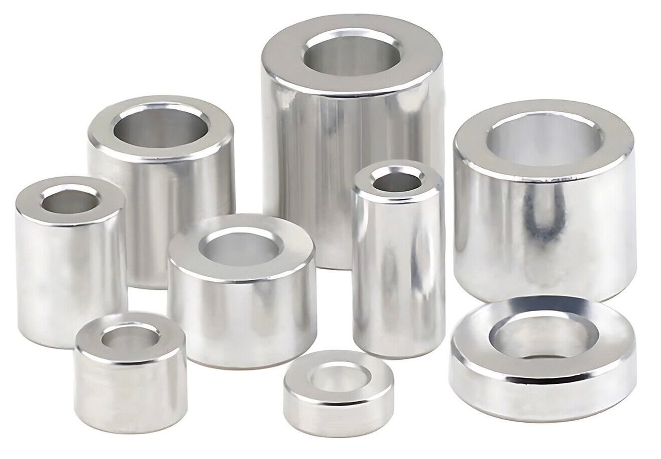

You can remove expander from lever guard. Then add spacer between factory nut inside bar out to lever guard. Similar to stub of bar-end weight that fits into bar. Much more secure mounting than expander wedge.

Thanks for this idea! Did a version of it this evening and kept the original bar weights inside the bar. worked well.
