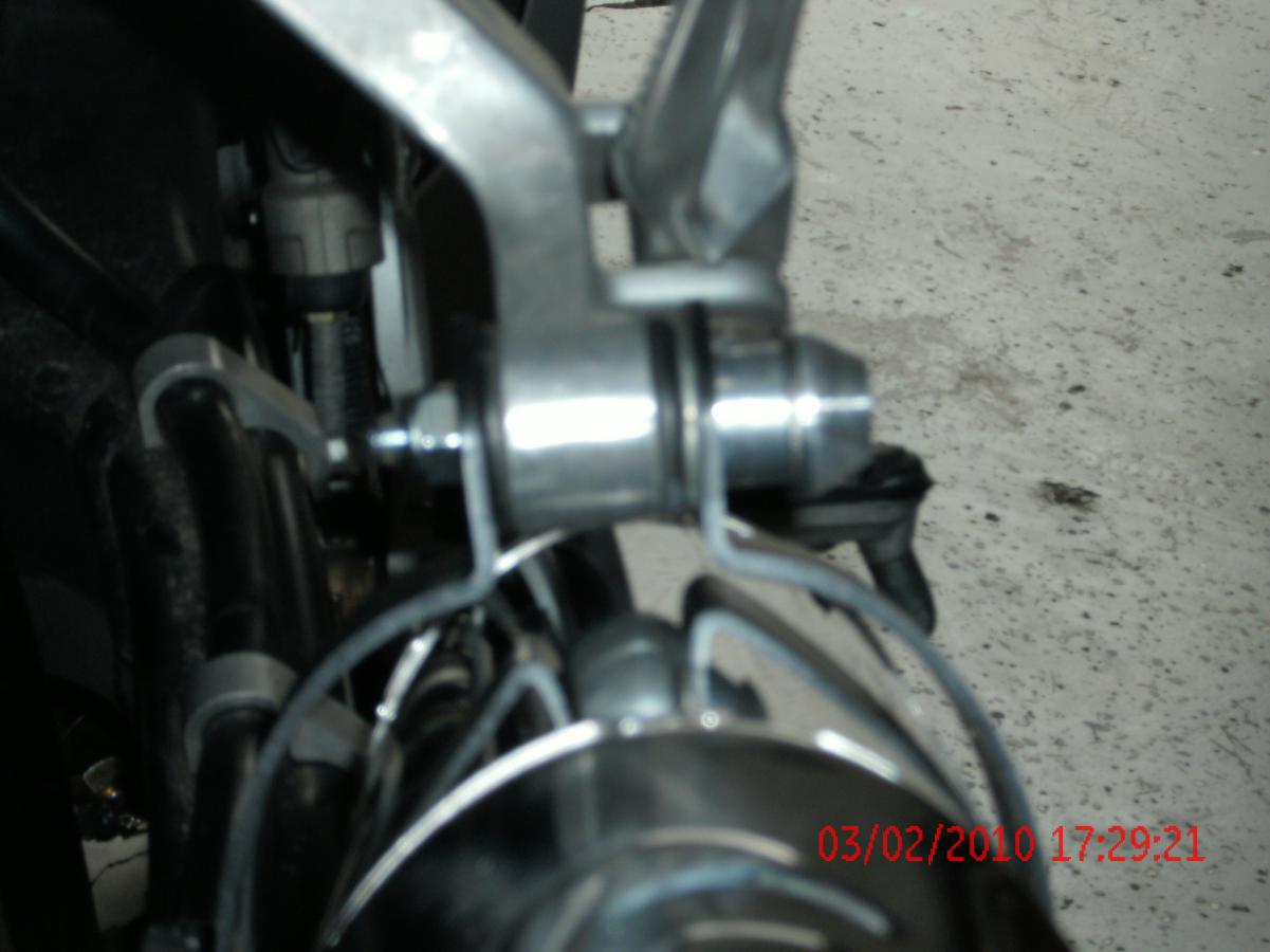

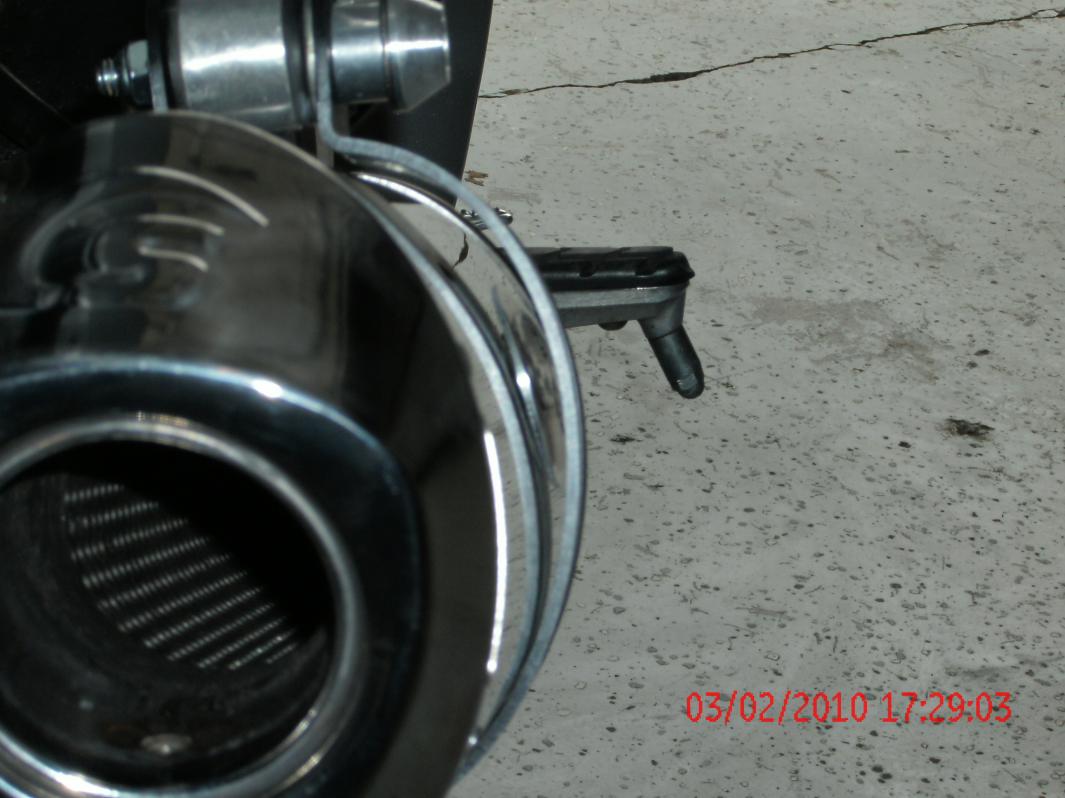

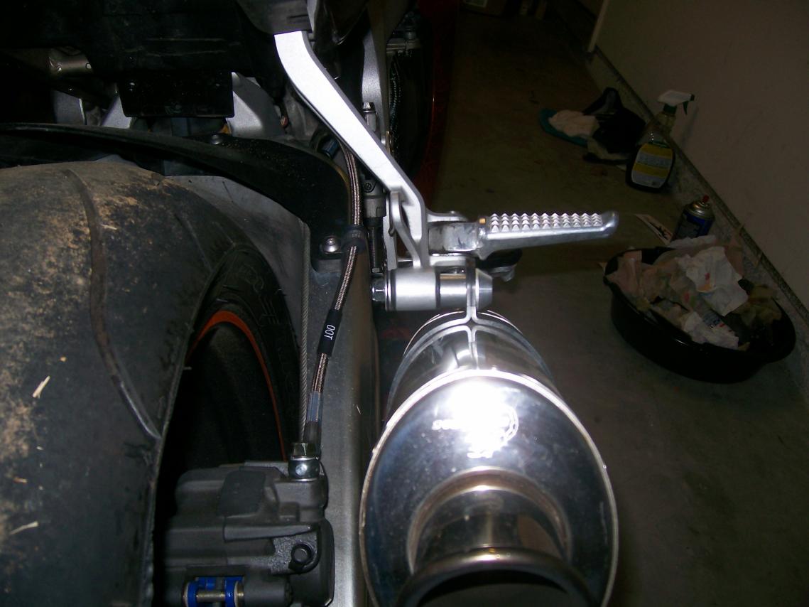

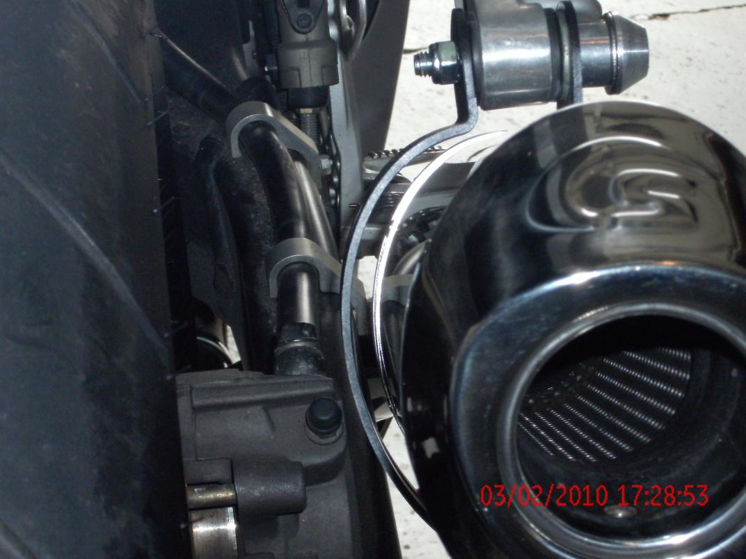

i recently put the scorpine extreme on my bike. but it's not sealed tight enough on the headers and where the can connects to the mid pipe. there is mist liqued type stuff dripping from it and i have it tightened pretty good. also where it connects to the rear peg it's lose there also has anyone else had this problem with the exhaust. as you can see in the last 3 pics gaps the 1st one where the connecter is where the mist is comeing from

Oh boy... The strap that goes around the exhaust and bolts into the footpeg isnt suppose to be seperated on both sides of the bolt. Common sense, come on now...

it also looks like the strap is going to rub on the swing arm....Just a heads up...

All scorpion exhausts have a rubber grommet that goes between the strap and the pipe...where is it?

and there is a scorpion exhaust on my F4i and it's perfectly fine. I think they sent you the wrong exhaust, or something got confused in the ordering process.

there was no rub garmet with it they only sent the can and mid pipe

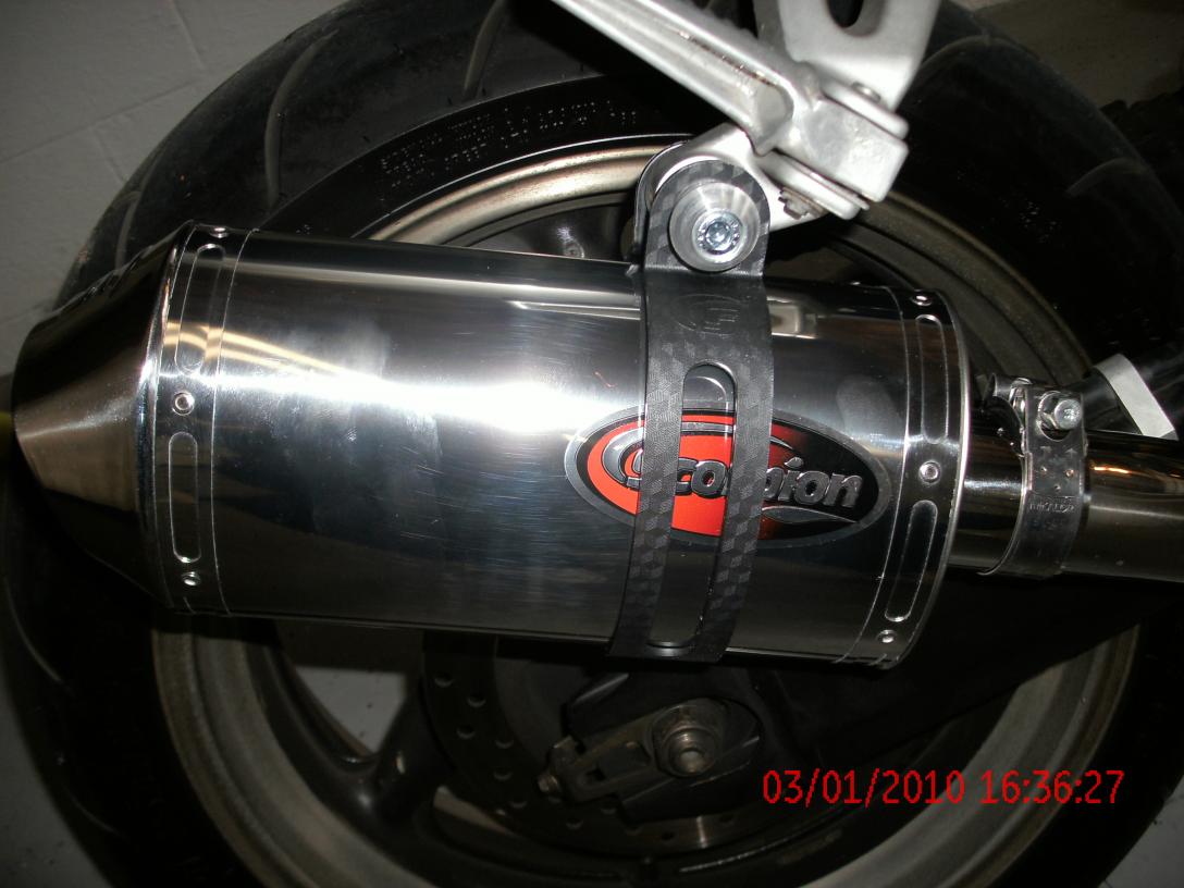

its a new strap, they sent me one bc mine broke, its plastic, and its not too bad quality either- that big spacer goes in between the strap and the mount on the peg, -just look at the pic
