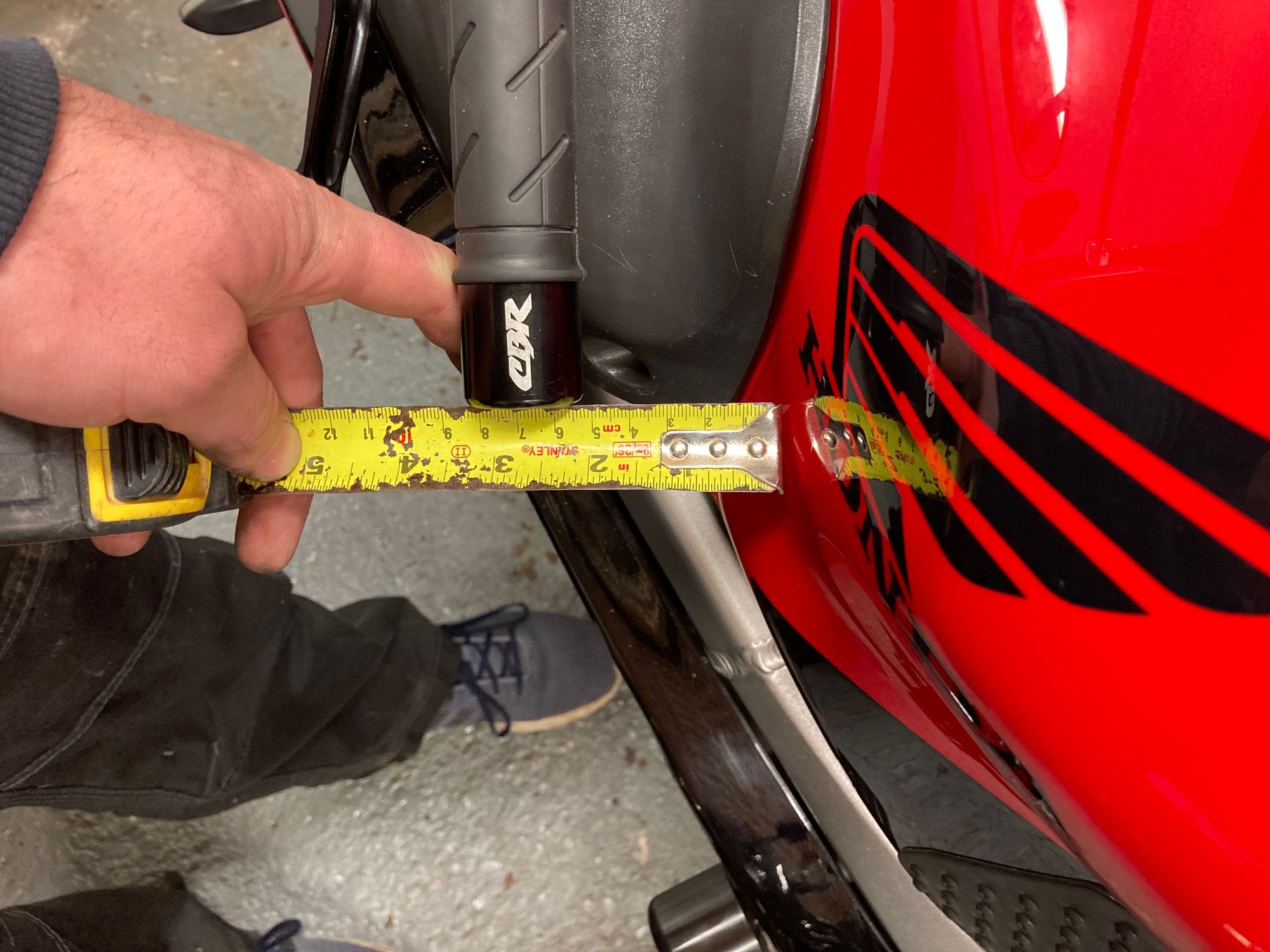

Hi all since falling off (at low speed) the other week I have replaced parts that needed replacing but noticed one thing.
The amount I can lock the bars left and right is different? Can anybody say if this is normal or something else is bent?
The right hand bar comes 8mm closer to the tank than the left.

If anybody has abit of spare time could you measure what yours are both ways? So I can try to set the same it would be much appreciated

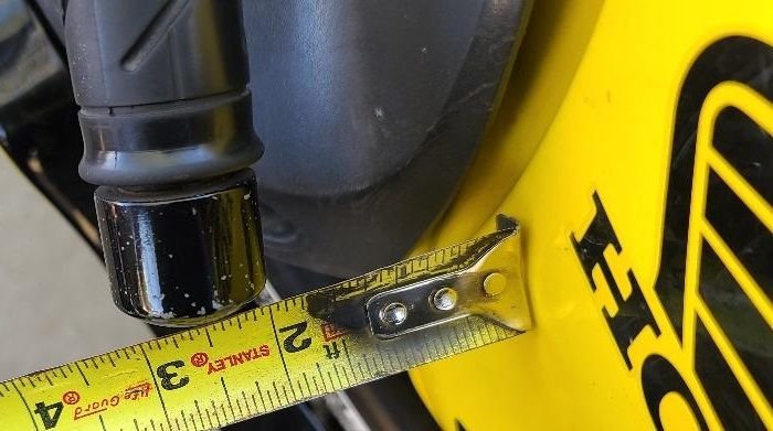

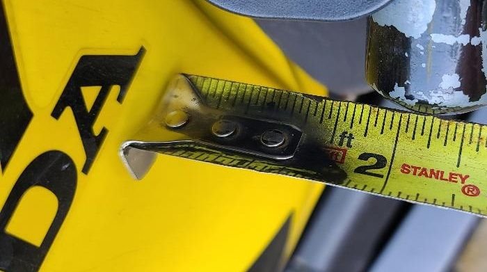

Left is 2" and right is 1-11/16"

Thanks for the info buddy 👍 seems like its standard for them to be 5/16 (8mm) difference atleast it’s reassured me that my bike is all good👍 3 days spent chasing a fault that wasn’t there 🤣 that’s some good luck finding the bar end..
