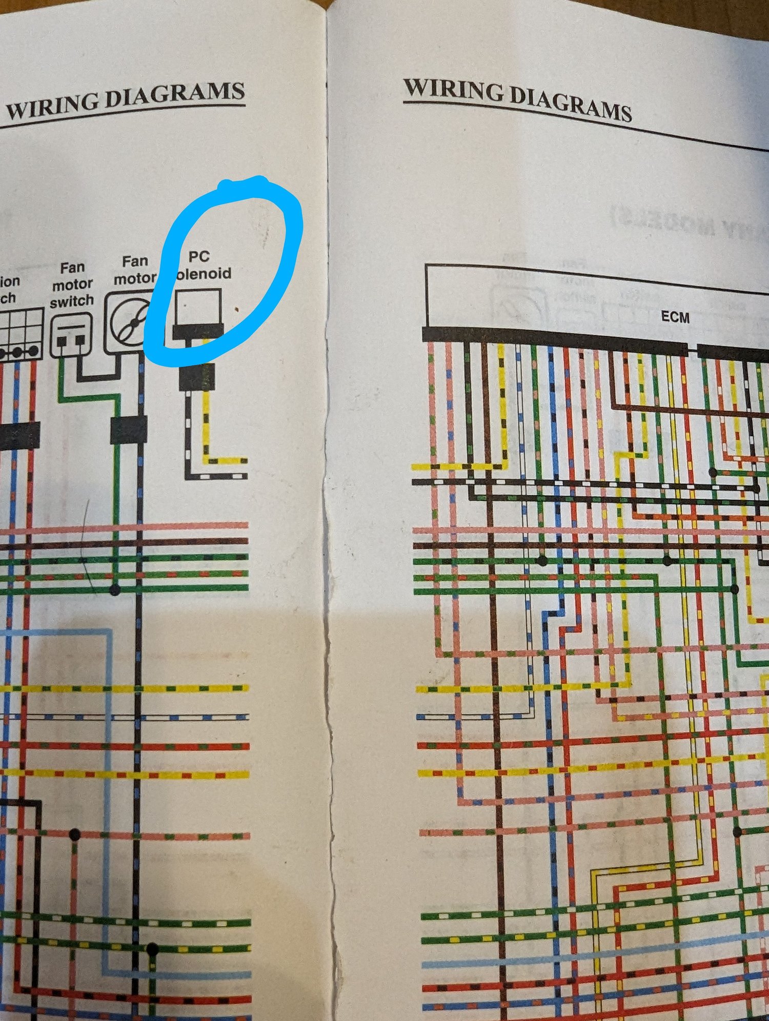

Hey, thanks. It still doesn't prime pump. Hooked it up this afternoon. I checked every pin coming from ECU. All have continuity. Wiggled them all to make sure. This was a used harness I bought. I think it's missing something. Bout to send you picture

This pc solenoid. What is it for? I don't have the yellow and black wire coming from that connector on the ECU
