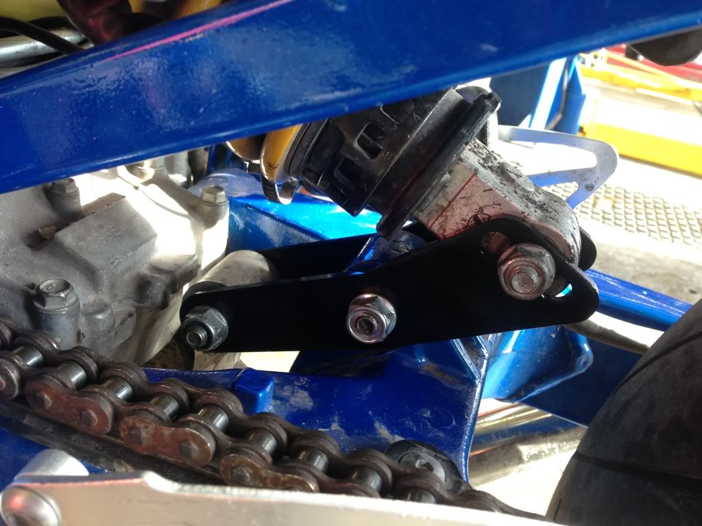

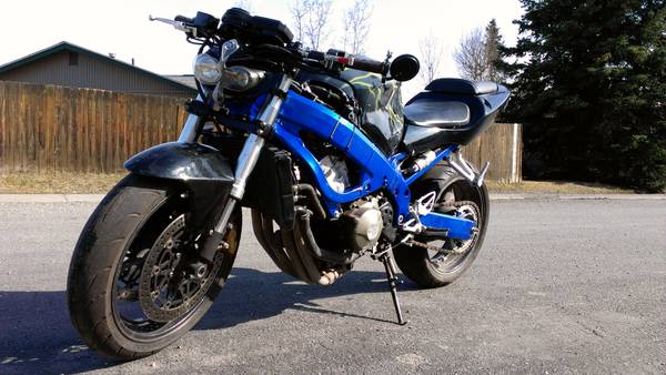

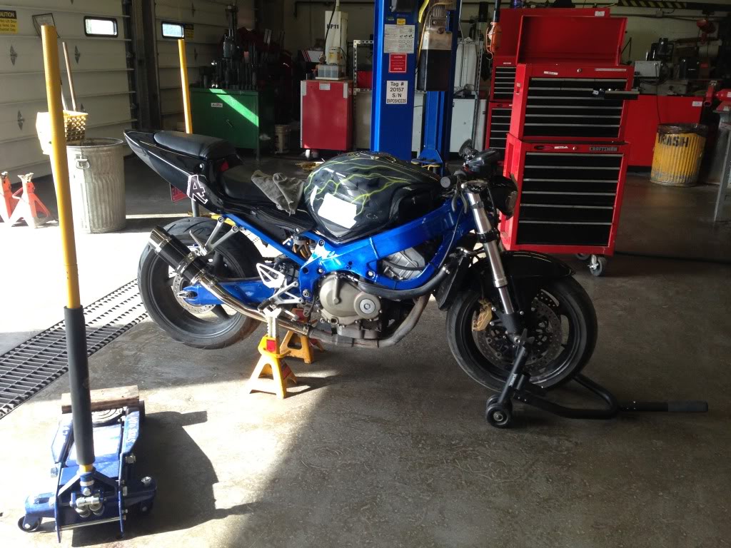

AirmanSkee Aug 13, 2013 01:14 AM
3 Attachment(s)
Black powder coated dogbones showed up today and was quick to bolt them on. Came with a stock, -1", and -3" drop, and I went with the 1 for now, as the 3" drop seemed too drastic and the tire was dang close to my plate in the rear anyways.
Attachment 31681
Attachment 31682
Attachment 31683
Now I gotta do something with the kickstand, it stands almost straight up now.
