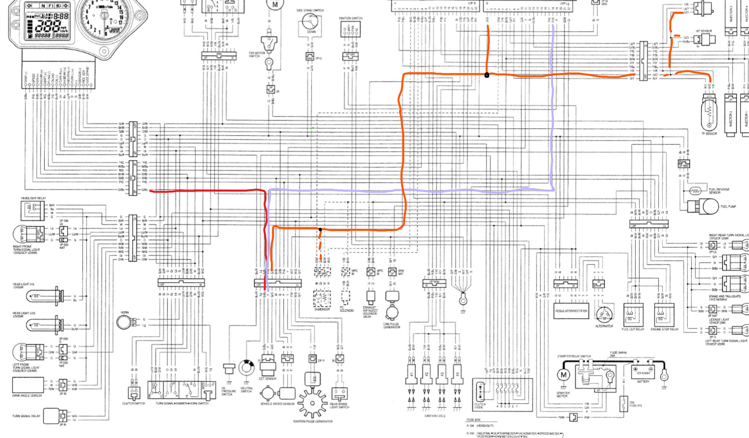

Continuing on, I believe its a wiring issue, since i replaced the sensor,
Does anyone know what the third (orange) wire is, it follow through and is also running to the O2, MAP, IAT, and TP sensor.
