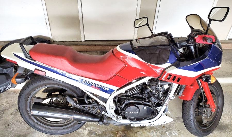

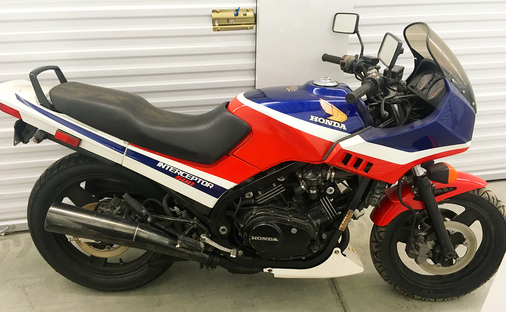

Woohooo!!! Good job! It'll look so much better! I did similar thing with my VF500F in '92 and it looks more like serious bike than Tonka or Fisher Price toy!
BEFORE
https://lh3.googleusercontent.com/d/...7bFsWi5byVlUzE
AFTER
https://lh3.googleusercontent.com/d/...n9PLSjUeEBrDKz
