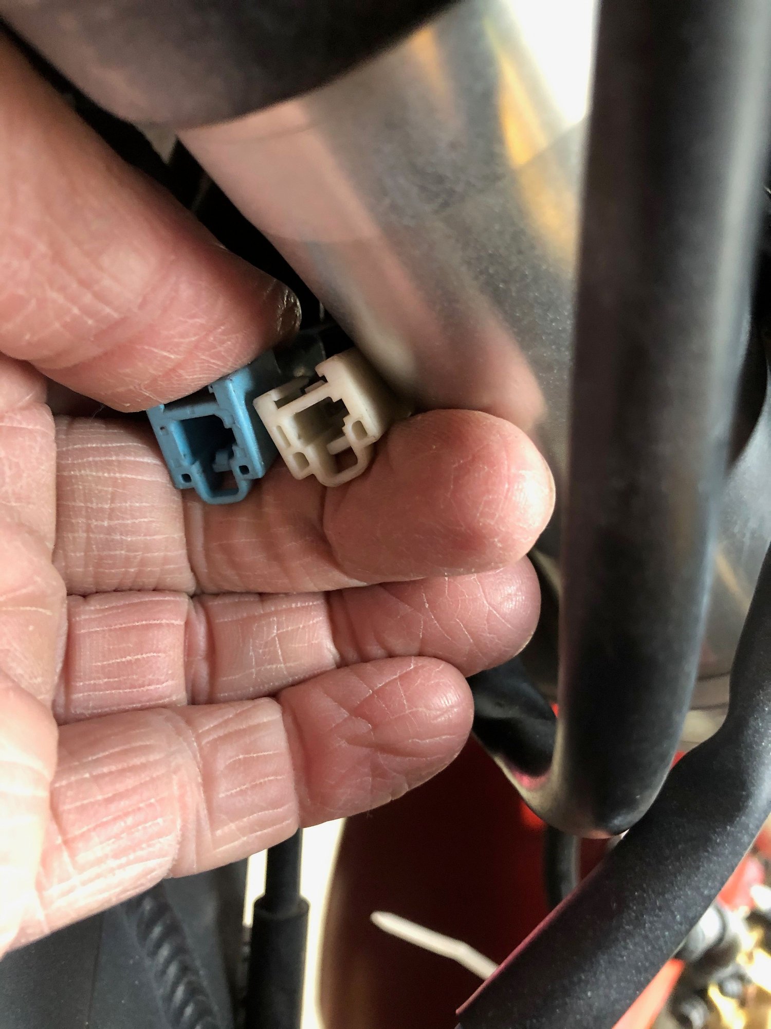

Trying to hook up my front turn signals. Where can I buy the adapter wires that fit into my harness plug-ins ? My signals have bullet connectors.

I'd rather not but if I did I have a blue plug with 2 wires and a white plug with 1 green wire.

The green wire is the ground. The two wire connector carries the running and turn powers. Since you only have 2 wire signals, the power for the running light will not be used.

They won't make adapters for it. You may need to find some broken lights to get the connectors off of to make your own. I'm not sure if a dealer can order the connectors alone or not, but I would check with them. The only other option I see to not cut the harness is to getto them together using the piggy back scotchlocks.

I went ahead and put bullets on harness side and got all 4 working !
