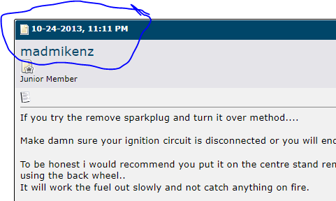

If you try the remove sparkplug and turn it over method....
Make damn sure your ignition circuit is disconnected or you will end up with a massive fireball and your bike on fire!!!!
To be honest i would recommend you put it on the centre stand remove the sparkplugs and with it still switched off put it in 1st gear and turn the motor over by hand using the back wheel..
It will work the fuel out slowly and not catch anything on fire.

@Not my bike If you look above the particular thread you'll see when a particular post was made. The older a posting is, the less likely that the person is to respond. Just a helpful FYI.
