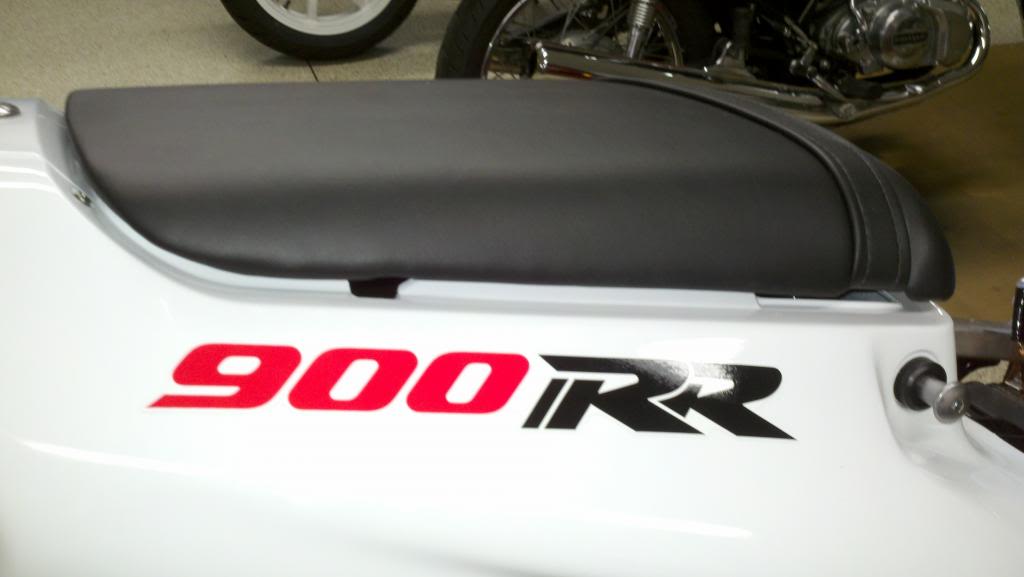

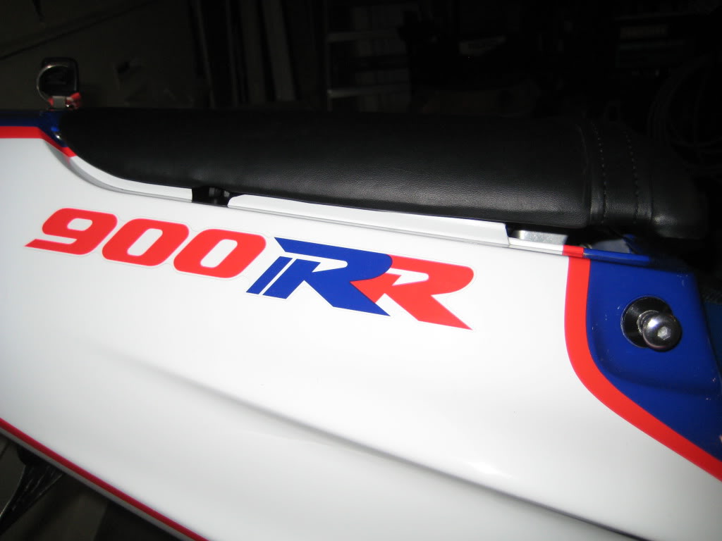

Motley, OK so I got around to finding my OEM seat. things get lost when you move and I had to find the right box. I put it on and looks like I have the same gap as you. so that must be the correct fit from Honda. looked at a few pics of other bikes and that same gap shows. have had the Corbin on pretty much since new so guess I hadn't noticed it on other bikes until you pointed it out.
so good news is your subframe probably not tweaked.
added pics:

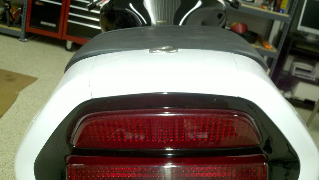

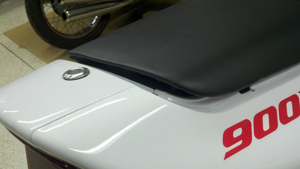

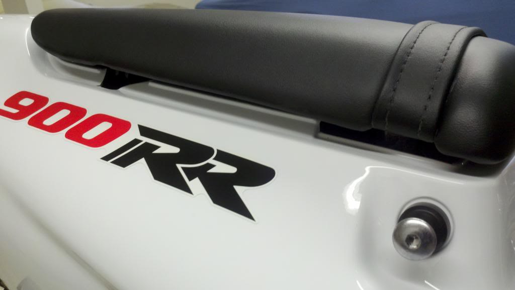

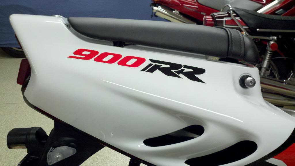

OK... finally got it all back together and the rear seat finally fits. It may not look like much but it was bugging the hell out of me. You could damn near reach into the back of the trunk with the seat closed... NOT GOOD!!
Original fit when I redid the bike...
Fit after bending the striker on the seat and the latch rod to pull things down tighter and eliminate the kickup on the R/S rear of the seat due to the opening spring on the right front..

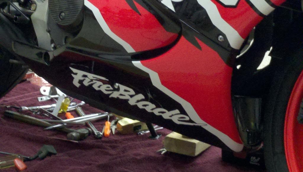

Here's a bonus pic of factory Fireblade decals fresh from David Silver Spares in the UK... I have more photos in the gallery section...
