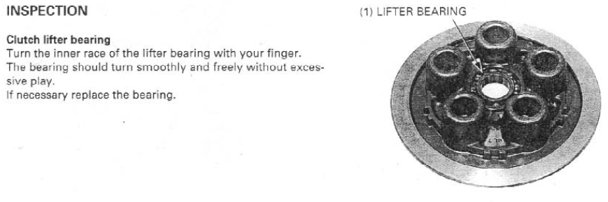

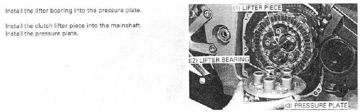

In reviewing the Honda documentation it doesn't indicate that the Lifter Bearing is a press fit. Normally if the bearing needed to be pressed in or out, the manual would indicate that. It only says to replace the bearing.
Here it only indicates to just "Install the lifter bearing". Nothing special.
Item #19 on this page indicates it's a 16003 bearing.
https://www.partzilla.com/catalog/ho...900rr-a/clutch
This page from a bearing supplier shows what the dimensions are for it. You could measure yours to see if there is any wear. I would think that the Pressure Plate would show signs of wear if it was supposed to be press fit as well as marks from installation/removal. You can also pick up this bearing from a local supplier. You don't have to go to Honda to get it.
https://www.qualitybearingsonline.co...ing-17x35x8mm/

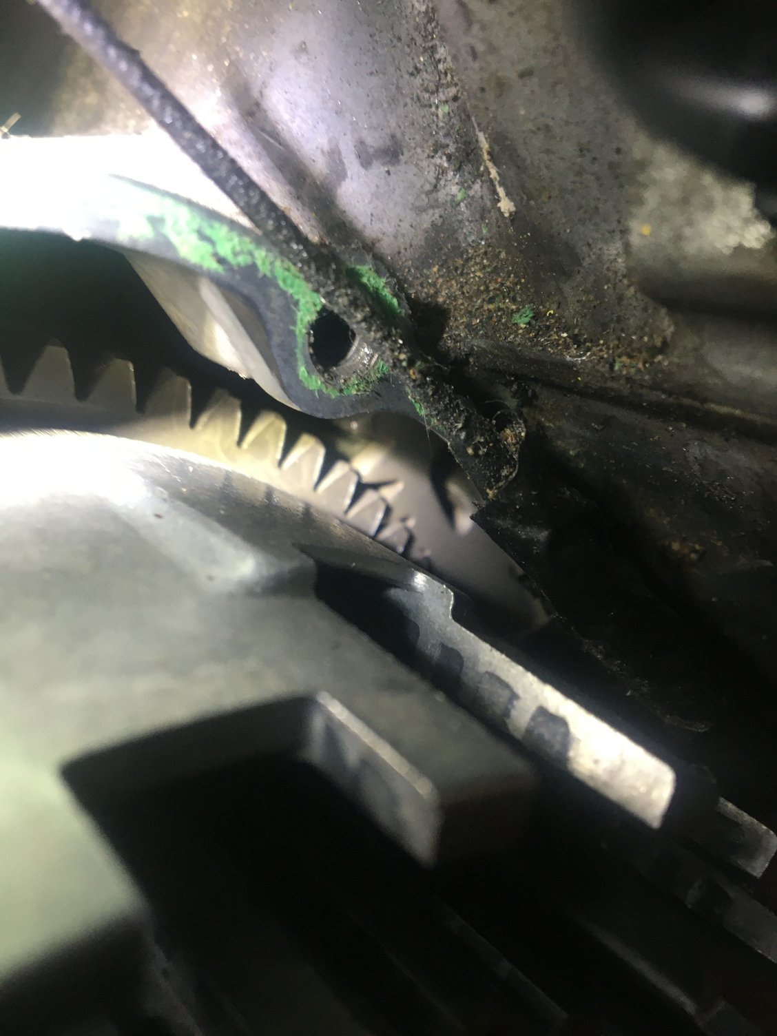

I got the needle roller fitted in the basket, they charged a whole £10, simple job with the correct kit I know but even so I thought that was very reasonable , anyway I need a quick hand hold from someone that has replaced a clutch basket on one of these!
When I was dismantling I noticed that the outer edge of the basket gear sits outboard of the primary gear by about 1mm maybe 1.5mm, on replacing the basket I have ended up with the exact same condition, so although I’m pretty sure that this is correct I’d like someone to say, “yes that’s how it should be!”
