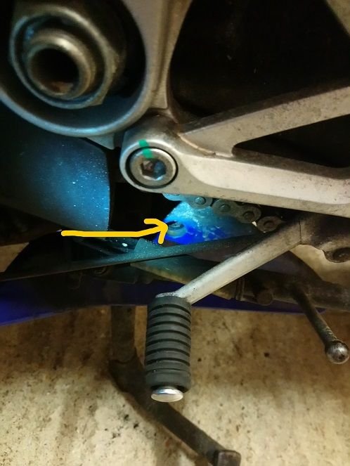

As soon as I got back home and inspected it, I found missing bolts, missing pipework and a non-standard fuel pump had been fitted and poorly cut into the wiring loom bypassing the fuel cut-off relay. (That’s not necessarily too uncommon on these bikes as they sometimes suffer with issues around the fuel cut-off relay and these bikes are often used on trackdays where fuel consistency is important.) Also, the fuel filter had been removed in the process and incorrect types of fuel hoses were installed that had become rigid and brittle. You can see the poor fuel hoses as the green ones in the picture below on the bike in the background.
The two retaining clamps that hold the rear brake hose onto the swingarm were also missing and the hose was just held in place with a grey cable tie as you can see in the first pic. The front mudguard was also cracked, with only 1 of the 4 mounting points properly intact. None of these points were mentioned in the listing and so I contacted the dealership and told them I wanted it all rectified immediately. They refused to budge on the fuel pump or pipes issues and the mudguard but installed cheap drain hoses to the fuel tank (which were the wrong length) and managed to find some bolts that roughly fit the holes for the ones missing out of the fairings. Talk about doing the bare minimum. The bike was now far from perfect in my opinion, but it was working and did the job… for a while. For a bike that was mostly factory complete at 20 years old, I was happy enough with the price I paid for it with the few remaining faults.

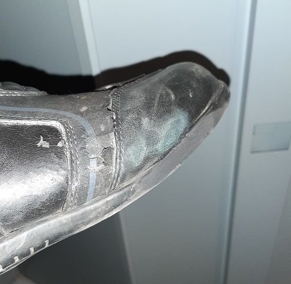

At the end of January 2020 I got sent way with work for 4 months. When I came back I looked at the bike and saw it was in a sorry looking state. The chain had dried up, a lot of the bolts had surface rust or the aluminium fairing bolts had corroded and gone chalky as they sometimes do but more annoyingly the front fork seals had perished and the fork oil had leaked out all over the front wheel and my garage floor! The bike could not be ridden until at least this fault had been sorted out. So I ended up searching for a cheap to buy, cheap to run bike for the interim. I ended up buying this for fun….
So much fun on twisty back roads and roundabouts in fact that I had to buy new boots with toe sliders on them…

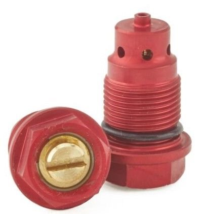

In the process of dismantling the forks, I managed to find one of the compression damping adjusters was seized and my efforts to remove it had only destroyed it beyond acceptable use.
In came the K-Tech adjustable compression / rebound damper adjusters as a replacement as Honda themselves didn’t even list them as a separate part in their part diagrams or factory service manual. These parts were nice as they were machined better and had more adjustability settings that you could actually feel! (I think the original adjuster had 6 settings whilst these have 15 and a very noticeable ‘click’ between each setting)

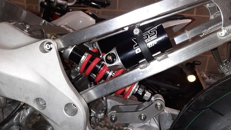

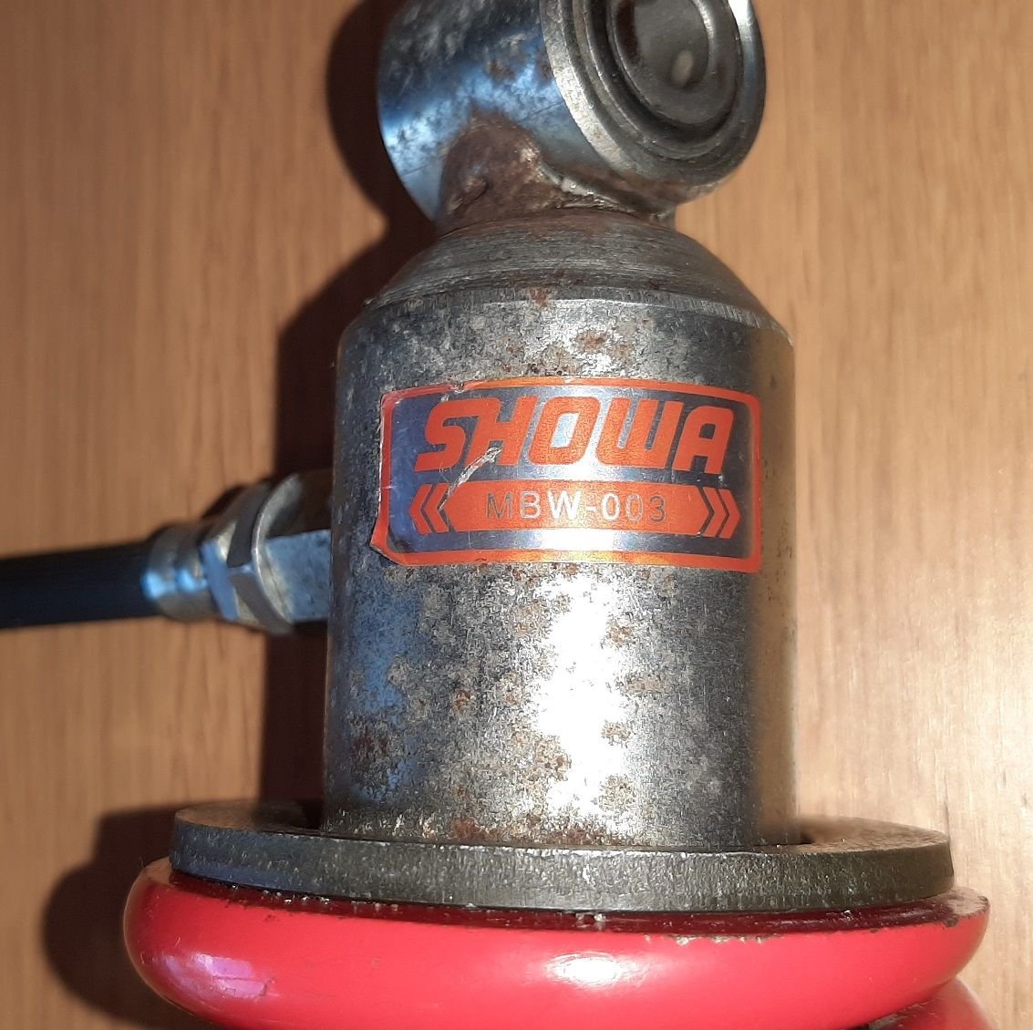

On to the next job. Might as well look at the rear shock whilst I’m at it!
The original shock was still fitted which was great news. Sadly, it was a bit corroded in places and the adjustment rings at the bottom had seized up from corrosion whilst the remote reservoir was basically empty. To top it off, both the compression and rebound adjustment screws had seized solid and trying to turn them looked as if it was going to chew the heads or snap them off. Sad face indeed. I attempted to dismantle it and rebuild it, but after consulting Brook Suspension once again for advice, they told me this specific shock cannot be re-gassed without first drilling through the reservoir end plate and replacing it on rebuild. The replacement parts are now unobtanium so whilst they do advertise a shock rebuild service for a great price, this exact one they cannot accommodate for. One model before, or one model after apparently they could but not the 1999-2000 FX.
I could not find even a hint of the necessary parts anywhere online from any country and had no other option but to put an aftermarket shock on it. Now, here’s the dilemma. I want to go for a factory standard look as much as possible. So whilst I could put an awesome Ohlins shock on it for £480, or a Hyperpro or even a Nitron shock as slightly cheaper options, neither of these came with the option of a red spring or a remote reservoir on a hose and I wasn’t down to modify a new shock at even more expense. I once again contacted Brook Suspension and explained that I’d looked on their website for options but nothing seemed to fit the build. The guy on the phone told me he had the exact model I was looking for from YSS which fits the brief perfectly. I knew they did one for the CBR900RR in the form of the MX456 shock, but they don’t list it for the FX on their website. Doesn’t mean they can’t get it though! I special ordered it and had it sent from the YSS Factory in Thailand. I can’t even remember how long it took to arrive, but it was a lot faster than I was expecting.
Old Apr 6, 2022 | 04:06 PM
D.Y's Avatar
D.Y
Joined: Feb 2022
Posts: 40
Likes: 11
From: Antrim, Northern Ireland
HOWEVER!!! It turned up with a black remote reservoir! Black! Not even anodised gold. Far from the factory anodised silver look I wanted! The websites only ever seem to show it with a silver reservoir so I thought all was good. That being said, I wasn’t going to complain about it as it had already cost me £580 by that point and I had waited for it to arrive after all. I can manage I suppose.
I set all of the settings in the middle, so a new owner can adjust all of the parameters either way if they want to. Installing it on the bike was easy and I used new stainless steel bolts, not just for the top and bottom shock mounts, but also for the connecting plates and mechanisms (often called dogbones). I could have easily used titanium bolts here, but the bolts need to be able to take higher tension / impacts and stainless steel has a higher tensile strength than titanium. Titanium is more susceptible to snapping under stress where stainless steel will likely bend more. I checked all of the bearing components in the dogbones etc and found that whilst a bit dirty, the bearings were in good condition so I cleaned them up and thoroughly regreased them before fitting new dust seals. The whole suspension mechanism was now rock solid and of course cleaned up perfectly.
To protect the remote reservoir from unwanted scratches caused by clamping it in place, I put a small piece of foam on the holding bracket for it to sit on and then used a bit of adhesive heat-shrink tubing to cover the majority of the retaining clip so that way any small movements should hopefully not scratch it much over time.

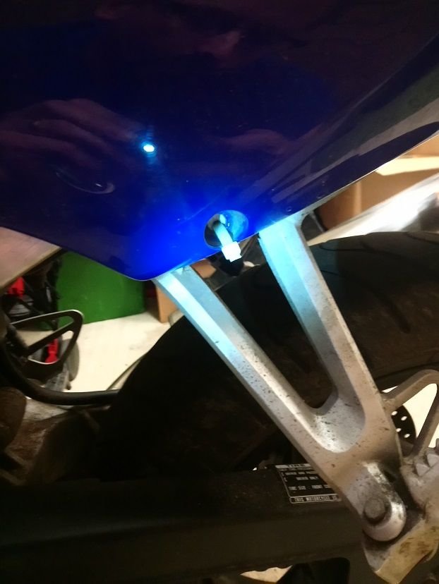

Now, I couldn’t go fitting an awesome rear suspension setup onto a dirty swingarm could I??...
I checked the bearings and seals in the swingarm and found they had a little bit of play in them and the collars that help it fit together were a little bit corroded. So they all got cleaned up and new needle roller bearings were installed into the swingarm with new seals. The years of dirt and road grime cleaned up after about 8 deep cleans and soaks in degreaser and spirits. I noticed the sticker on the swingarm was rough and starting to flake off so I replaced it. Replacing the stickers wasn’t easy. I couldn’t find anywhere with them in stock. I ordered about 3 times from websites only to be told my order had to be cancelled as they couldn’t be viably sourced. I ended up finding a website for a back street shop in Japan who supposedly had them in stock so I ordered them in. They took about 16 weeks to arrive but absolutely do the job in making the swingarm look great again. I considered polishing the swingarm to take off the minor stone-chip blemishes all over it, but it wouldn’t fit the bill of a factory standard look, and even after taking the blemishes out, getting the brushed aluminium look back onto the swingarm would have been too much time and effort.
Old Apr 6, 2022 | 04:35 PM
D.Y's Avatar
D.Y
Joined: Feb 2022
Posts: 40
Likes: 11

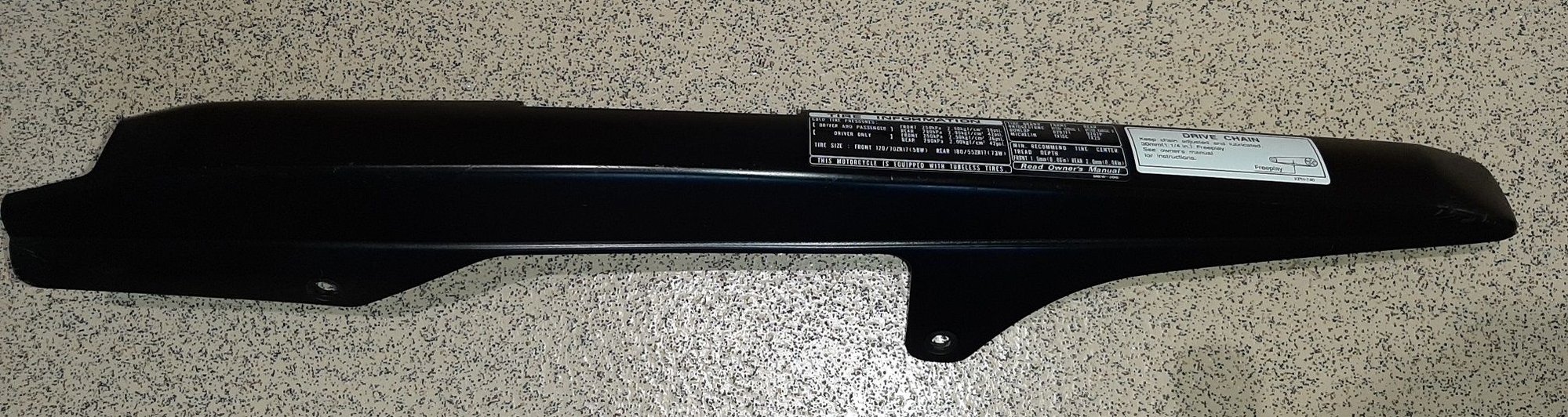

I did the same process for the rear mudguard whilst I was there, cleaned it up and replaced any missing factory stickers. It came up amazing after treatment with trim gel to restore its colour and protect it.
