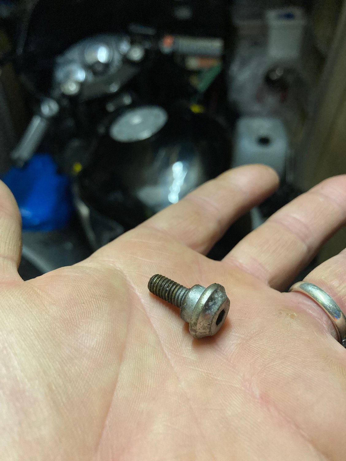

Default Found it! But now have a rogue bolt left over
Found it stuck to the oil pickup. But now after having the bike in many pieces and then putting it back together pretty successfully, I have one bolt left over. Please help me with ideas as where it could be from? It looks like the only one of this type I had taken off, but where have I missed? I hope it’s not too important!!
Old Apr 19, 2024 | 03:06 PM
Connella08's Avatar
Joined: May 2022
Posts: 142
Likes: 35
Judging by the condition of the bolt, I would say its an exterior bolt of sorts. If I had to take a guess by the shoulder under the head of it, this holds plastics on somewhere.
Old Apr 19, 2024 | 03:31 PM
W3jltcbr's Avatar
Joined: Apr 2024
Posts: 6
Thanks for the reply, it’s definitely different to a fairing bolt though? I’ll keep hunting
Old Apr 19, 2024 | 06:21 PM
dannoxyz's Avatar
Posts: 1,988
Likes: 439
From: Mesa, AZ
Looks like something to hold fairing on. See shoulder? It fits through larger hole than bolt on fairing. Depth of shoulder matches thickness of fairing so it stops before crushing fairing.
