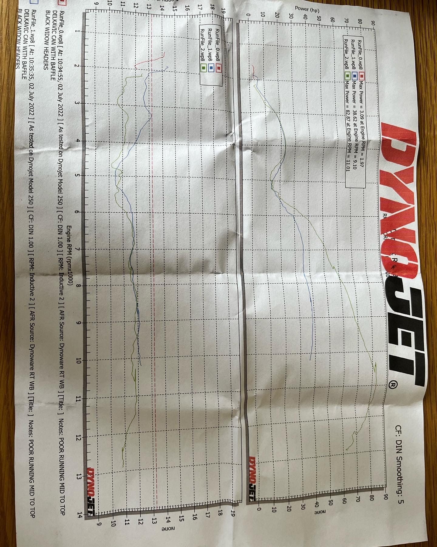

Took my F3 for a dyno run to see if the sniffer could tell me anything about fuelling and if it was all **** about tit. The graph showed the midrange to be dripping rich and I should try smaller jets. He recommended 128 130 130 128 main jets to start with and run from there. This is obviously WAY smaller than stock 135 138 138 135 so due to these Black Widow Headers they have created a super rich condition but it is probably coupled with the airways in the carbs being partially blocked and/or the pipes flowing much easier and the stock air filter not drawing enough air through. Will try smaller jets and update everyone later this week!
Thankyou @idodirt! not bad at all for a scabby old CBR eh. The chap at the dyno said he could fish quite a few extra ponies out of it with a tune up too, its just gotten all out of whack over the years through faffing and idiots like me having a pop at mechanics.

I've not been on in a while so hope its been resolved, That's awesome that you went and got a dyno run, the guys suggested jet sizes are dubious though, i suspect he'd lead you down a rabbit hole.
Was just thinking, when you dyno'd was it still shimmed? That would explain it being too rich in the mid. Another thought was it's worth removing the baffle or fitting one, some exhausts are picky about that.
My open shorty flattened out my midrange so much that it felt like vtec kicking in when it pulled through to wide open before i set the carbs up.
If it wasnt shimmed when on dyno somethings a miss, exhaust blockage, needle wear / a seal etc or something causing overfuelling, could be worth trying another set of carbs to rule them out

The jets the dyno guy recommended worked a lot better with a pipercross air filter but the flat spot was still there in the higher gears, starting to think its something more sinister like you said.. the shim was a 0.5mm washer at the time of the dyno plus 138 140 140 138 main jets and it was draining a tank in no time
its just not getting enough air but the more i faff the more down the hole it goes! It would be worth the trip to Scotland just to get some pointers in the right direction!
Even with the pilots at 1 turn out the choke was almost redundant on start up, its all such a mess! Would a carb balance be in order?
