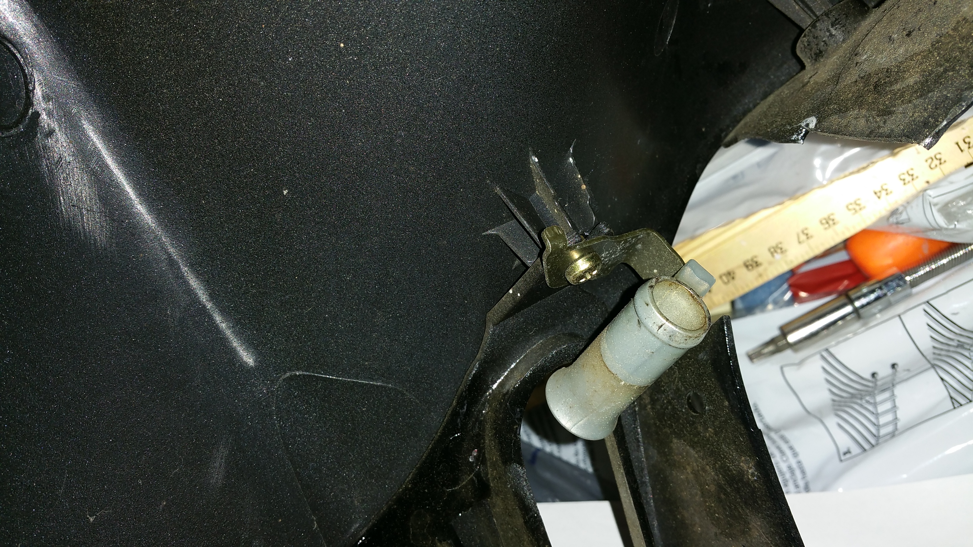

Hey guys
I recently bought a 1996 F3.
Most of the fairing panels were scratched or broken.
So I removed them all, and bought a fairing kit for it.
Now for the life of me, I cannot seem to figure out how to mount the DAI hoses to the front of the fairing.
Ive looked on Google for ages, but cannot seem to find a single pic showing what I need.
Help me if you can!

Iv'e seen that diagram before, doesn't help me see how it mounts to the fairing though.
I need to see how the small air hoses for the slow speed circuit mount into the nose of the fairing.
So that's the front hoses with the yellow arrows in the diagram above.
Thanks

Old Jan 27, 2017 | 08:09 AM
Posts: 7,177
Do these pics help?
Old Jan 27, 2017 | 10:21 PM
gorn's Avatar
Joined: Jan 2017
Posts: 30
hamlin
Perfect! that's what I needed to see. Thank you
