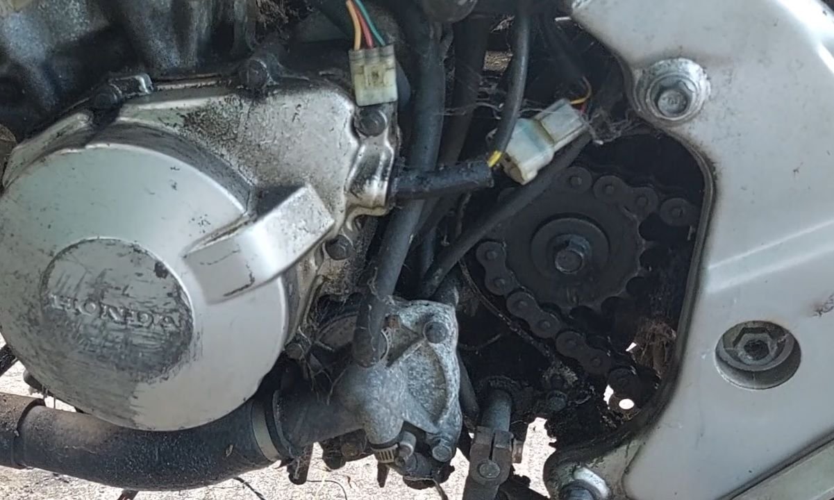

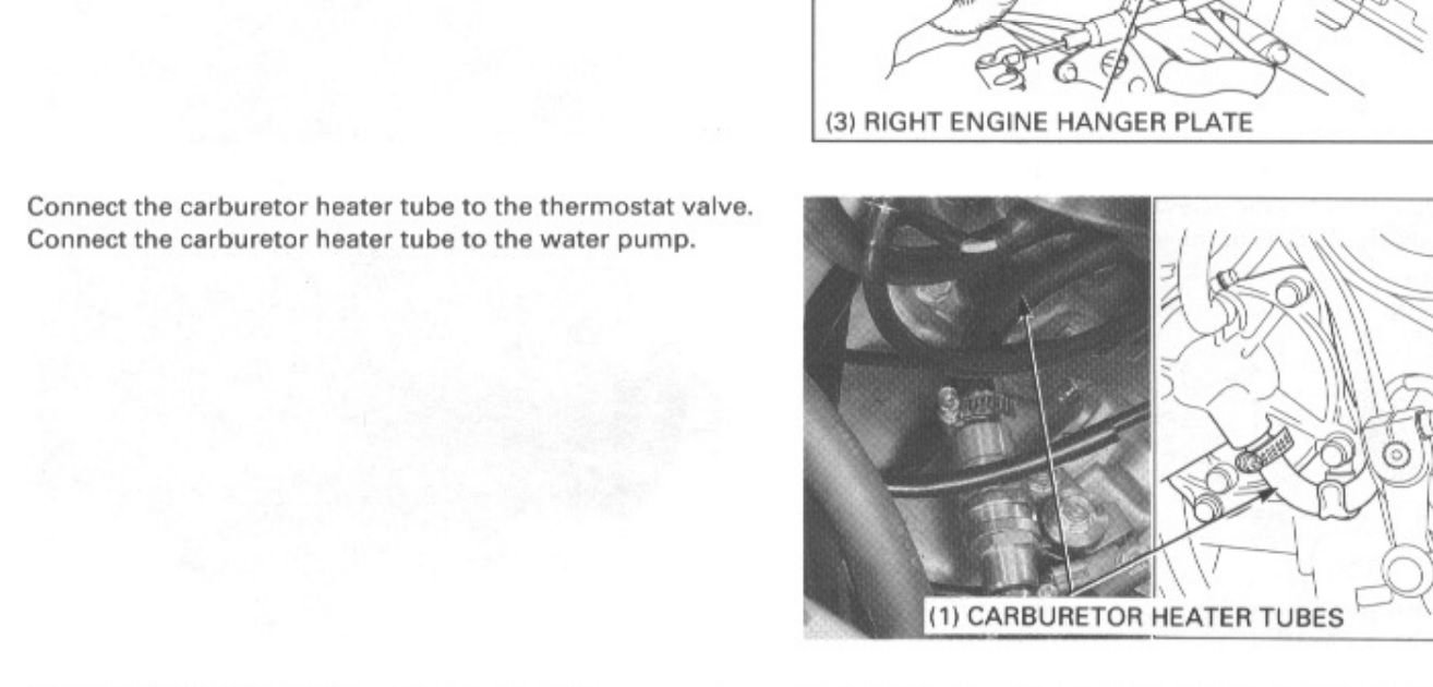

Carburetor heater tube. Here's some pics of how it was and the manual photos. I cannot for the life of me get it to refit. The pipe im struggling with is the lower righ thand water pump pipe that routes up in to a thermostat valve and then on to the right side of the carb. The manuals show that the valve clamps to the middle of the 3 bolts on the starter motor mount. So the hose as it came off routed directly down under the water pump, then immediately back up behind it and in to the vale. I cannot remember now whether the vale was clamped to the starter or not and irritatingly none of my videos show it. Right now it seems whatever I do the pipe is too short or massively kinking / straing the join at the water pump.
Am i being dumb here? I feel like maybe at some point the pipe had a gnarly end and someone shortened it by an inch or two to fix the issue and then routed the pipe as i found it. Am i right on the route of this pipe / clamp and is my solution just to buy a bit of hose from vale to pump that is 2 inches longer?
Also ... There's an earth wire I've completely lost memory on. Im sure its in the manual somewhere but if anyone happens to know. I thought it clamped to the same starter mount bolt to be honest (its a wire about 16 inches llong with connections at either end to allow it to be clamped under a bolt. Where does this go?

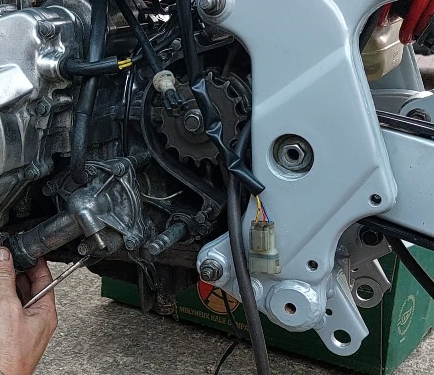

Another Update, this is about where I am at right now
