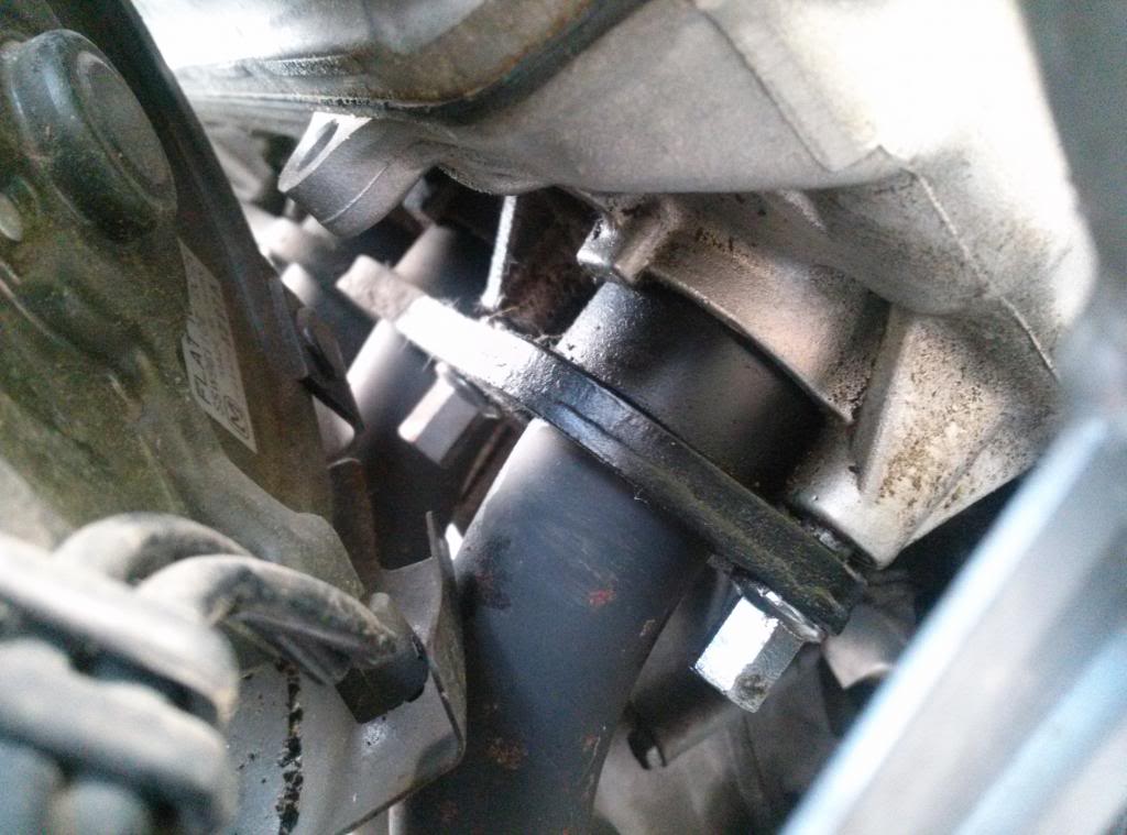

Issue #1) While idling- the bike keeps backfiring through the exhaust. If I increase the idle over 2000 rpm or so, the backfire goes away. Stock exhaust
Issue #2) Cylinder 1 and 3's exhaust pipe are not nearly as hot as 2 and 4- they are all working, but a quite noticeable temperature difference.
Issue #3) The exhaust pipe on cylinder #1 seems to be leaking- haven't investigated too much yet
Issue #4) Power, great over 4-5000 rpm, still a little sluggish below that number. I would say the bike is running at 85-90% like it should.

Hello,
So I took off my exhaust today to do some more investigating (wet exhaust on cylinder #1) and I found that the pipes 1 and 3 are quite wet, 2 and 4 are quite dry. Is there some sort of relationship between cylinders 1 and 3, like both run off the same coil pack, or is this something completely coincidental? I'm guessing the moisture is gas? If so, I can see how this would cause the backfire, now the question is why are those exhaust pipes wet. Thanks again for any help!
Another thought, when I cleaned my carbs, I did not have the d-shaped pilot jet tool to remove the pilot jets. There was quite a bit of crud in the carbs and the jets were pretty plugged up. If I didn't clean the pilot jets, would this cause the symptoms listed above? Thanks
