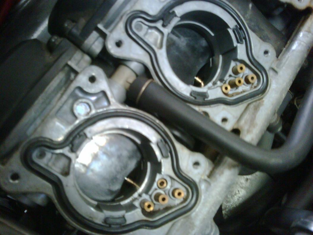

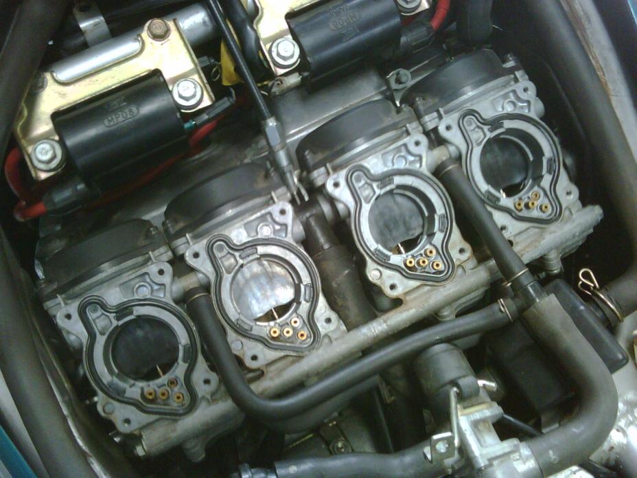

well i got the side fairings off, gas tank off, got all the way to the carbs and everything thing looks clean?? im gonna post pics real soon. i think something is wrong with the choke. some hoses going to the fuel tank were not connected
Err... Everything looked clean? Did you actually take the carbs off the bike and open them up?

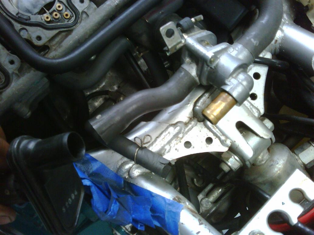

yes! the bike never sat for long peroids of time!
Attached Thumbnails 96 600 help-img00215-20090818-1922.jpg   96 600 help-img00210-20090818-1557.jpg   96 600 help-img00209-20090818-1336.jpg   96 600 help-img00208-20090818-1335.jpg   96 600 help-img00207-20090818-1334.jpg

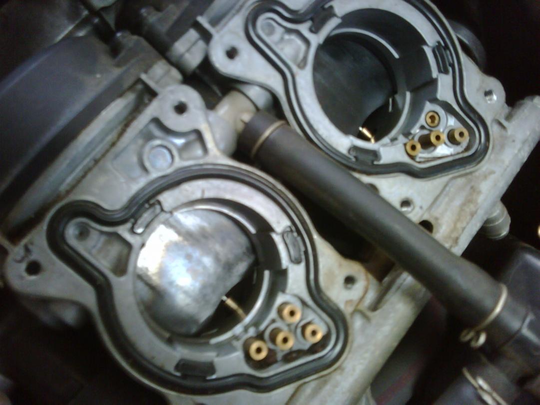

tryin to get more pics tomorrow

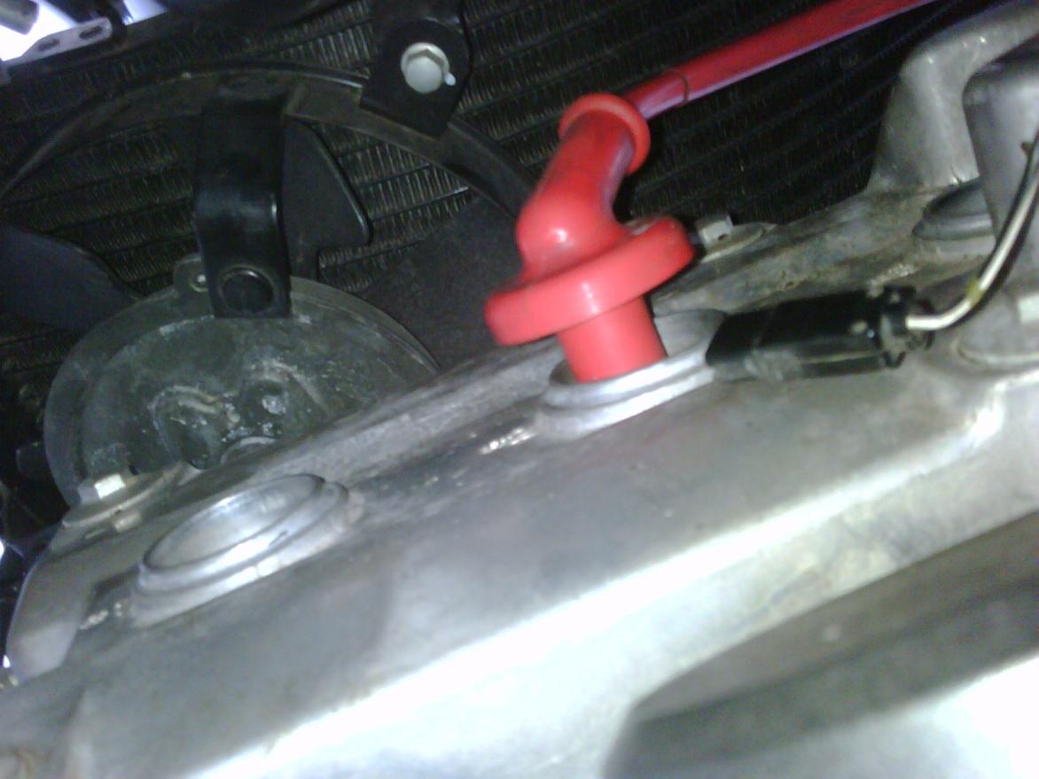

in the first set of pics, the second pic is the spark plug wire. it wont go down any further and the six point spark plugs is completely rounded off and i cant get it out. i will try to post pics of that but its gonna be hard with the motor still in the bike! the only way i could see was with a pocket mirror and light.

well i fixed the messed up threads in the cylinder head for the spark plugs with a time sert! (what wonderful thing) put everything back together and it most def made a difference and feels like i got some lost power back but it still stumbles on mid throttle wtf
