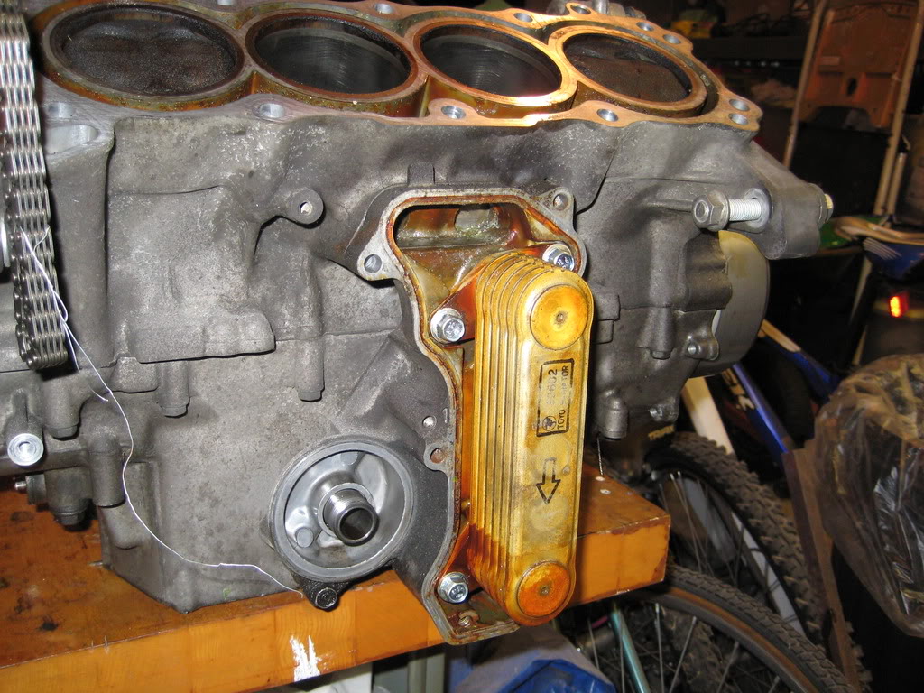

Might be from your oil cooler o-rings are dry rotted and letting the oil into the coolant?
That would be my main guess. I'd do that before i do a total top end rebuild, thats pricey. Gasket kits alone are going to cost ya a pretty penny.

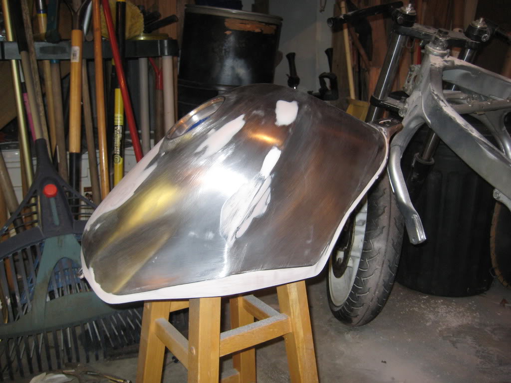

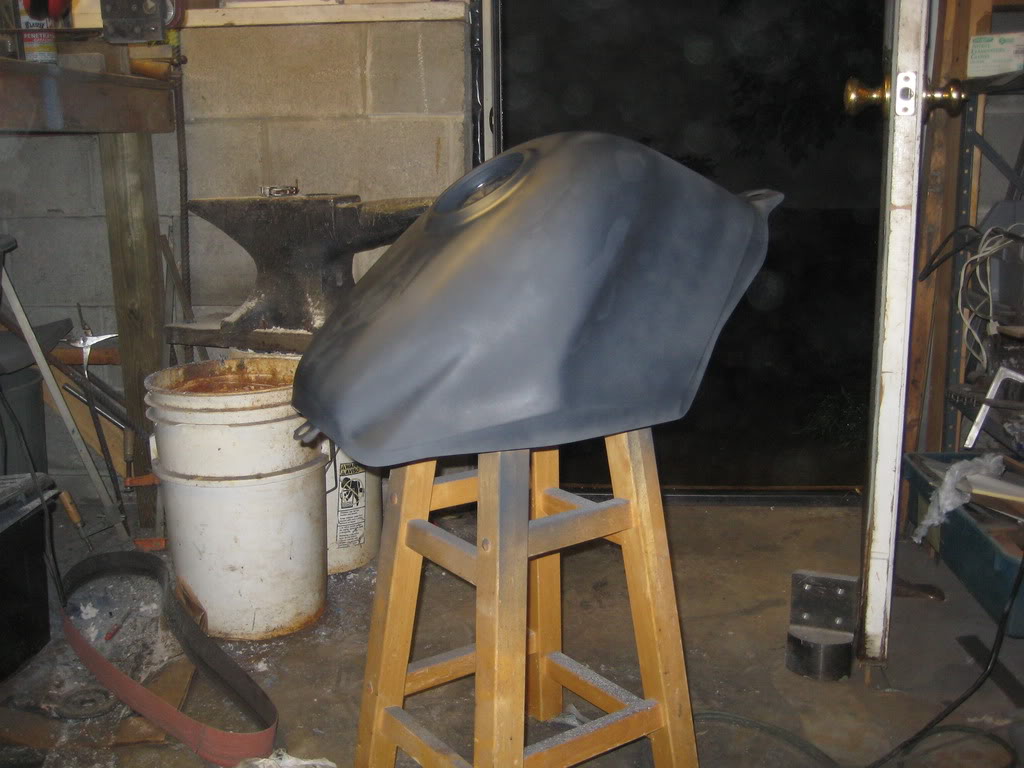

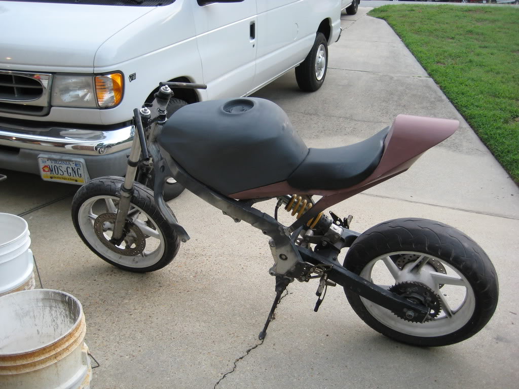

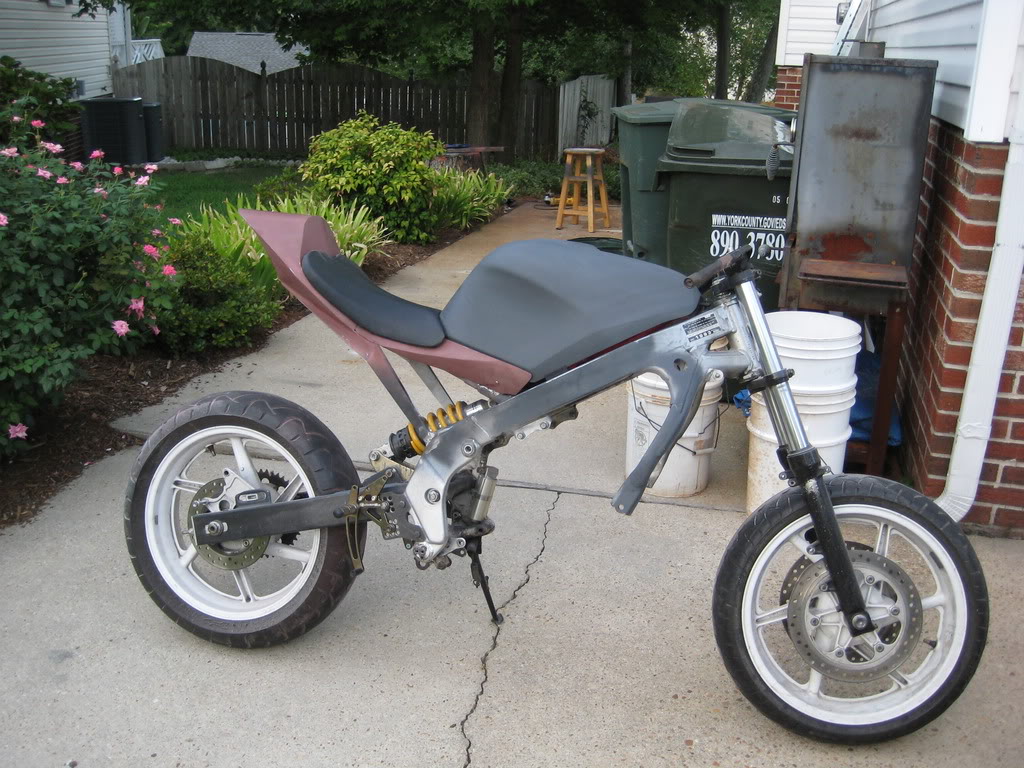

First off, i cleaned up the tank and fixed the dents:
Attachment 54412
Then, primer, then sanding, then bondo, then more sanding.. and so on Ad Infinium. and there is more to come, though i am less concerned with the tank since it is going to be wrapped.
Attachment 54413
look mom! no dents!
Attachment 54414

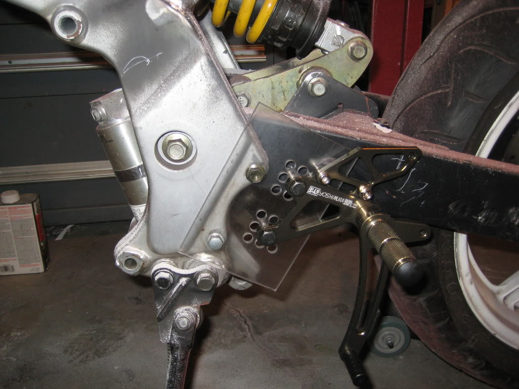

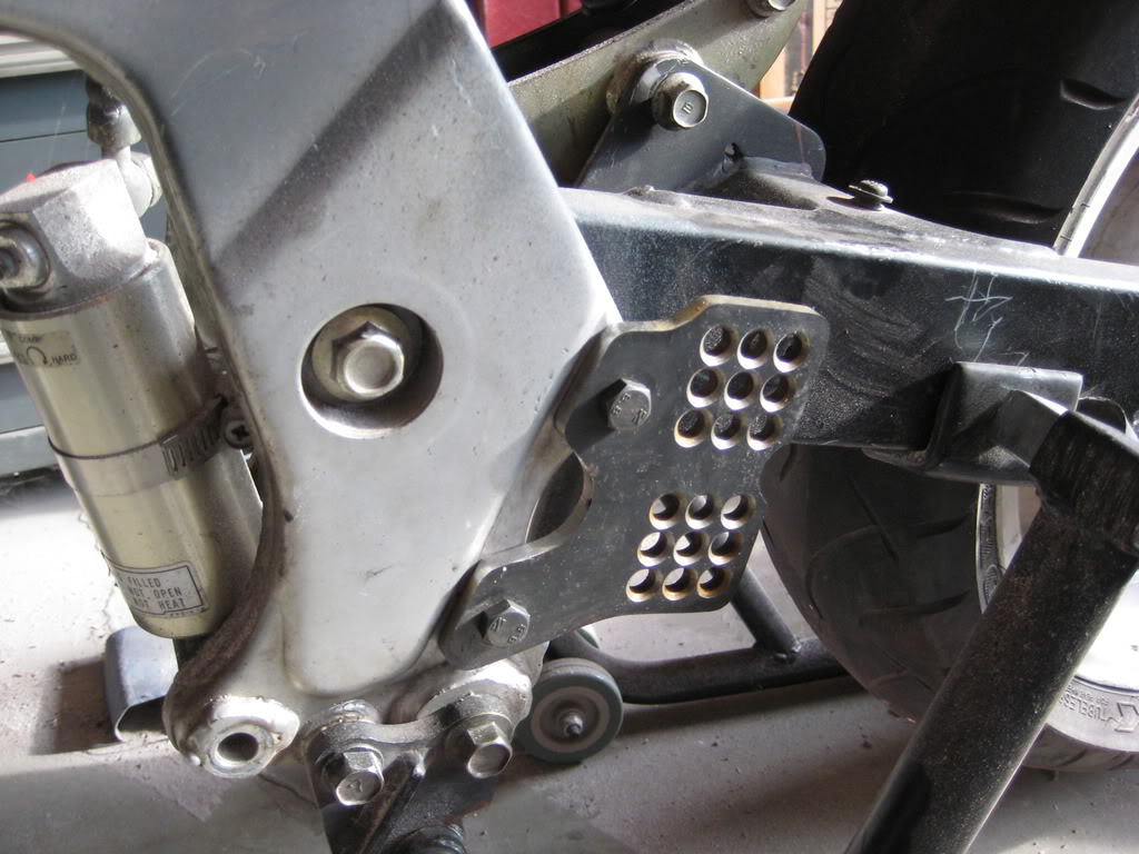

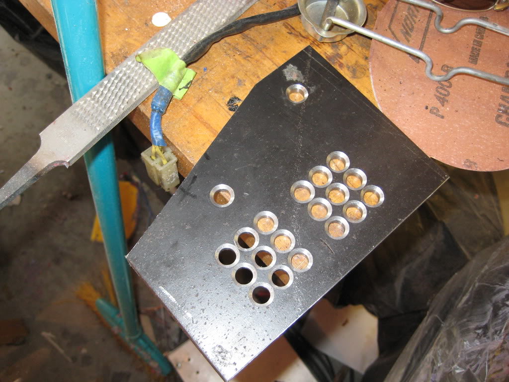

then, cause i needed them, i fabbed up some rear-set adapter plates. Prototype first to see if it clear everything:
Attachment 54415

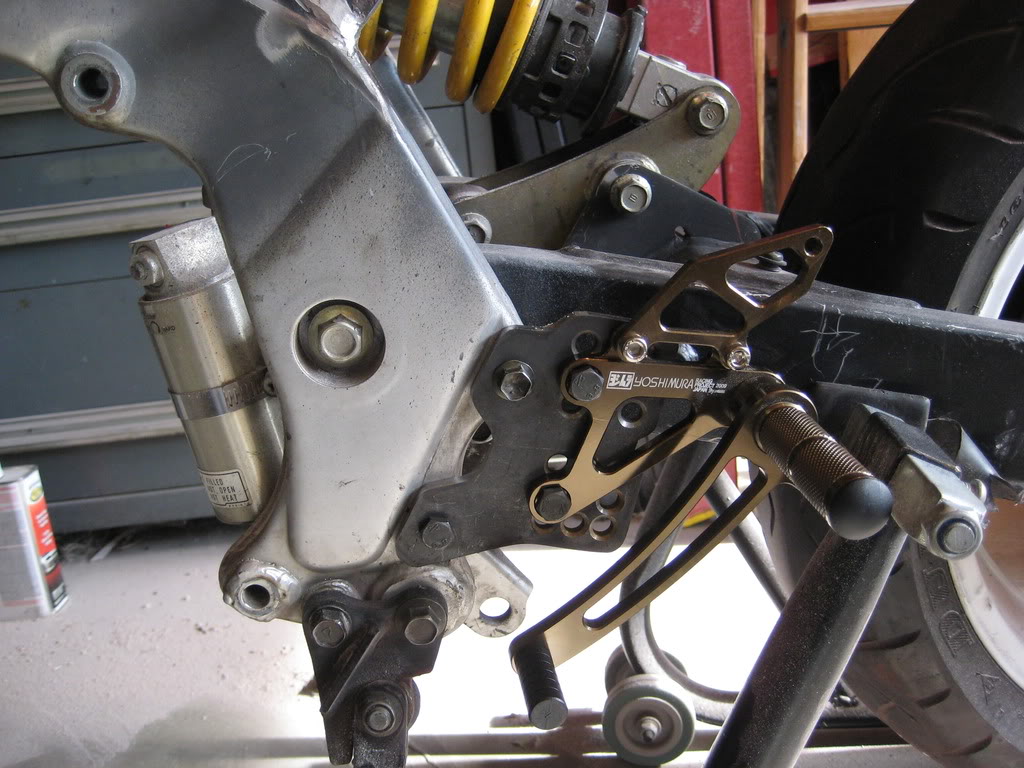

yes it works, but needed to be tweaked a bit, then made in 5160 steel, with some lovely countersinking...
Attachment 54416
a little grinder work, and viola!
Attachment 54417
Now with the rearset:
Attachment 54418

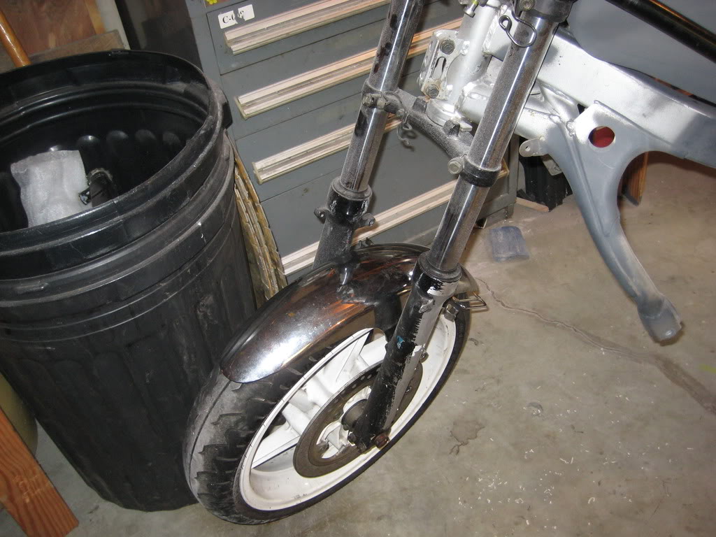

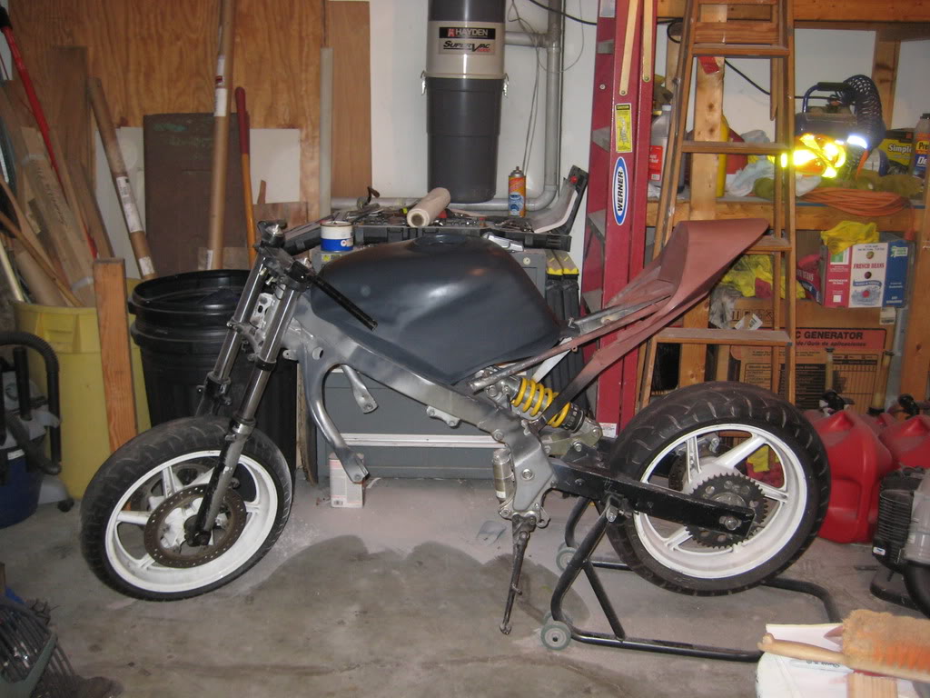

I also got my fender in. gonna be working with a chrome 84 magna front fender. gonna mod it to fit and then duplicate it. i like the shape, and it is steel so it will be shortened and beautified
Attachment 54423

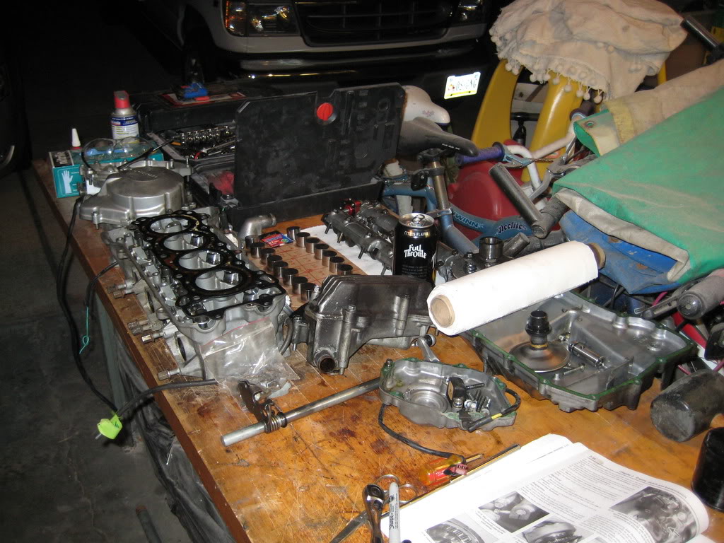

knifemaker87 Aug 2, 2010 08:55 AM
17 Attachment(s)
okay!
now that the current body work is done and ready for carbon fiber, i am going to rebuild the engine. that way i can mount it in the frame and do any welding necessary on the frame
(radiator and exhaust mounts at least) so that i can then paint the frame and engine.
Now, i will say this up front, i do not know what wear looks like, so if you see something that should be fixed or replaced PLEASE shout it out. i need you engine gurus to help me out here. thanks!
Here we go:

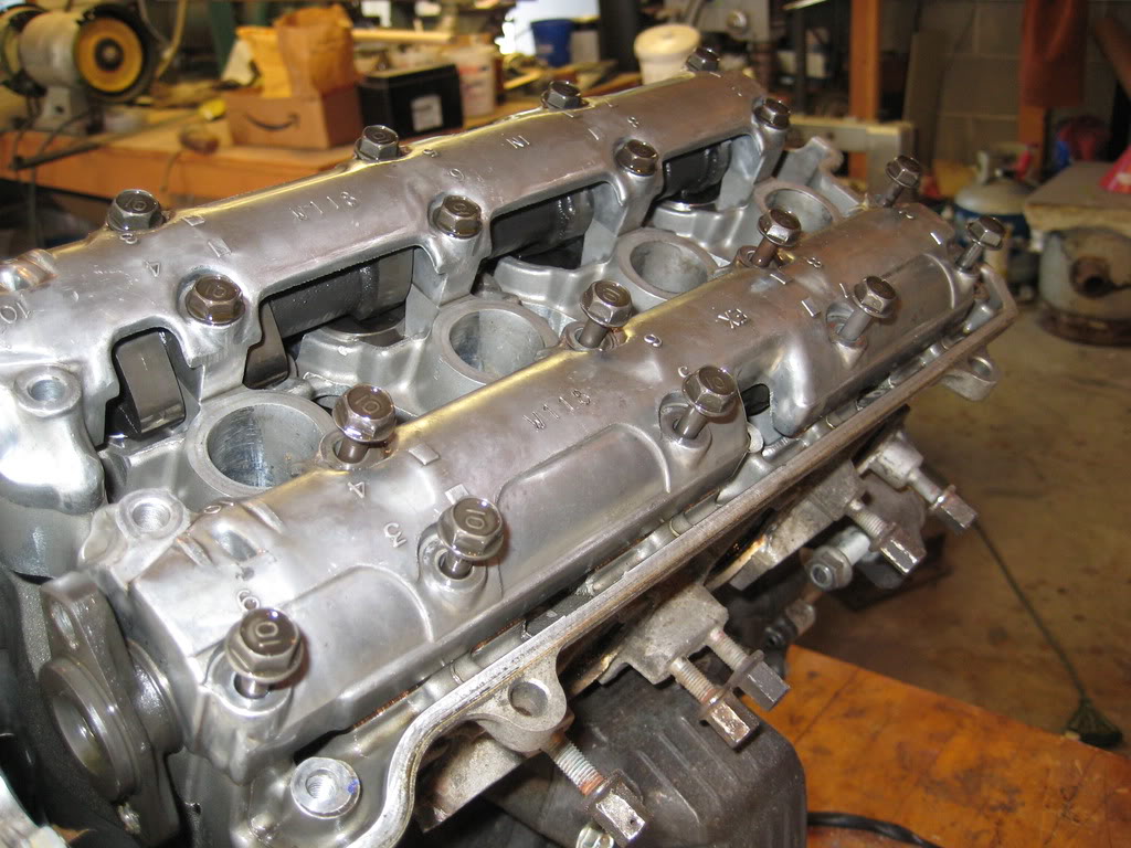

Valve cover removed, i didnt figure you needed a picture of the valve cover on....
Attachment 54362
Now, loosen the bold in reverse numerical order to allow the covers to de-compress evenly (dont worry... they are numbered)
Attachment 54363

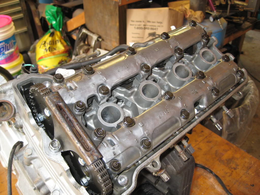

i guess i should post pics of the cams to check for abnormal wear or damage...

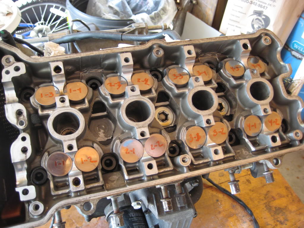

valve followers numbered for removal:
Attachment 54364

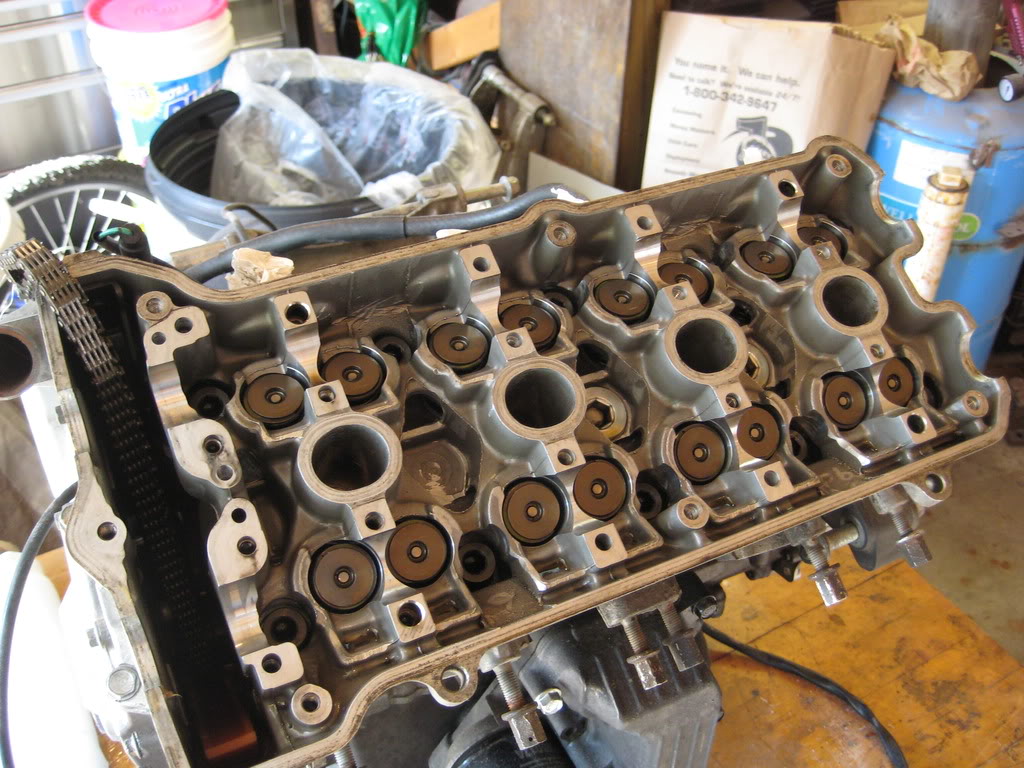

valve followers and shims removed
Attachment 54365

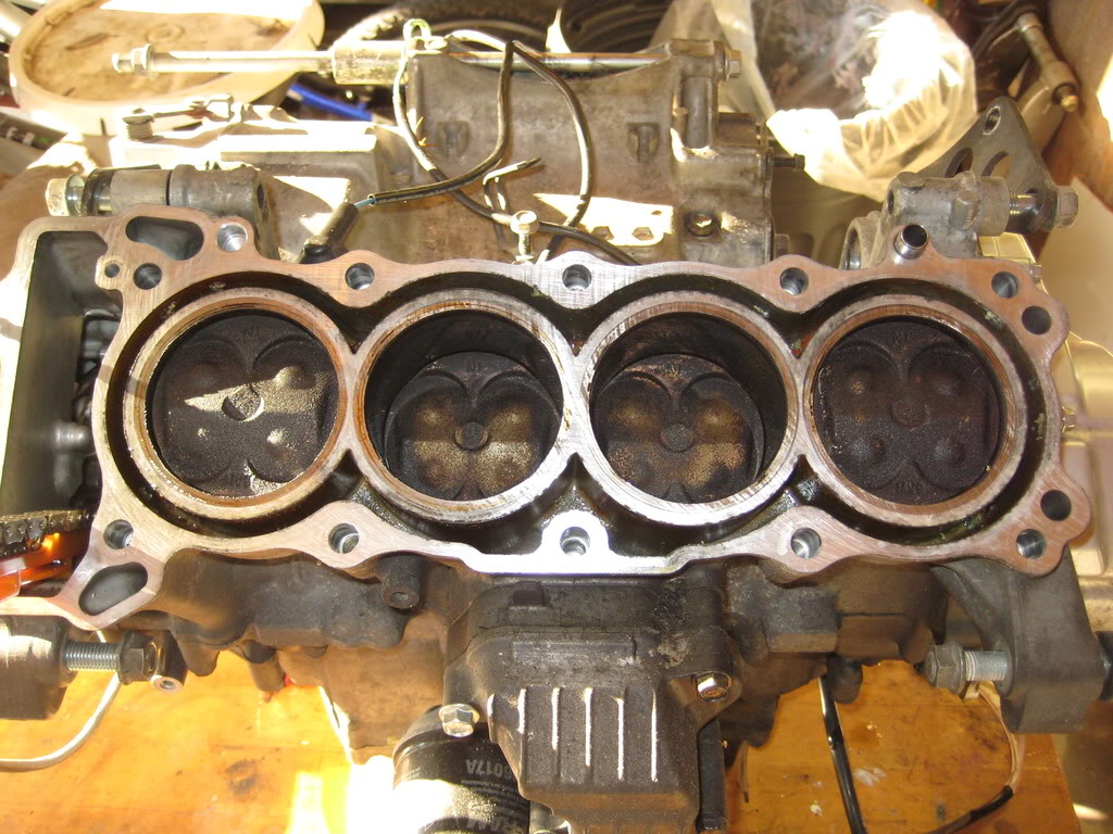

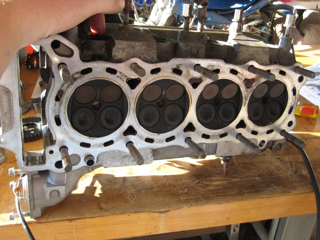

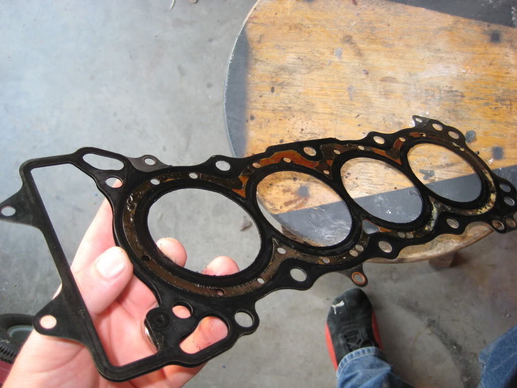

head removed: look at the water where the head gasket was...
Attachment 54366
Attachment 54367
Attachment 54368
Blown head gasket...now, the $5 million question is... is the head warped?
Attachment 54369

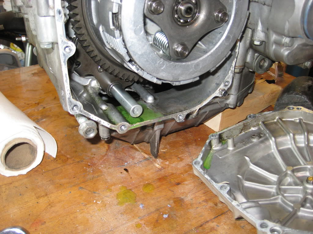

Clutch cover removed... and why is there coolant in here?
Attachment 54370

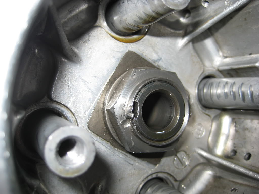

it would appear that someone has been here before me... (and the put on the washer that says "outside" on one side... the wrong way around...) FAIL! new nut ordered...
Attachment 54371

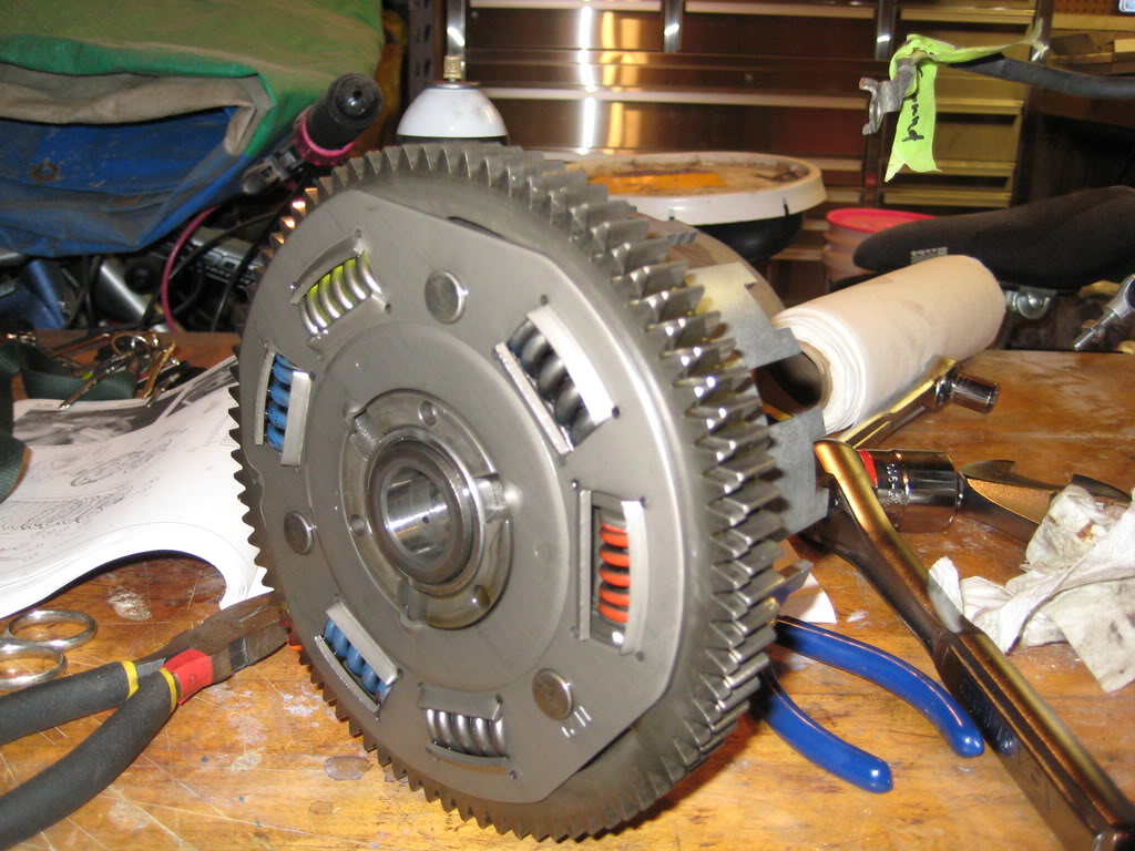

is this stock?! i know one of the POs used this as a race bike...

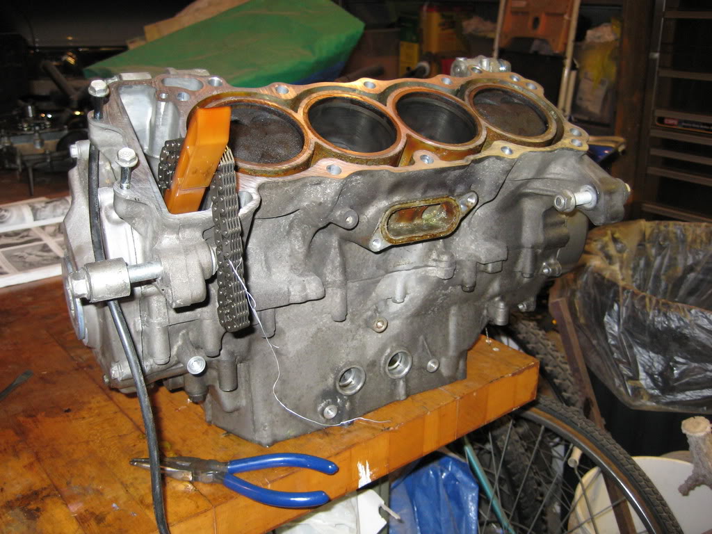

Attachment 54372
removing the oil pan... EW! at least it isnt milky right? could all this have leaked through the head gasket? this seems like alot of "leakage"
Attachment 54373
oil cooler...
Attachment 54374
oil cooler GONE!
Attachment 54375

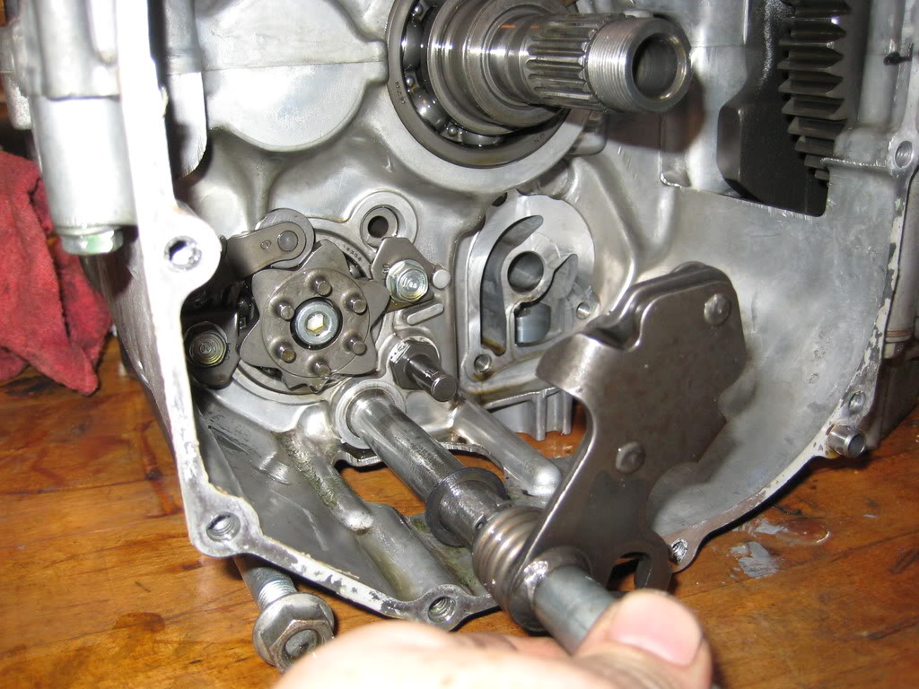

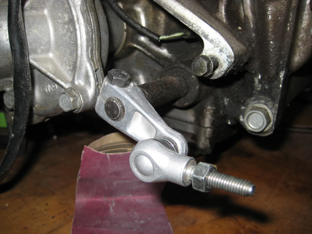

removing the gear shift mechanism
Attachment 54376
used a wire brush on the piston heads... cleaned up real nice!
http://i23.photobucket.com/albums/b3...7/IMG_1722.jpg
stator cover removed:
Attachment 54377
Pile of parts on the bench...
Attachment 54378
I am kinda stuck cause i need a "honda service too" to remove the magneto as well as a funky torx, so i have to find something that works, or find a tool. any info on that? after that comes off i will be able to split the cases and double check that there isnt a hole the coolant is leaking out of, then everything will get cleaned and re-assembled with new gaskets and seals... i am gonna do a valve job for sure, but not till i get everything else back on.
anything else i should do while i have it open?
thanks for looking!
~Chris

how much you want for a set of the rearset adapters? I'm just over 6' tall and would love to move mine back and down just a hair.

Damn dude, Way to jump into it!! Looks like you've made a lot of good progress on the engine. I'm still going with my original opinion on that oil cooler...Those O rings dry out, and all that rust in there didnt help lol.
