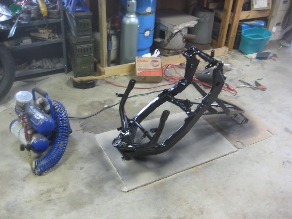

I got the frame home, and realized.. horror of horrors, there were some light areas of paint because of how it was hung. not really a big deal.. but worth touching up now rather than when it is rusting and the whole bike is assembled. plus. it wasn't perfect.
so..
Attachment 49469
welder still has to call me back...

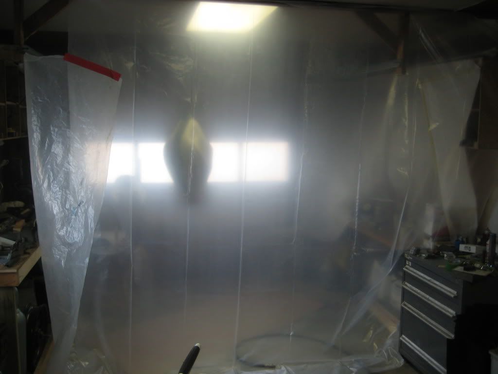

The paint room got filled, but i already have everything masked up, so instead of ripping all that off and waiting till wed to paint, i got some poly sheeting and rigged up my garage. I borrowed a air compressor from a local SVer (THANKS BEN!) and put a heater out in the garage to get it up to about 70.
then i put some hooks in the rafters, and got everything set up.

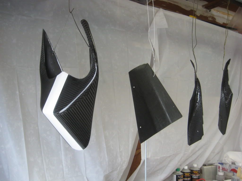

also i wanted to paint the bottom of the tank in black, but it worked out better to just do it all one color...but i did need to cover up the red.
Attachment 49463
there is something AWESOME about flat black and white. i kinda wish i could keep it that way.
but... the Carbon fiber resin is photoreactive, so i need a UV protectant clear-coat to keep it from yellowing, so gloss it is!
Attachment 49464

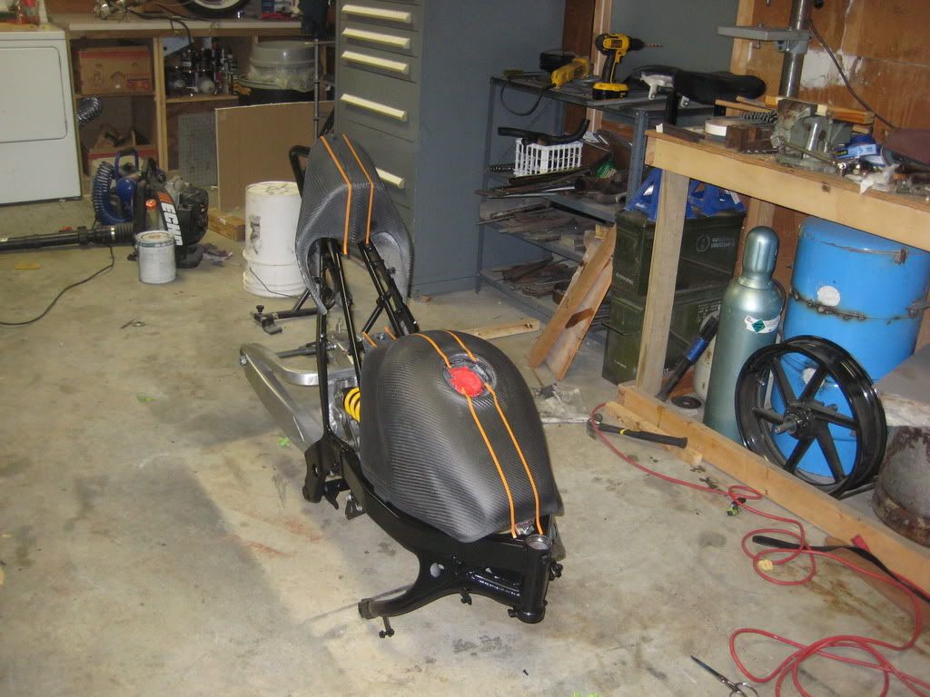

i also put the body-work on the frame just for fun. i ran out of daylight, but you still get the idea.
Attachment 49468

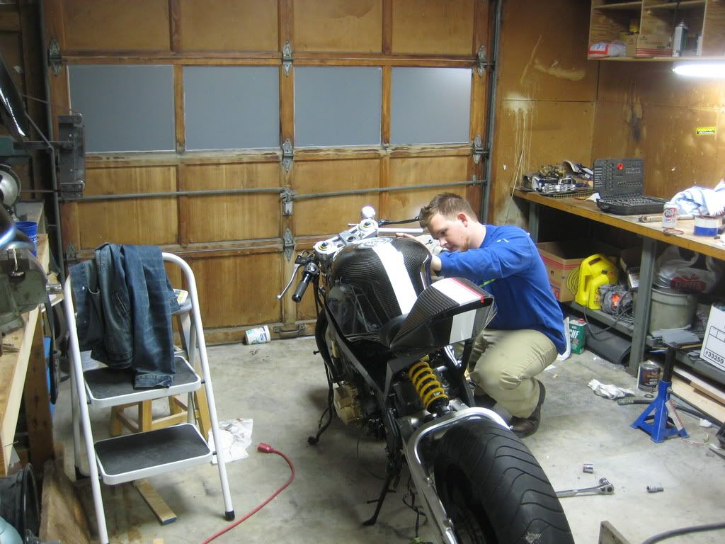

and here is where i started the assembly.
Attachment 49455
this way i could do all the assembly by myself.
Lowered the frame on, and slid the bolts through

are you painting with that little CH compressor - at least the touchup work?
How well does that work? I have a bigger 26gal CH compressor and am thinking about repainting my wheels with it. What brand/style of gun are you using?
