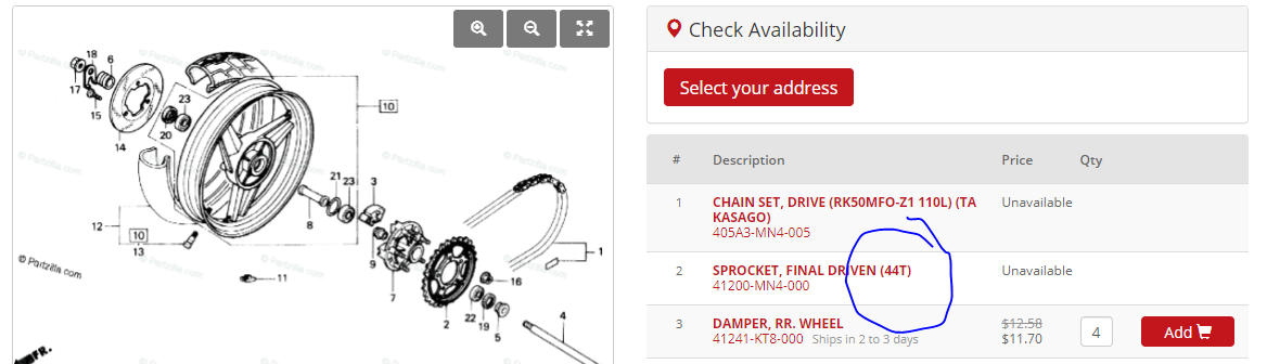

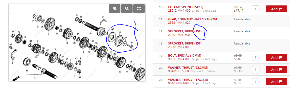

Thx "I Do Dirt." Went to the Partzilla sites you recommended. First one (rear) just has reference number to the exploded view but no tooth count. Second one (front) also shows a reference number but no tooth count. Rats.

@FredT The number of teeth are in the description. 15T and 44T.

Mea culpa, IDD!!! Talking Thx for clearing that up - 15/44 it is. Maybe the aftermarket M4 'amplifier' is so noisy I've modified my shifting. Was positive the gearing had been changed.
