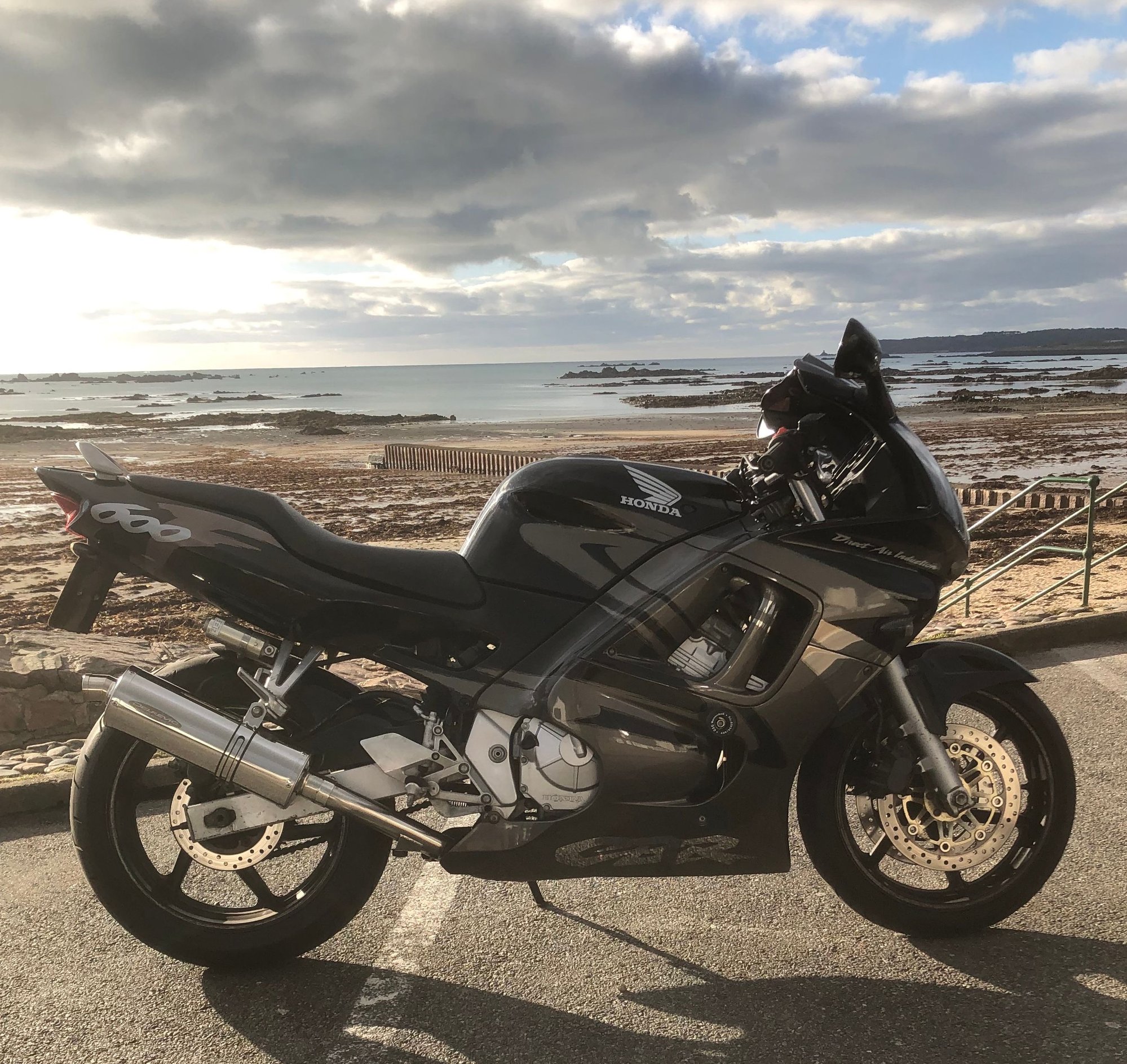

Help! I have just, after 25 years, bought another lovely CBR600. This one is a 1997 model, has recently, according to the seller, just been serviced but takes a while to get started. Usually takes about 8-10 pokes of the button before it fires properly. Once started & warmed up it starts at first touch of the button & runs perfectly with no misfires or stutters. It is a joy to ride after not having a sports bike for a quarter of a century, I have never in that time not had a bike & at one time 7 were in my garage Oops! I wondered if maybe the fuel was draining back or whether there is an electrical issue. All suggestions other than selling it would be welcome. Thanks fellow Hondaerists. Hedley (Clive)
