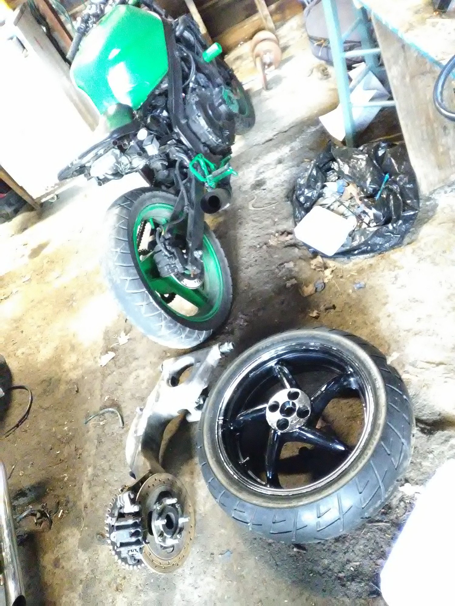

So I got an old 89 Cbr 600 hurricane and want a single sided swing arm
Is it possible? Who has done it
Only thing I'm really worried about is where the swing arm meets the frame, what other swing arm might fit in there?
And lining up the tire and drive chain
I see alot of Vfr swing arms for sale
Any specific one I should be looking for
Thanks in advance for any info
I'm also looking into other upgrades for this bike if there r any common ones

Hi, suppose it can be done , but your going to have to think about spacers , shock,rear wheel ,sprockets and machining, could be a big project, dont know anyone thats done it

This is a complicated conversion as I remember. The swing arm is wider than the frame at the pivot and needs to be machined down on both sides and spacers made to align the sprocket. The pivot bolt is a larger diameter. Shock mounting takes some fabrication and you need to find a correct length shock as neither the VFR or CBR shock will work with the proper height. While it looks cool it really isn’t worth the effort on an old Hurricane unless you are building a show bike.

The F2 is wider at the pivot. My memory says the single sided swing arm needs to be machined to fit the F1. The part he made is a sleeve to fit over the thru bolt because the swing arm bolt diameter is larger. The spacer also was machined to fit the swing arm seal. He changed the shock and pivot to F3. That may be different on the F1. I seem to remember it was later year.

Well thanks for the information guys. I hope I didn't buy the wrong swing arm. Mine is off an 91 VFR 750.
Getting this swing arm in the frame seems easy enough. I'll grind and sand off aluminum off each side evenly until it fits in the frame.
I will try to find a machinist to make a sleave so that the original bolt works in the VFR swing arm. I was considering just drilling out the frame so the new bolt fits in the frame but I want to keep the frame stock invade this Dosent work I can go back to original
The shock mount on top of the swingarm might be a bit tricky. I'll have to find a way to bolt a steel bracket to the swing arm.
But what I can't seem to fathom is the rear sprocket!!! IDK if I can use a stock VFR sprocket with the Cbr gearing. And it also seems to be about one inch to the left!! I'm not sure how to bring the sprocket tighter to the wheel to line up properly...

I think your problem is the 91 swing arm is not the right one for F1. I also wouldn’t recommend bolting shock mount to swing arm. The forces will tear it apart.
