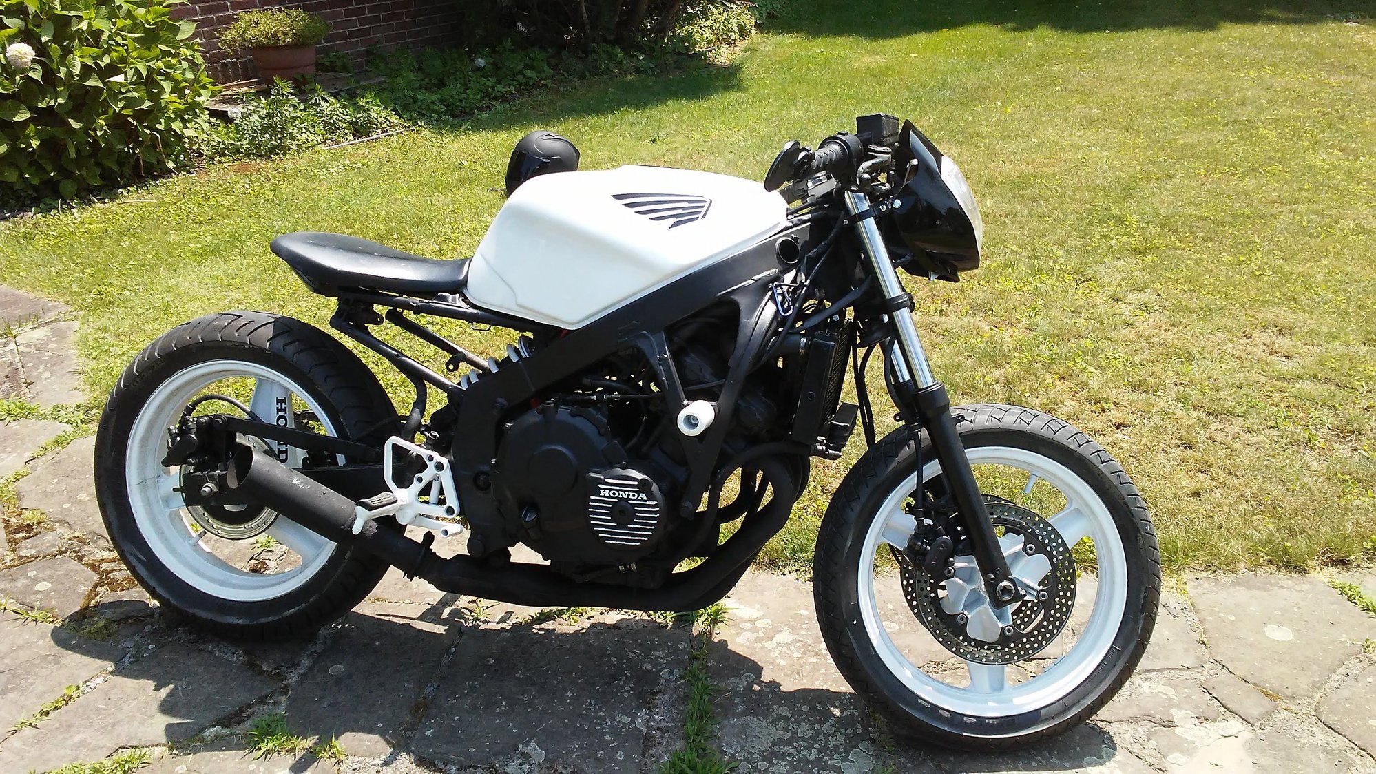

So I've been messing with thi 89 hurricane 600 since I bought it, and me and her have been through alot of issues together, some my fault, some her fault, and alot were the fault of her ex owner. (He didn't deserve her)
but here we r a few years in and still running strong with a couple residual issues.
Now this bike has been wrecked, chopped striped. And nothing has ever really gone right, I'm trying to change that. But keep in mind. I don't have a tachometer or speedometer. I do run a GPS app to check my speed.
I've done a TON of carb work, bought a second rack, replaced all broken and missing parts and stripped out ports that someone put a bolt in instead of I pilot screw
and painted it white
I have installed a factory pro carb kit, set of 3 mains to try and different needles. (I have the middle main jets in, I can check sizes when I'm home) These guys used this bike to win in the AMA so I'm taking their advice on anything.
also installed factory pro timing sprocket for advance
take it out on the highway and it seems to RIP. Runs great
chopped off exhaust screams through the window of every car I blow bye. 1-5 strong pull, goes great, hit 115-120 no issues, touching the rev limiter once and awhile.
AS SOON AS I HIT 6TH GEAR, complete loss of power, any any throttle position, it has nothing instant loss of speed.
pull the clutch rev her up, running great. Drop clutch, samething, no power
hit the choke, no change
ok, so I'm missing something gas, air or spark. Right?
take it home, thinking coil or wire under stress is failing
do acomplete stick coil over mod, start it up, must have done something right, running great
straight to the highway and same thing.
so I know it's not plugs,wires,coils or pick up sprocket.
so gas? I have removed the fuel pump, we've been riding dirty without a pump for a couple years now tho after burning through a couple cheap ones. So that shouldn't be it...mabye tho with bigger jets, faster consumption. Mabye
but...when I lose power in 6th, I cand drop back to 5th and run full throttle without skipping a beat, so the fuel has to be there!!!!
mabye air restrictions, someone did drill the airbox on the girl. Pull the air filter same thing. No change, so cant be air.
so...jets, my old arch enemy on all my bikes.
do I just need bigger or smaller jets, is that effecting my top end? But no, because my top end in every other gear is fine...runs great at full throttle in 5th
Sorry for the rant, I don't have anyone who understands this **** to talk to
but what do you guys think
try bigger jets this weekend? Order and Add a fuel pump just to test? I'm kinda at a loss
I'm gonna check carb boots next time I pull the carbs
there is also a kind of lag, or chop, in between no throttle and really getting on it, like it stuttttters for a single second.
is it at all possible my CDI?
or am i just asking too much of this bike.
