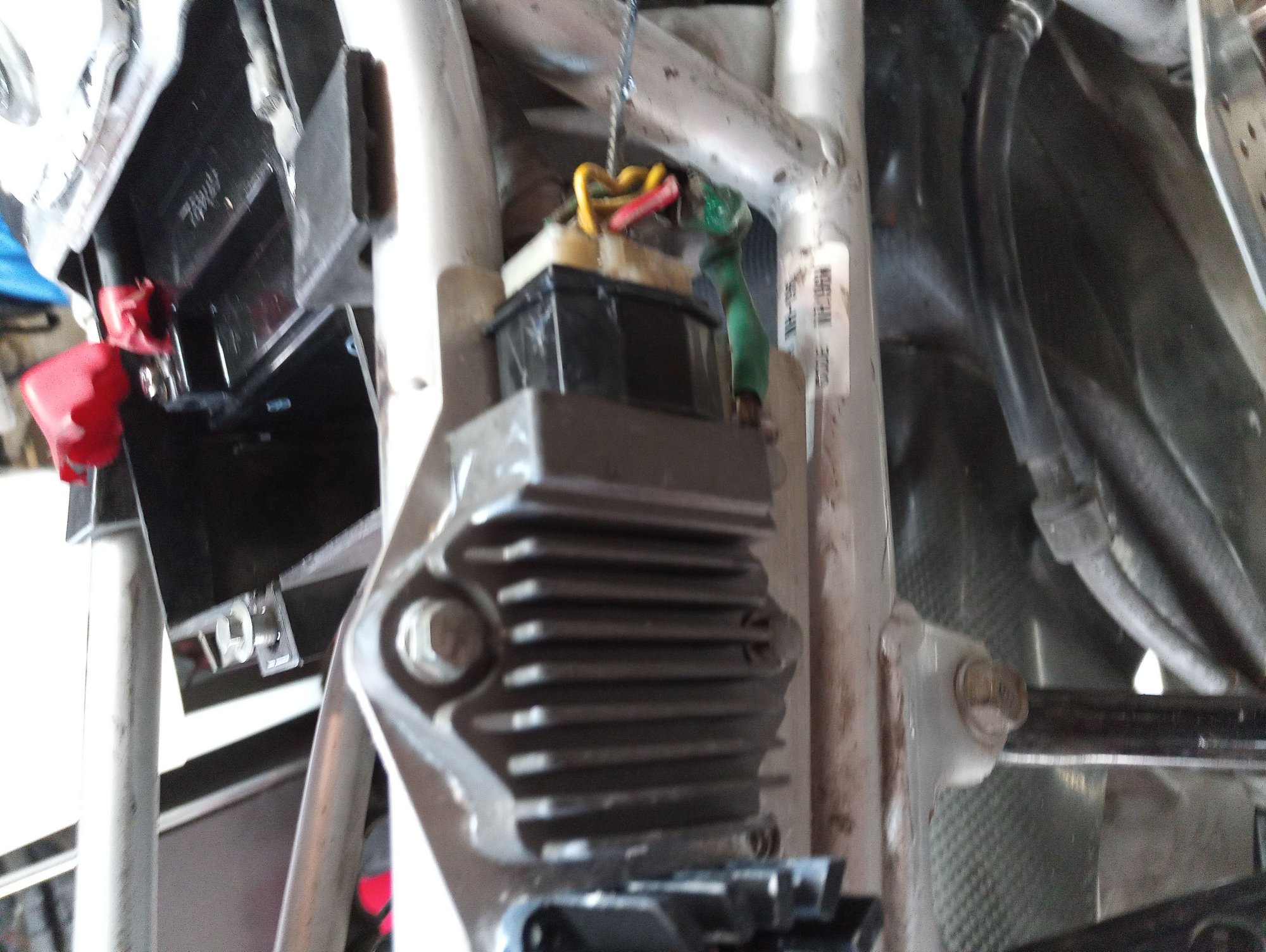

My bike was turning over slowly and it used to just spin and start, so I figure the battery is 3 years old and maybe a new one is in order, but I wanted to check the old one anyways. So off came the side pieces and the seat and the battery was 12.2, a tad low, so I started it and checked the voltage , 14.4, good right ? then my elbow touched the frame near the voltage regulator, wowzers was it hot like sweet snapping hot. I started to read and the Honda is a SCR system which do generate lots of heat. I read more and found that newer units use a Mosfet regulator which runs a lot cooler, so I have ordered a Mosfet regulator, which comes with a plug adapter and should fit. Once I get it and install I will do an evaluation and tell you

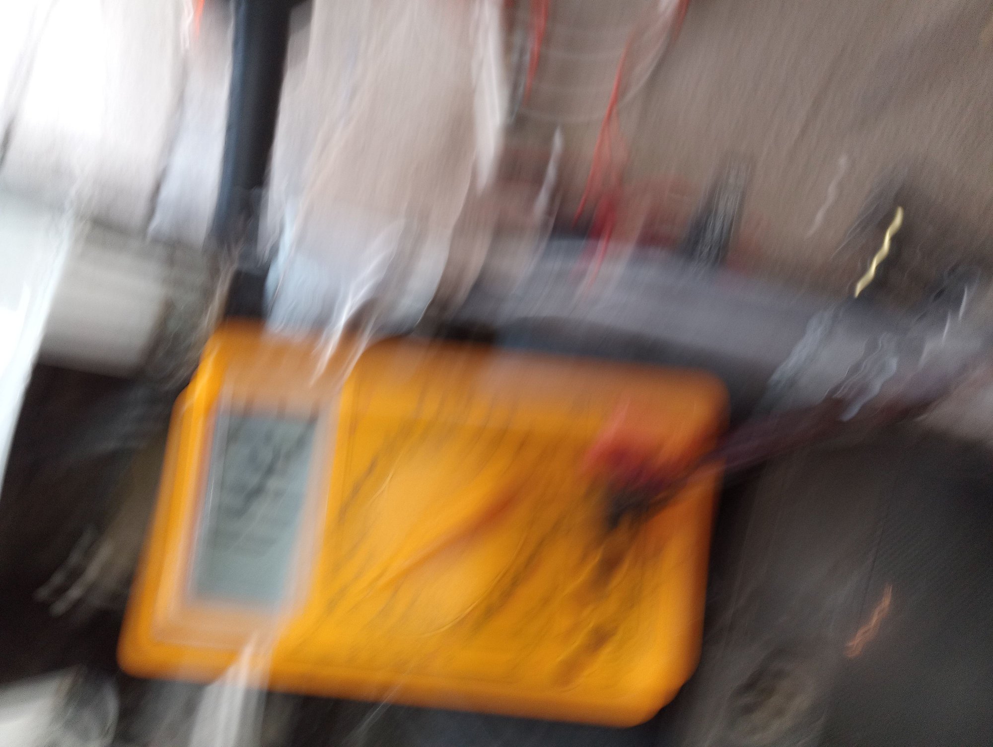

Default Battery regulator heatsink and yheal pastr
Originally Posted by Liam Kemsley
Battery at 11.82v with fan on and only 12.18 when at 5000rpm.
rectifier is too hot to touch.
How do I test the rectifier for issues?

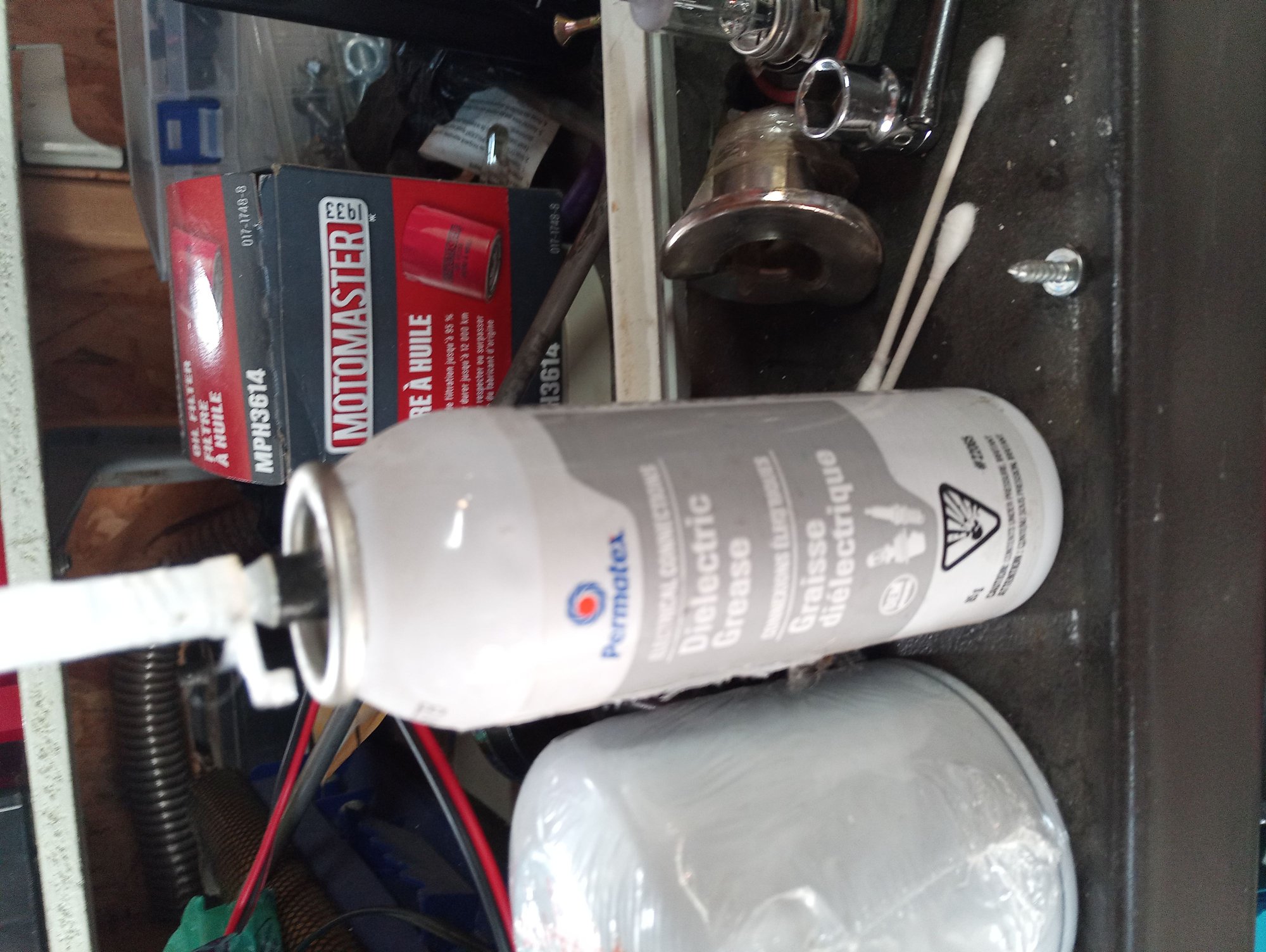

I bought a new regulator battery, heatsink and thermal paste. The battery was 12.3 the new 12.9 The regulator was blazing hot so I replaced it and added a heatsink. I used thermal paste and applied dialectic grease to the pins and contacts .the total for everything came out to $105
