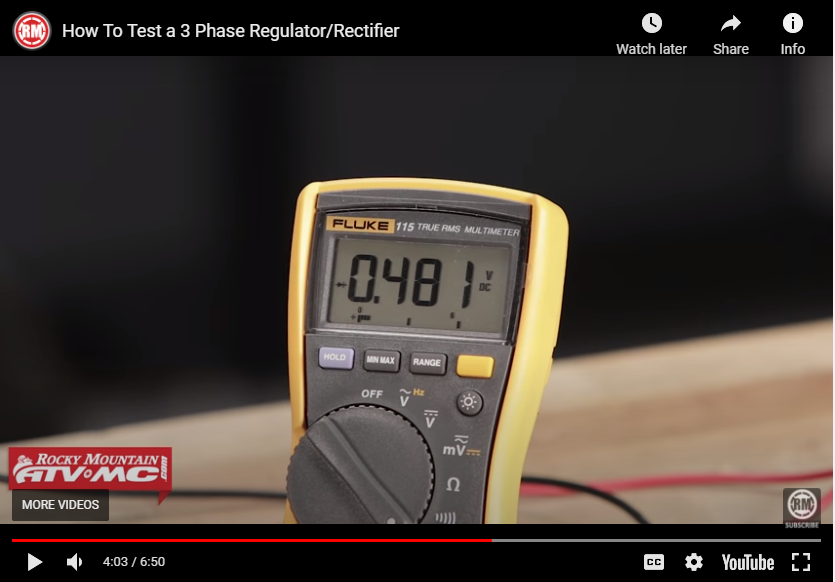

Can you provide link to video so I can better understand the checks you made? I wouldn't want you to do that either.
Old May 10, 2021 | 08:47 AM
  #25
In there he's saying it should be between .3 and .5. You're saying between 570 and 580. Notice his display says 0.481v DC. Can you verify your reading?

perhaps that’s the rating for his R/R? I think mine may be aftermarket tbh. Perhaps the reading is higher due to that? My reading was done about 5 times. I wanted to be absolutely sure
Forward bias.
Old May 10, 2021 | 09:53 AM
  #27
The point I'm making is can you verify the location of the "decimal point" in your reading? His reading is below 1 vdc. The number you wrote is 570. You did not write .570 or 0.570 and there is a difference. If you're not used to working with a meter, it's a small detail that might be easy to overlook. I'm not trying to give you a hard time, so don't get me wrong. The devil is in the details... lol.

0.580!
my apologies.
Old May 10, 2021 | 10:02 AM
  #29
LOL, no apology necessary. Just want to make sure we're on the same page. So that is outside of what he indicated.
