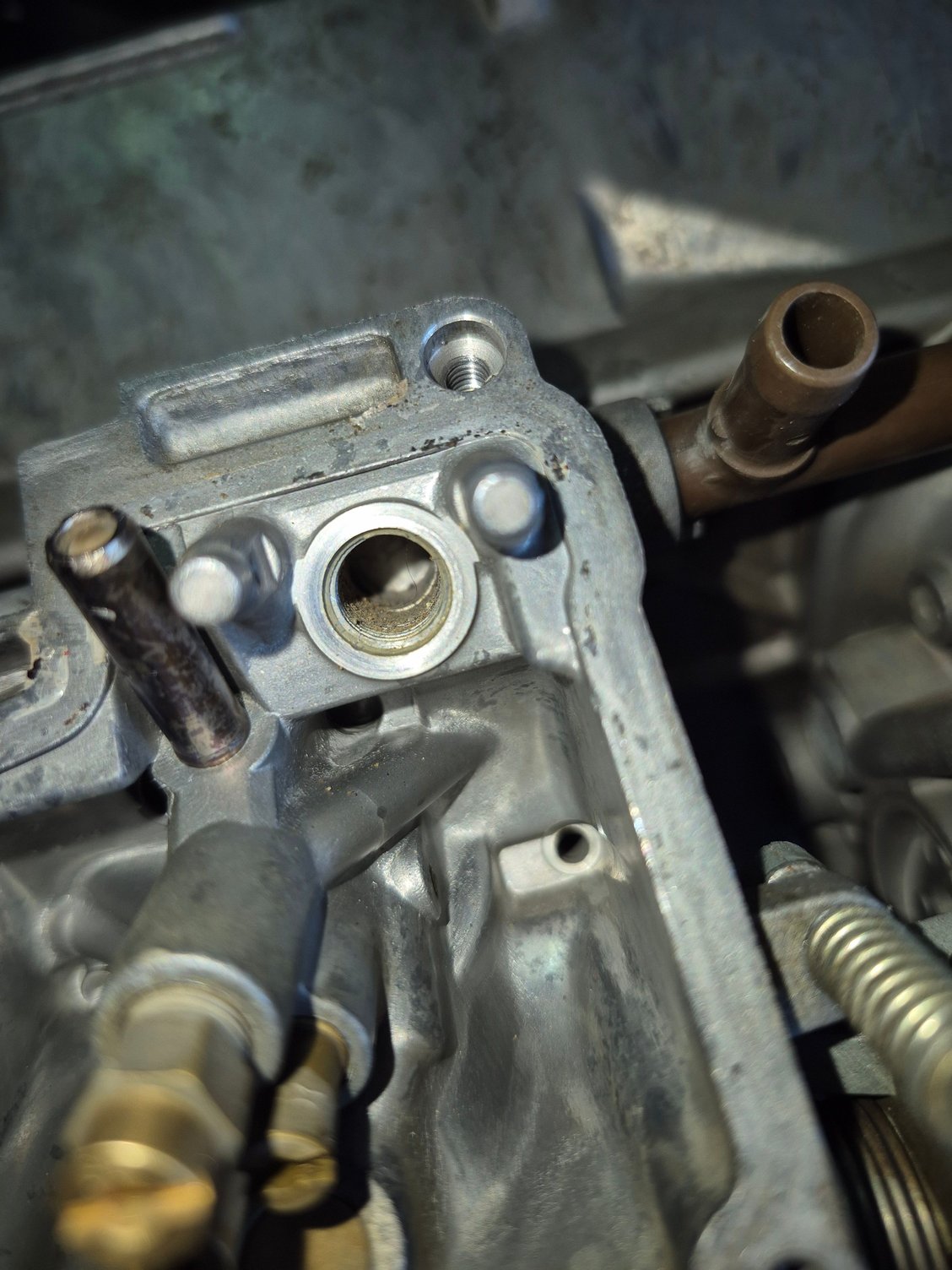

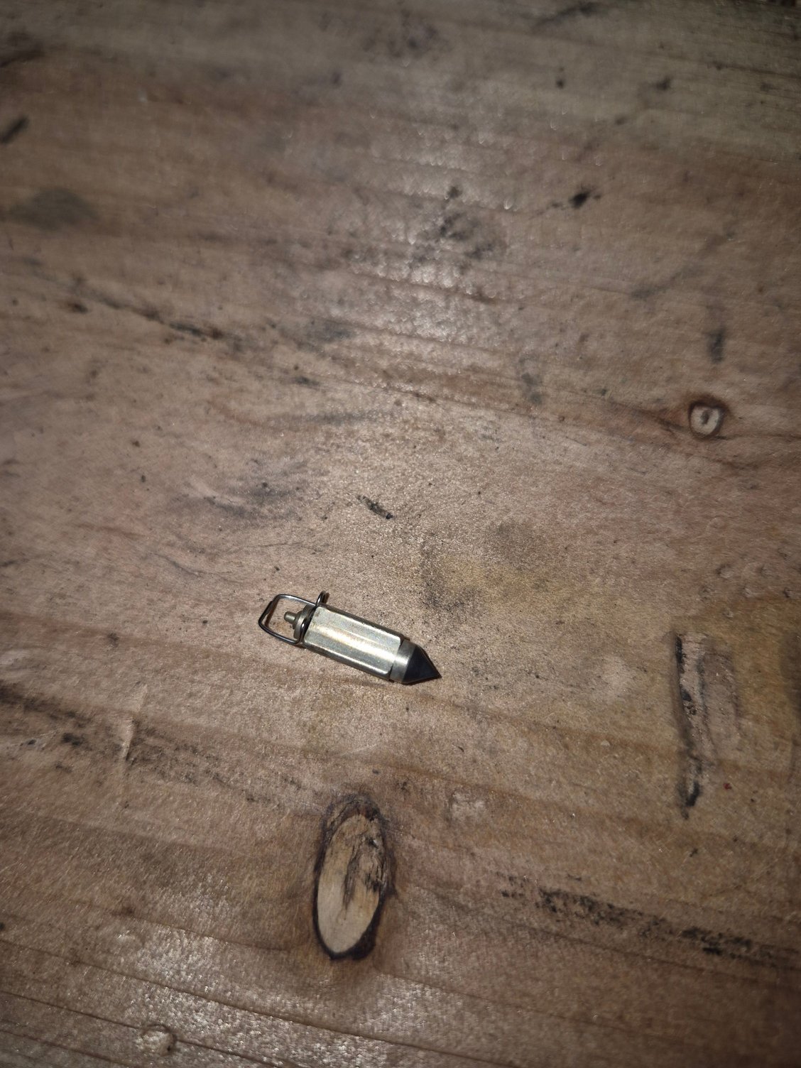

yes, they are set to 8mm by the manual, I started tearing the carbs apart again and noticed in the manual there are tiny filters behind the float needle, when I pulled the filter it wasn't clogged but around everything was dirt. Does this needle look worn?

It's hard to tell from a picture if it's worn. The best way to tell is to depress the little valve stem on the top. It should display resistance when you push it down. It should snap back smartly when released. If you have everything assembled and push the float all the way down, it should have some bounce in it if you release pressure quickly. If you compare these characteristics to the other needle valves, they should all be pretty much identical.

I left the carbs sit above the boots and I put a towel in each port to see which carb was leaking, the towel in 1 had alot of gas and 3 had a little, 2 and 4 were dry. The needles are good, the bounce back test revealed carb 1 has little to no bounce back, carb 2 has very good bounce back, and carb 3 and 4 have questionable bounce back.

If it were me, I'd just replace them all. You already have it taken apart, which is the lion's share of the job. The needles themselves are pretty inexpensive.
