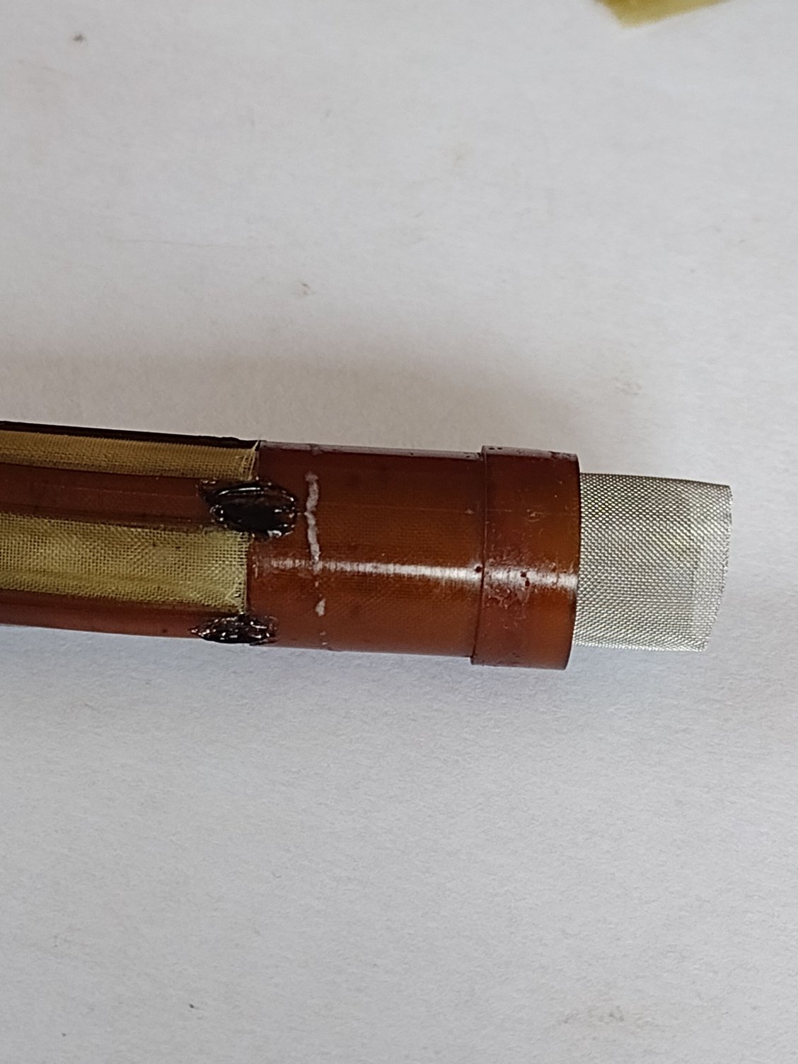

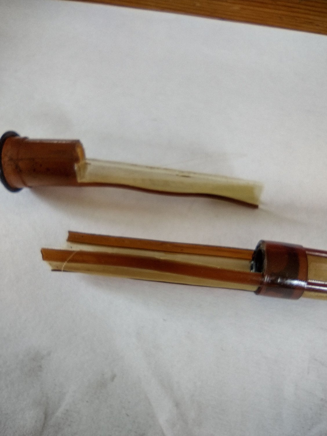

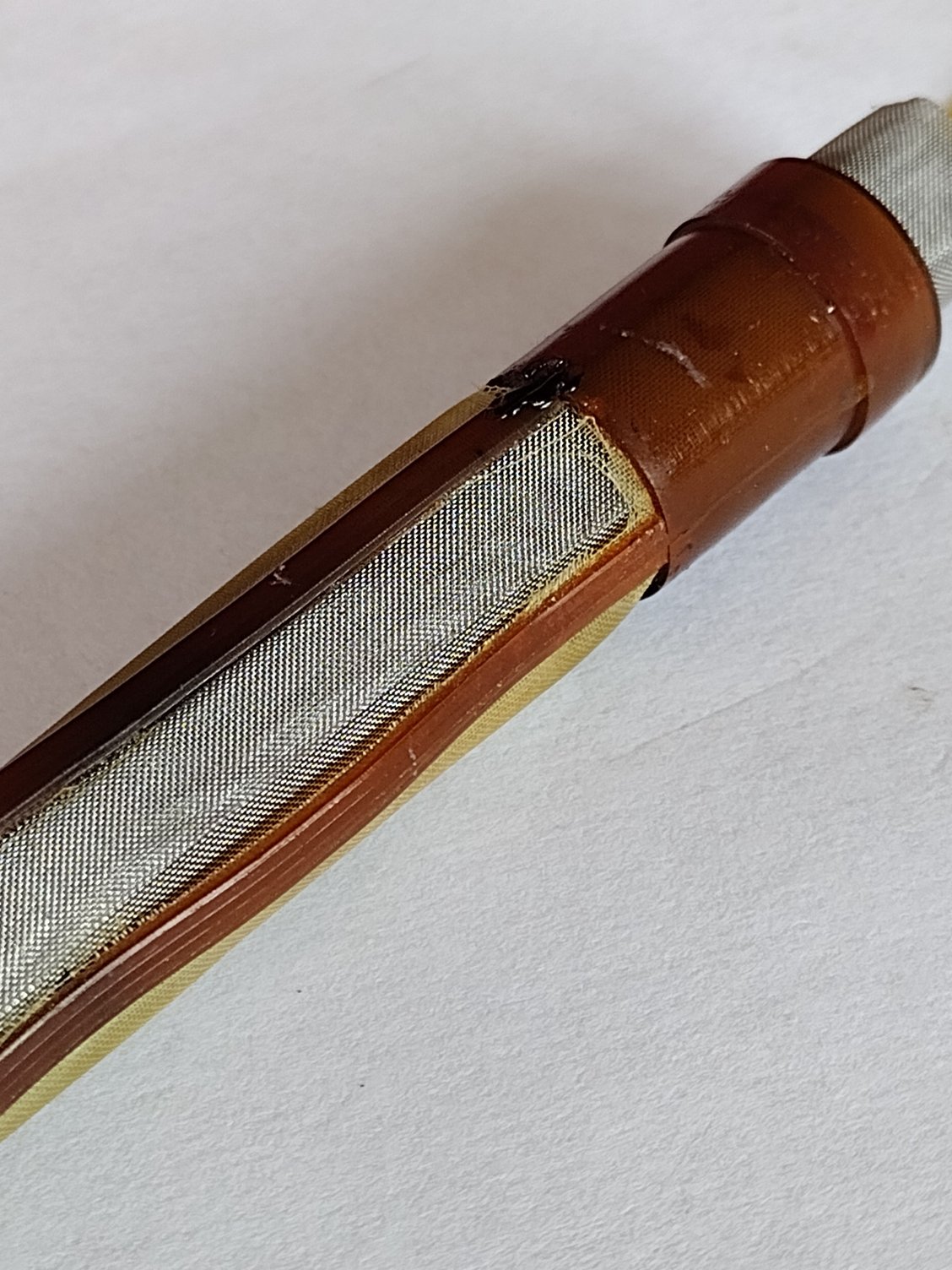

Default Found an original Honda Petcock for Fv 1997
My local Honda dealer apparently has a petcock with attached screen mesh filter for £120. Wemoto.com are advertising a Chinese one for £67:96 “fuel Tap (AG5207)”
I was lucky, my original petcock is fine, all I needed was the “screen mesh filter”, I put my time into rebuilding it, with the knowledge spending £120 was the final option.
found some stainless 120 mesh on Amazon, placed it inside the bits of the mesh and Welded the plastic parts back together. Seems to work fine but time will tell.

Default Photos of repair
Fingers crossed 🤞
Old Jul 18, 2022 | 06:14 AM
  #27
Posts: 2,571
Fantastic, great result and saving £115 in the process. What a result

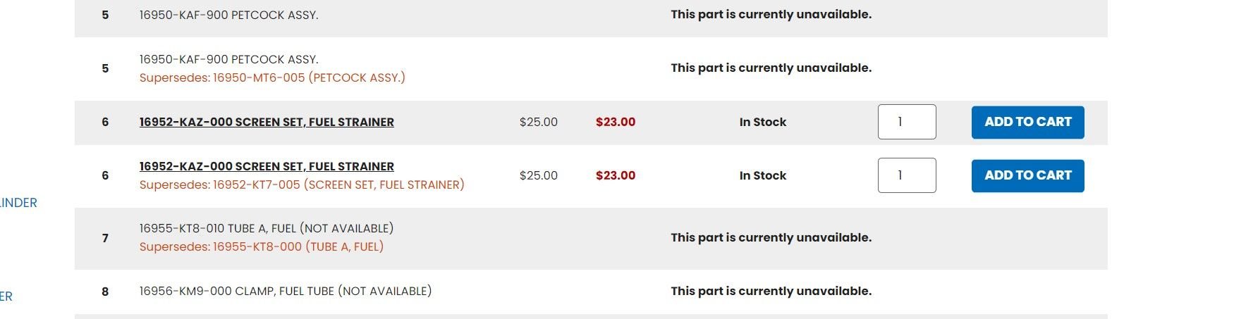

But, the screen mesh is available and not expensive. You don't have to buy a petcock to get the screen.
1987 Honda HURRICANE - CBR600F OEM Parts | MotoSport
Old Jul 18, 2022 | 10:19 AM
  #30
Posts: 2,571
Good find Mr Lee, came across this https://www.cmsnl.com/products/scree...i_16952kaz000/
Which will at lease avoid the shipping costs from the US if the repaired one fails
