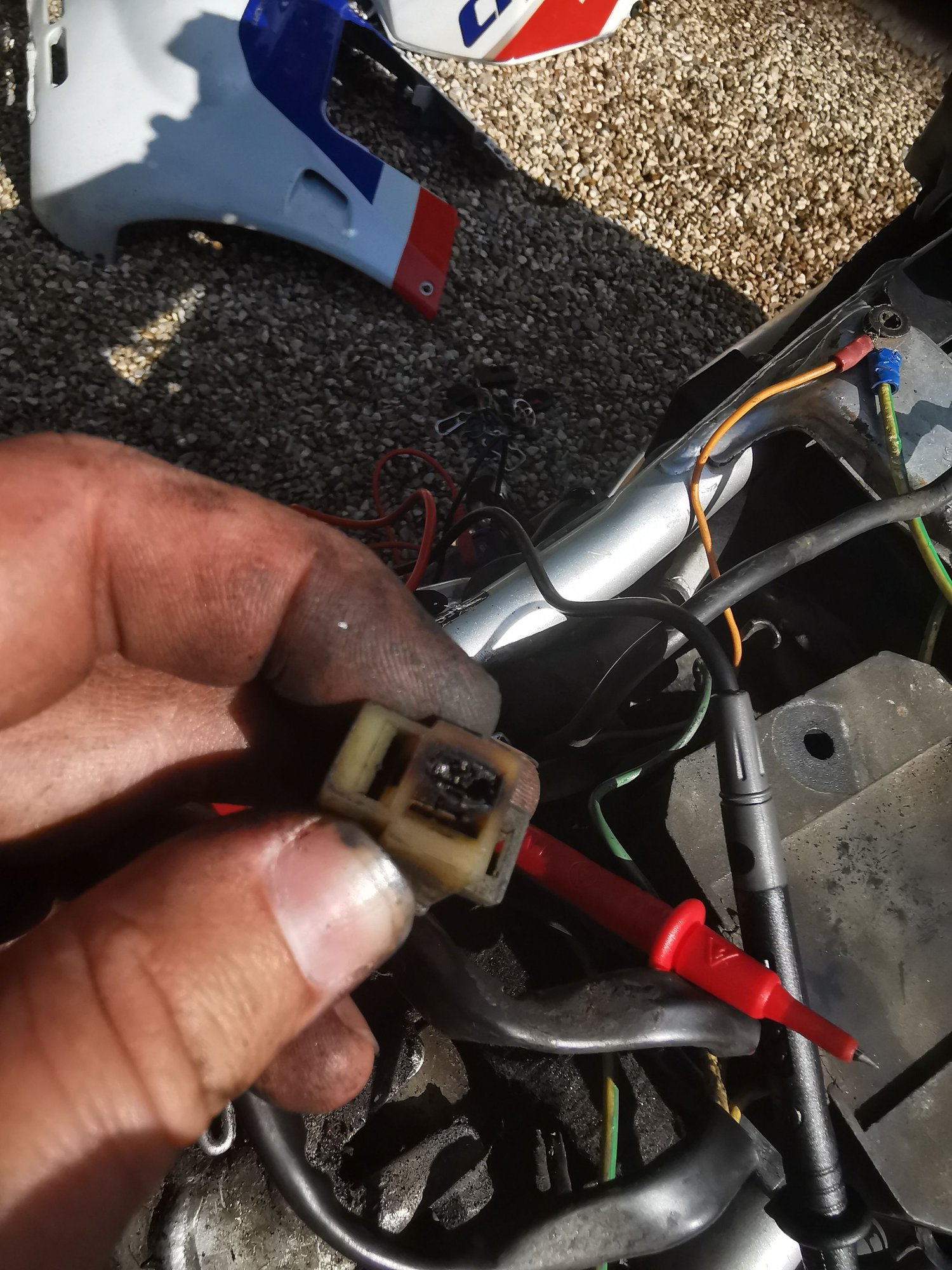

Default Maybe found the problem
This I believe is the stator connector, and that looks rather toasty to me 😅
Old Sep 14, 2022 | 11:27 AM
Posts: 2,569
It could certainly be something like that.... If that has three yellow wires going into it, then yes it is the stator plug.
It was pointing to an electrical issue when it was getting warm and shorting out
Whilst you have it apart checking all the connectors would not be a bad idea.
​​​​Yeah I'm checking everything, very annoying that to swap the stator I have to drain the oil as I just put fresh oil in it.
The one on my spares bike was in good nick so I'm fitting that and hoping for the best.
Old Sep 14, 2022 | 11:34 AM
Posts: 2,569
That's a shame, fingers crossed the 'other one' works.
The original might not be fried, you should check to see if there is a short to earth once the plug is repaired, you might just get lucky and a new plug will sort it.

Don't need to swap stator if coils aren't shorted and working.
Just cut off that connector and replace it.
Definitely crimp + solder on new terminals before inserting into connector.
Oxgard matching harness connector to clean it (or replace with new)
https://www.corsa-technic.com/catego...ategory_id=101
or even better, just join wire straight across with proper western-union splice.
Not something ive done before but I will give it a go next time I need to.
I swapped the stator and regrec and it seems to have solved the problem, atleast for now.
I think the one I took off was actually OK, one thing I did was clean the bit that spins round the stator as it was covered in thick grease
