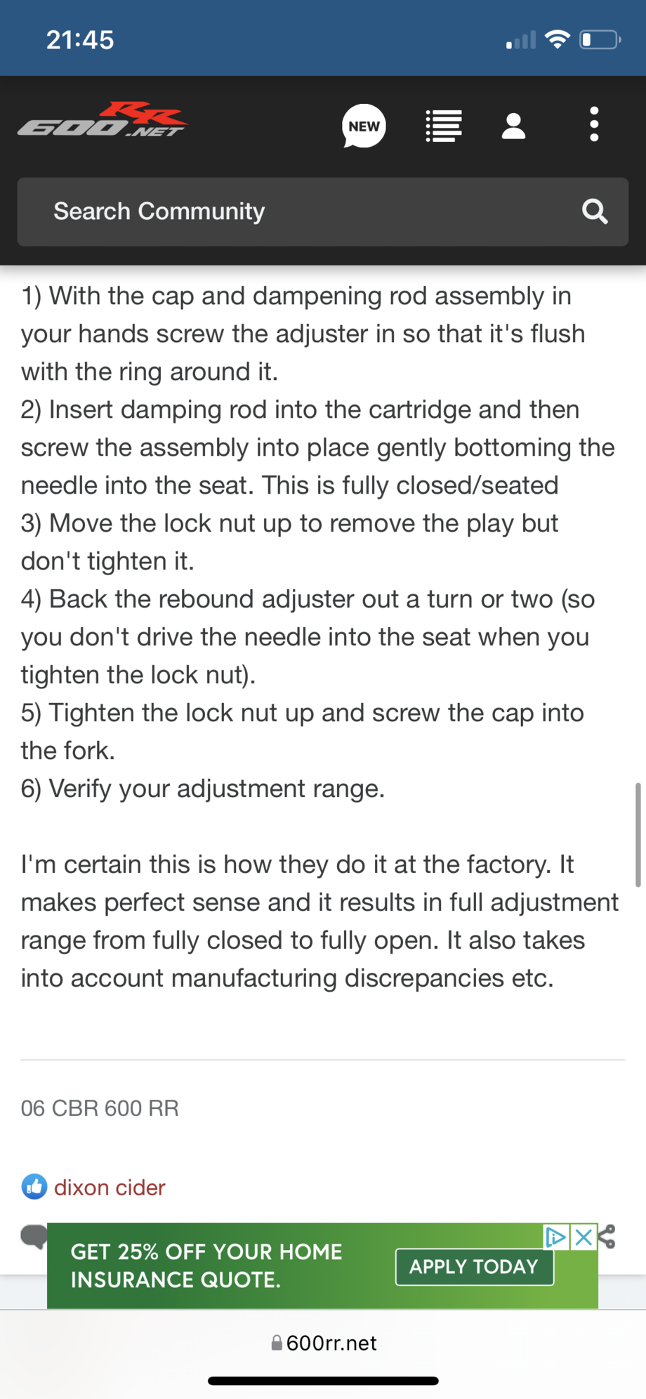

Attached below is a guide that I found on 600RR that goes a ways to fixing the issue. Hope it helps anyone.
My rebound adjuster screw issue was tied to a preload adjuster also being very stuck to the fork cap. This requires a disassembly of Fork cap from the tube, the Damper from cartridge (all adjusters backed out to full soft prior) and some tough love with a wrench in fork cap nut , and another on the preload bar sticking up through the cap. Careful not to put any pressure on the damper rod as you do this.
preload and rebound now adjustable with ease.
