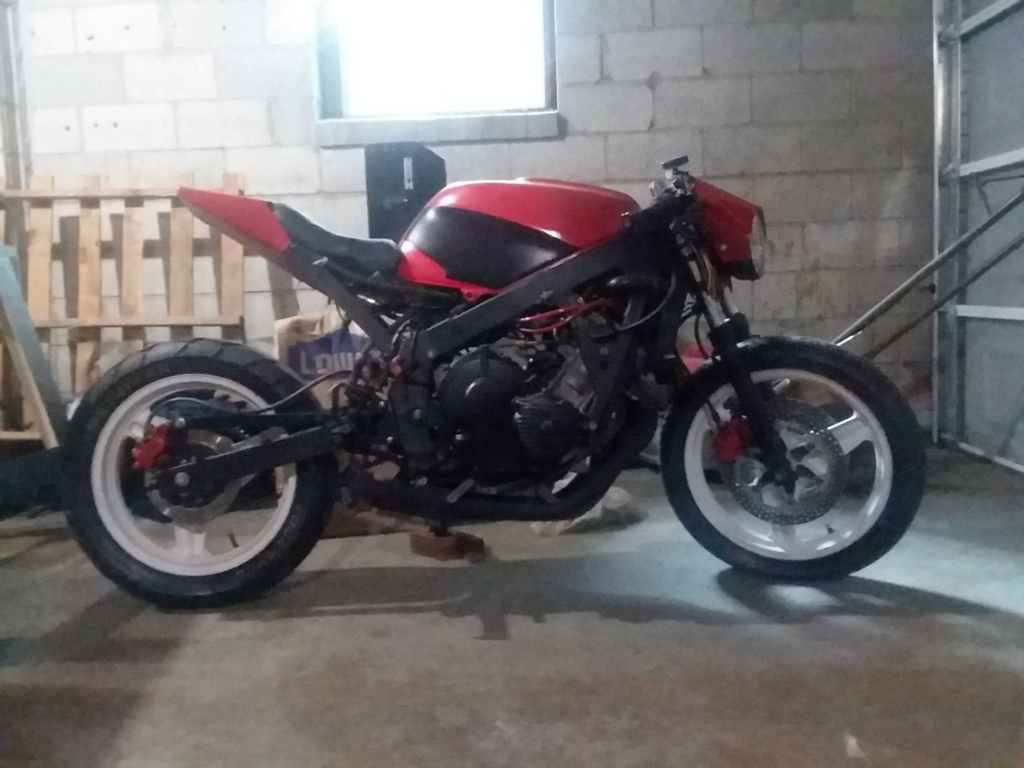

Thanks man i appreciate the reply. The brass air fuel adjustment screws on the outside are broken off flat so i would have to buy a new set or drill out the screw which is tricky as hell. So its been running ok could be better. Last time i had them apart i bench synced them and it was enough for it to run properly enough. Im most likely gonna just end up selling the old girl soon. I need something newer and more reliable. I may end up throwing a set of renthals on her and learning how to stunt with it.
this is what it looks like

Nice fighter. When I was converting my F1 into an RR It was a pretty cool fighter. I’ve considered putting one together with higher bars to make it more comfortable to ride.
by https://www.flickr.com/photos/22794316@N03/, on Flickr
