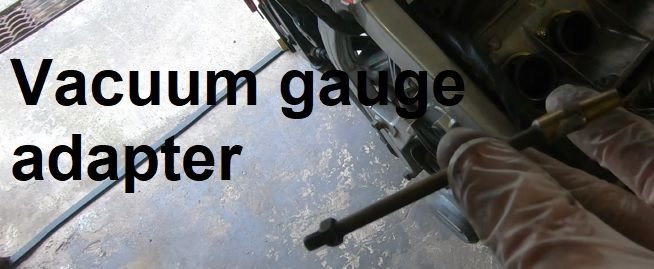

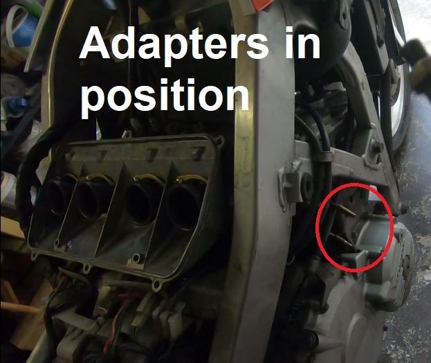

2. The vacuum gauge takeoff points are on the underside of the manifolds at about a 45° angle and are small hex headed screws.
3. You will need a set of screw in vacuum gauge adapters. (see pic)
4. Once screwed into place, the adapters exit the side of the bike at a downwards angle on each side. (see pics)
5. Connect the gauges run the engine, check the balance.

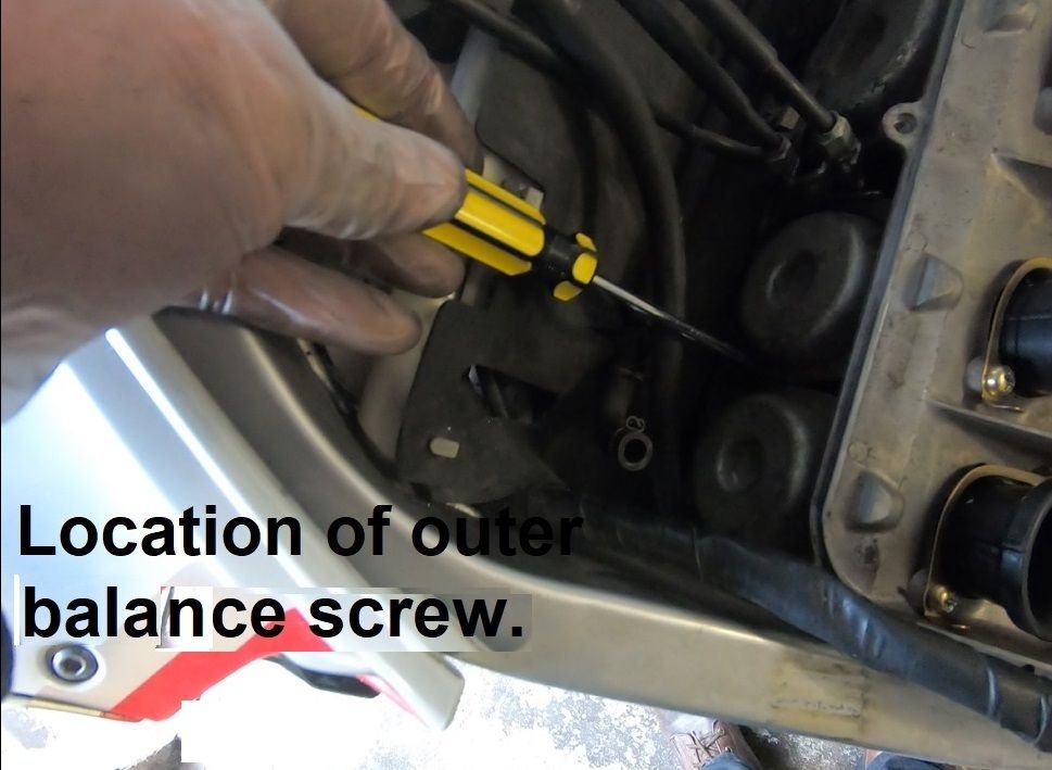

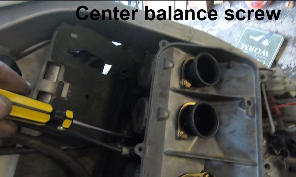

6. If you find you need to make adjustments, you then need to remove the tank and airbox to access the balance screws which are "in front" of the carbs. Ours are painted yellow for easy ID from above. (See pics)
I recommend using a torch to locate them as they're a way down. They are a cross head screw. They should be very easy to turn. Test this. If they're not, then you'll need to loosen them up first because any pressure on them actions the throttle and renders the whole exercise useless.
6. All the rest you know, balance each outer pair against each other using the outer screws then balance the balanced pairs using the center screw, finally reset the tickover to around 1000rpm.
