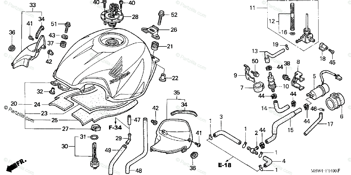

If you look in this diagram Hose #14 comes from the fuel filter #10 and goes to the Fuel Pump item #5. Then hose #15 goes to the carburetors. Either connect hose #14 and #15 directly together (temporarily as a test to see if it will keep running. This is not intended to be permanent) or see if you can connect hose #15 to where hose #14 connects at the fuel filter #10. Once it's connected, see if you can start the bike and have it keep running for more than a couple minutes.
There is a procedure in the manual for performing a flow test of the fuel pump. Need the manual for that description.

Cheers thanks for the detailed description and diagram. I will give this ago a soon as the rain lets me haha
