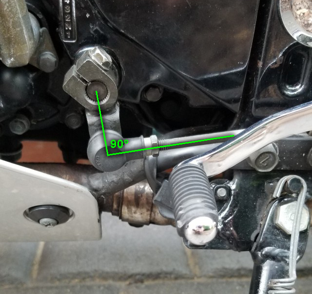

Try rotating shifter arm one spline clockwise so it’s 90-degrees to rod (will have to shorten rod afterwards).
Could also be some sort of spring issue?
Attached Thumbnails 1st gear not returning to correct position-shifterrodangle.png

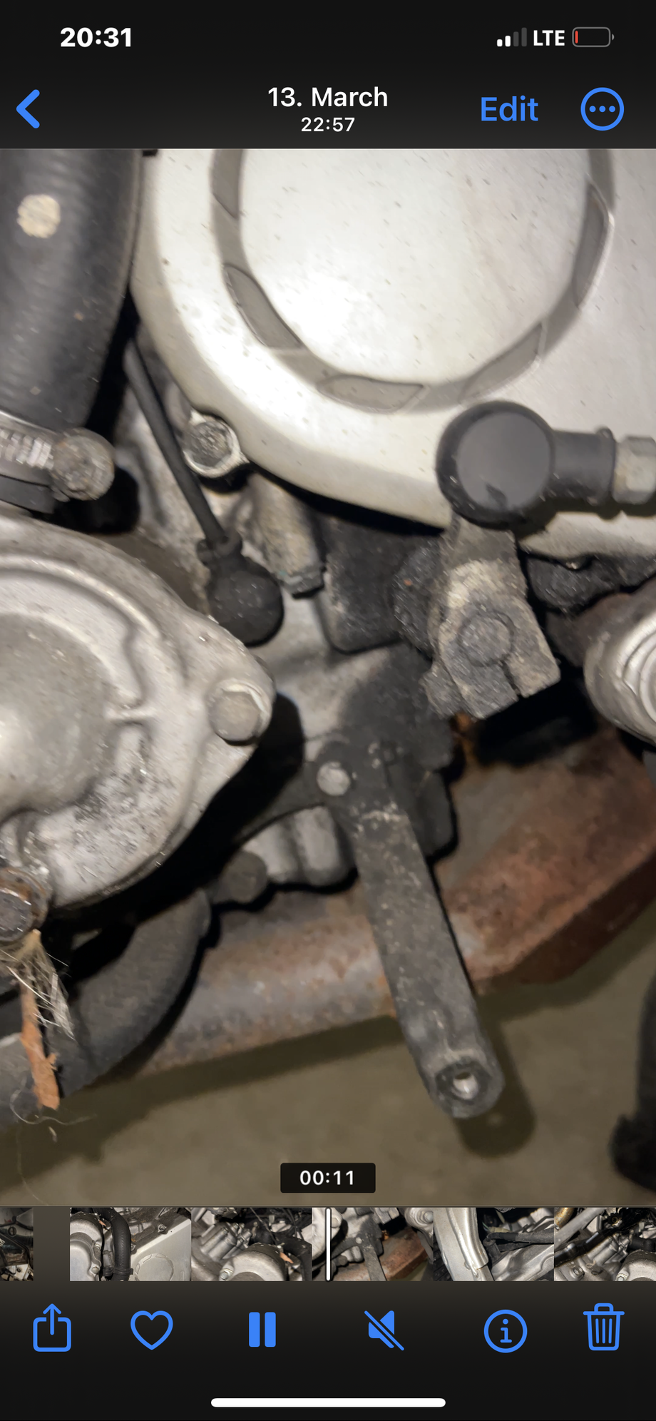

Hey thanks for you info , so I just took it for a ride and every gear downshifting you have to tap down then put your foot unemder the shifter click up slightly removing the slack then foot back on top shift down etc etc , going up no prob going down , nightmare , if a car pulls out the down shift is a real issue, so when I put the gear shifter on it was inline with the footpedals so super high so I then lowered it to correct position ( although) I thought it was ? Ok I will try this

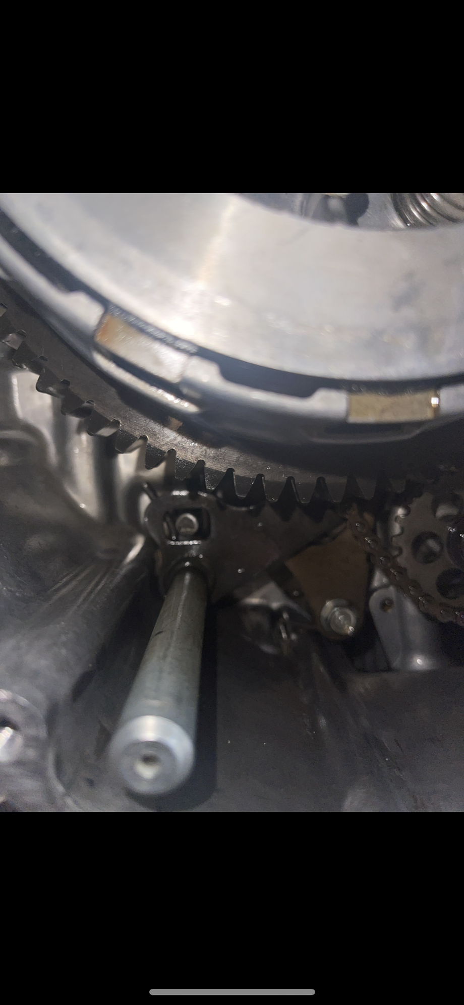

So
I screenshotted from a video I took when I first got the bike and this was the position I placed it back there and still the same I think I need to drain her out and get back inside the linkage and look however when I was checking the springs and they looked fine
I place the spring back over the pin because it popped out

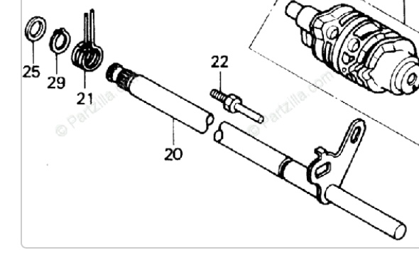

Spring’s arm looks bent. Both should be parallel and close together to contact that little tab on back side of plate coming off shift-spindle.

I’m had to read that a few times , the spring arm is the brown piece ? And should be where and how you mean parallel ? Sorry
Old Apr 14, 2024 | 04:26 PM
Bill1987600f's Avatar
Joined: Mar 2024
Posts: 193
Likes: 35
Do you mean the small pin in between the sorimg needs to come threw more?
